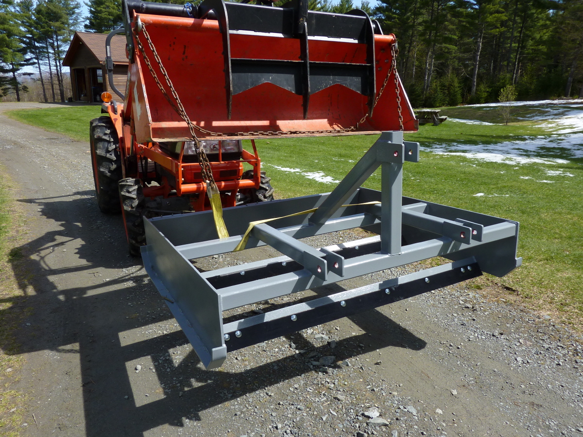

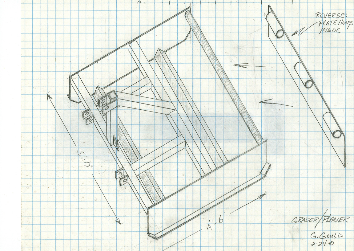

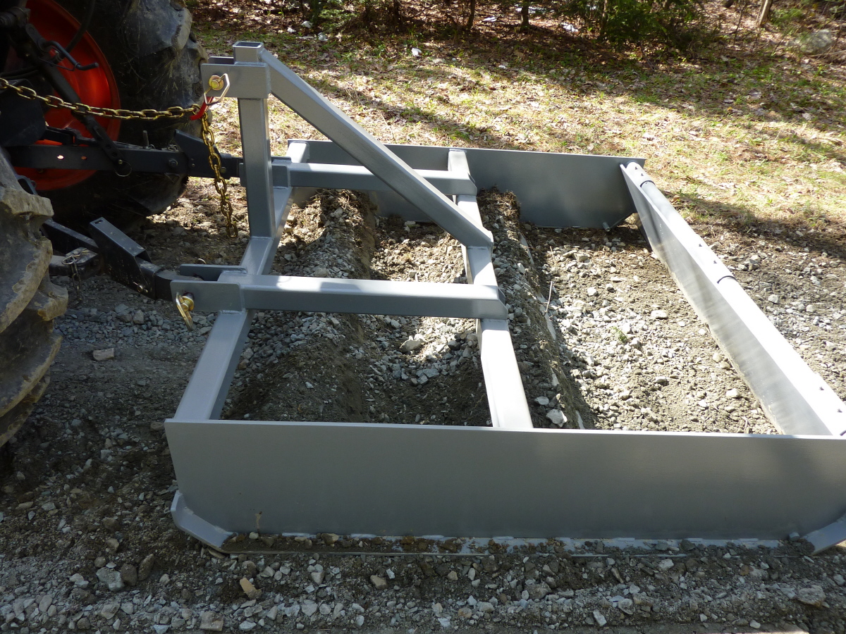

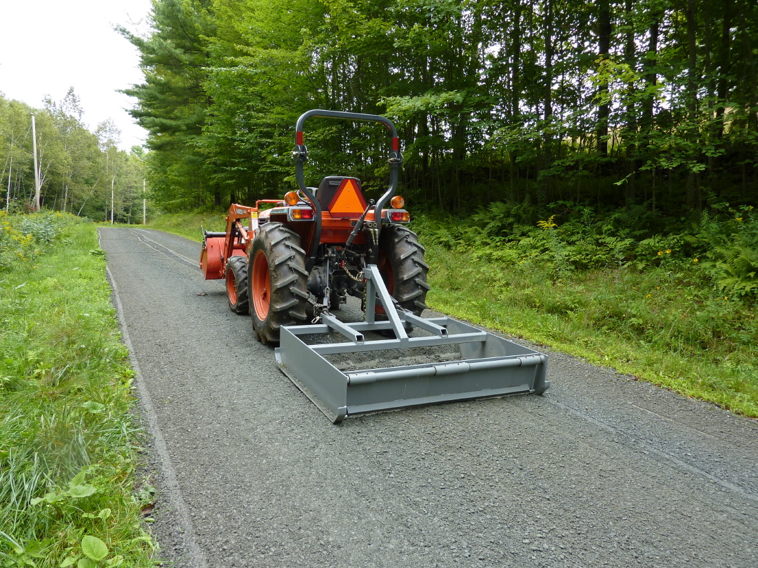

I built one. Used lots of ideas I found here. My blades are down 3/4". Good, bad, I don't know. It works is all I know. There are lots of opinions. I kept mine simple for lack of fabrication tools. The best advice I can give is make it heavy and make the space between the blades as big a practible for you. Do the search and read all the pros and cons.

Golden Gould, nice job. I see your blades go straight across instead of at an angle, I wonder if that makes a difference.
   / Need some ideas on building a land grader #6
Me too :)
From what I've read people say they build a crown with the slanted blades. I use a rear blade to shape my road with crowns and pitches. Usually once a year or less. My grader does not alter the basic road contour that I set with the blade.
If I was going to do one thing different with mine it would be to make the blade depth adjustable. I wore 1/4" off my blades last year. With a rear blade you don't notice this but with the grader everything is relative to the skids. My blades are only 3/8" thick. I am going to get some 1/2" ones for it.

This is the kind of results I get.

Thats a great looking blade Gordon. I like the tailgate on your blade. THat was handy on the contractor blad e I used before.

I have a couple stop pins that the tailgate works against. If I swing the tailgate up and over so it hangs inside it traps material like a box blade. If I swing it to hang on the outside it swings free going forward but if I back against a pile it acts as a blade and I can push stuff off the road. I find it handy.
Is that your driveway? Nitpack (aka hardpack) Gravel, I assume? That's what I used for my driveway. I am impressed by how clean and straight the edges are, more than the flatness of the grade. You must've got the wife out there swinging a shovel to clean up those edges so nice.
