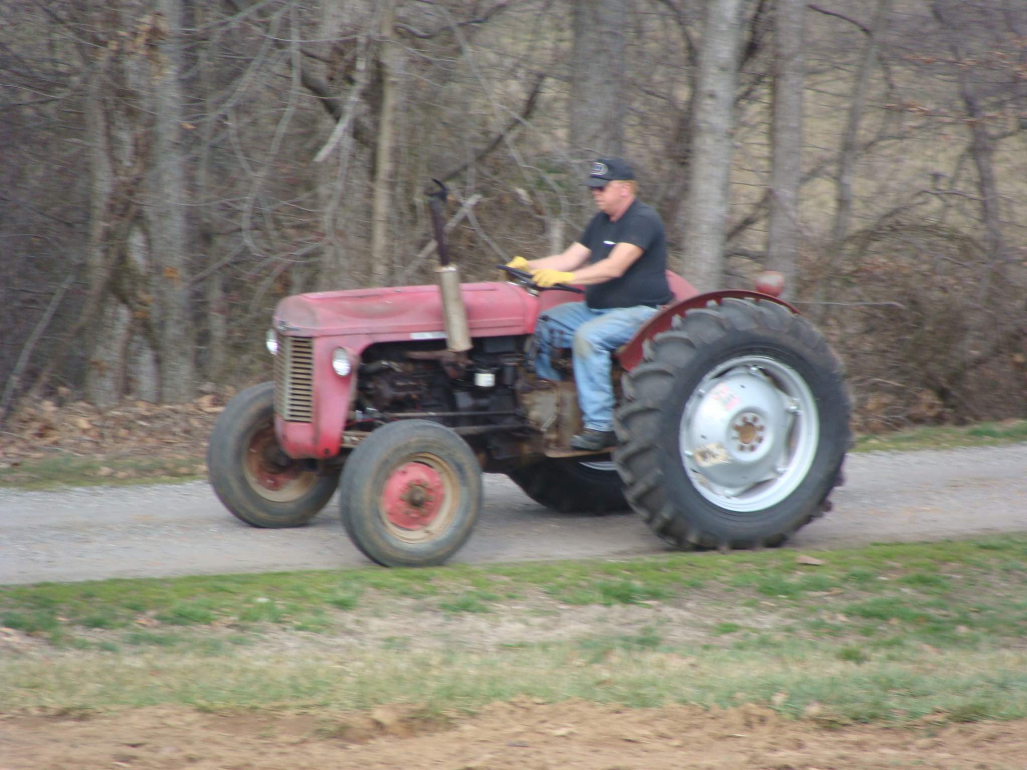

My son in law and I do have plans to start restoring the 35 this summer, now that I have another tractor to fill in for the 35 on the PTO generator in case of power failure in the chicken houses. Have to take care of my bread and butter first. When I was replacing the cables on the 35 I did look over the wires all in bad shape and your right replacing the wires shouldn't be that bad being there really isn't that many. But I also have a few fuel leaks to repair. The sheet metal with the exception of the right fender is in good shape so not much body work. I have tried to remove the steering wheel but that is locked in solid. I have been soaking it with PB blaster to free it up. I want to take a clear look at the wires in the dash and work on the gauges. I have attached a picture of the old girl.
