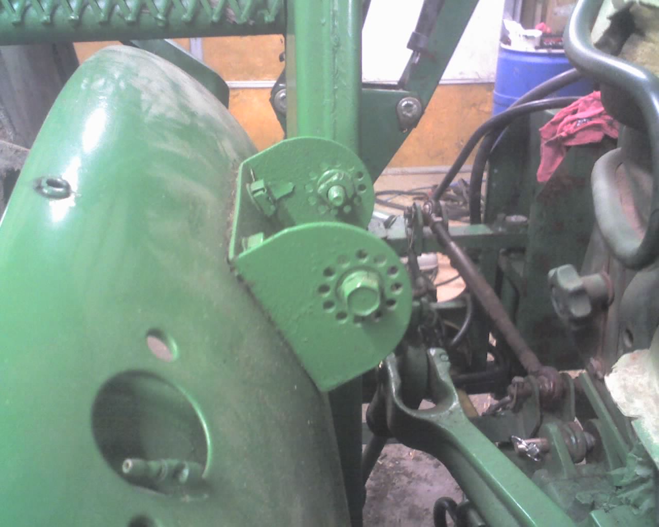

Picked up the mounting for the controls today. I went by the farm and test fit it after work. It will need a little modification tp work properly. It was made with four mounting fingers instead of three as asked for and as currently built it hits the side of the seat. It also interferes with my ability to access the loader controls.
I'll post pictures of the mount shortly.
/ Need some help with cable controls
#87
Here are the pix.
We are going to have to trim a little so that it can move outward on the fender. Shouldn't be too big a deal. I'll also have to clean the old dried out grease inside the control levers and regrease them. I'll work on that tonight and tomorrow night. We'll try some test mowing this weekend before I take the mount back on Monday.

/ Need some help with cable controls #88
The fab shop did a nice job on the bracket. It's too bad they gave you one extra finger that you didn't need.
#89
My thought had been that I could have adjustment one way or the other with only three fingers. My design would have interfered with the loader controls also. This actually ends up better in the long run as I need to shift it two finger widths to the right so that it's not in the way of my arm when reaching for the loader controls.
I mounted it last night and put the controls on various finger combonations to see where it needed to be so that I wouldn't have to try to reach over or around it. With how the fender sits in relation to the controls, I can move it to the right the amount needed with just some trimming. You can see the marks I made with a sharpie in one of the pix. I'll take some pix of it on the tractor when I try mowing on Sunday. Saturday is supose to rain, but Sunday is supose to be nice.

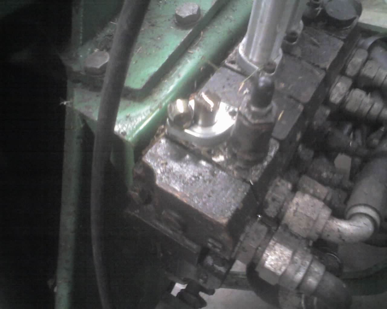

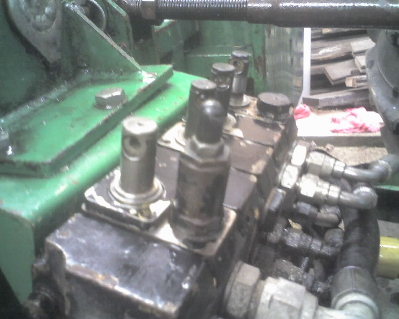

I got the mower working well just in time to break it.:mad: I mowed a strip along my drainage ditch and pulled the mower in to turn around and go back to make another pass. When I did I smacked the valve assembly with the mower head. No visable damage to the outside, but it wouldn't turn the mower on any more. I pulled it apart tonight and here is what I found.
The first picture is what the top of the valve spool used to look like and the second is what it looks like now.:mad:
The top of the spool snapped where the pin goes through it. As parts for the valves are no longer available, I'm going to see if it is possible to get it welded. The alternative is to replace the entire valve stack assembly.:ashamed:
View attachment 170630 View attachment 170631

Yea, it sucks. But at least now I know to always tilt the mowing head verticle before pulling it all the way in.:laughing:
I'm just hoping that the spool can be repaired. If not, that's when it will really start to suck.:mad:

If you can find a good welder, I would take the spool out of the valve and let him build up the metal on the end, enough to bore a pin hole through it. and reconnect everything.

That's kind of what I was thinking. I'm working on getting someone lined up right now, but I still have to tear the valve apart to remove the spool. I won't do that until I have a chance to remove the mower from the 3PH.
Once I have the spool removed and off to be welded, we'll throw ideas back and forth until we have a solid plan on how to make the repair.
My basic thought at this point is:
1) clean thouroughly
2) weld and redrill if necessary
3) mill or lathe back to origional diameter.

Yeah, that is a bummer Cyril ... so sorry to see that happen.
But JJ is right and your steps for repair are the right way to approach it.
BTW, you can probably find someone local to do it, but if not, I know someone in CA that can do it for sure.:)
