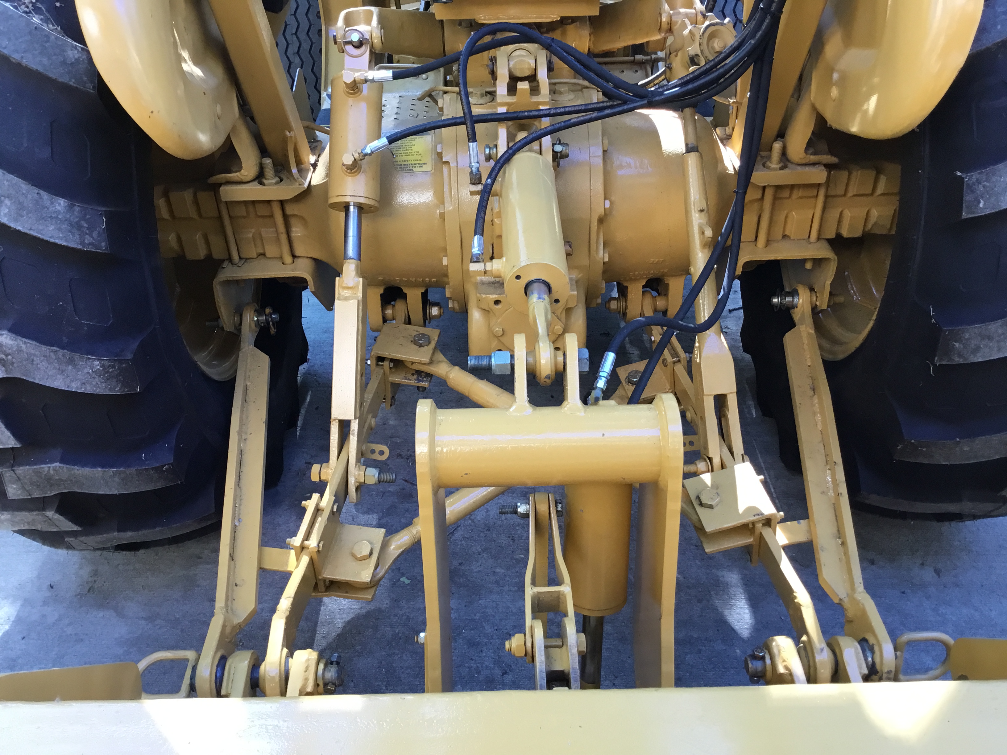

Here are the dimensions for the level system. The rod that goes to the bucket arm I made as it was missing. It is 43" C to C, with adjustment available both ways. The second one is 2 piece, the portion from the your part that got broken is a piece of pipe. The clevis is welded to the pipe and it is 48" from the center of the clevis pin to the end of the pipe, the second piece inside it has a clevis welded to it that attaches to the same pivot as the bucket rod, the rod portion is 45" plus the clevis, the third and shortest rod thats sits verticle and attaches to the broken piece is 15 5/8" with adjustment available.

If you need a closeup of the assembly let me know. image.jpegimage.jpegimage.jpeg

Thank you so much for the measurements! I am having a hard time understanding the measurement on the top long rod that goes from the broken piece to the pivot. I understand that it is a 2-piece rod with adjustment, but I don't understand the overall length from the center of the 2 clevises as it sits. The measurements you supplied (48" and 45") added together seem a bit long for the space that I have.

The 45" rod goes inside the 48" pipe and that is a sliding part. It has to be able to slide when the bucket dumps because the travel is too great, maybe that is how the piece broke.

Now as for the rod. I had no idea that it slides inside itself...Definitely why mine broke...I just went on the Ford site. I see exactly what you are talking about with the 2 pieces. I may have to purchase the inner rod from Ford. Geez...The arm that I broke is $136 from Ford.

The inner rod is 1/2" with threads on the end for the clevis. The outer is just 1/2 black pipe, loose fit, I guess they did not want it to seize up. You could get schedule 80 then it would be tighter, does not matter in that application.

The DOM tube that I initially purchased will work just fine to make the outer tube. 1/2" rod will slide right in, not that loosely, but not too snug either. I will get some 1/2" rod in the next week and try it out. I was able to download the picture you submitted and then zoom in. I see clearly now what you were talking about. I am soo mad that I didn't see that I was binding the arm up before I broke it, but I was soo busy looking at the rods that I had installed and adjusted. Again, I truly appreciate your help on this!! I would have never known that the linkage should be sliding and would have broke another one.
