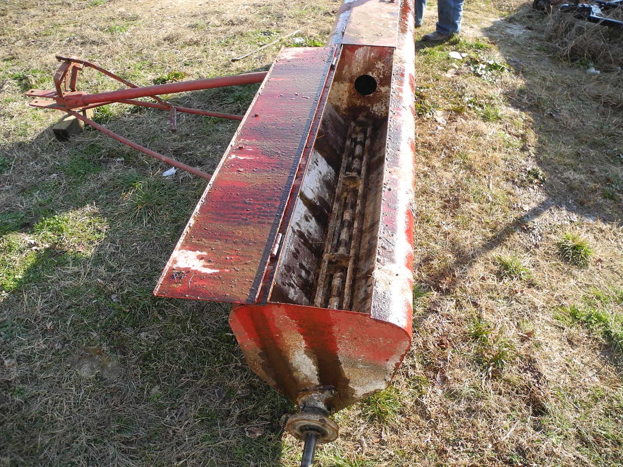

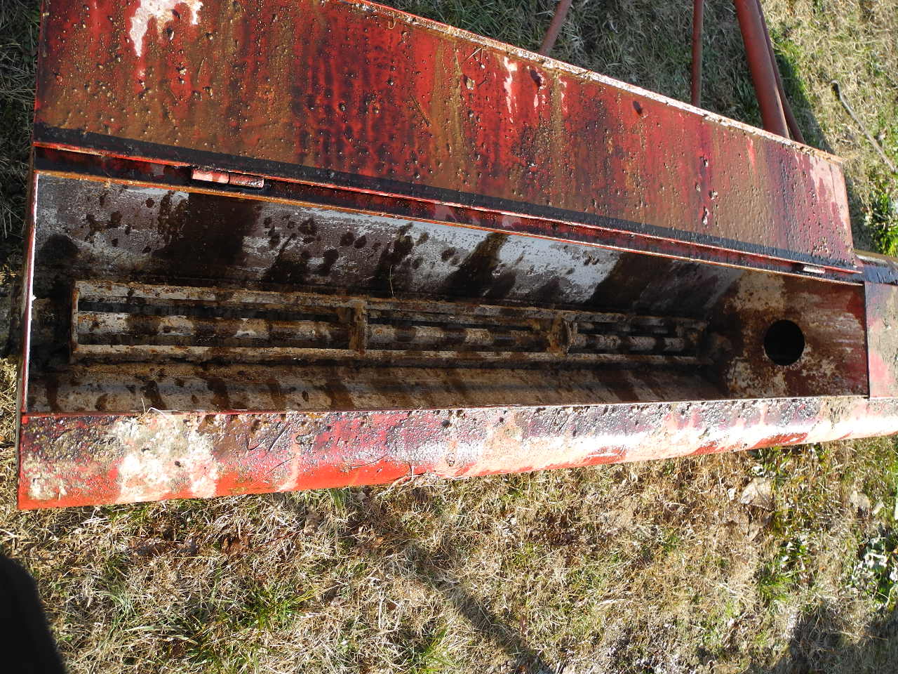

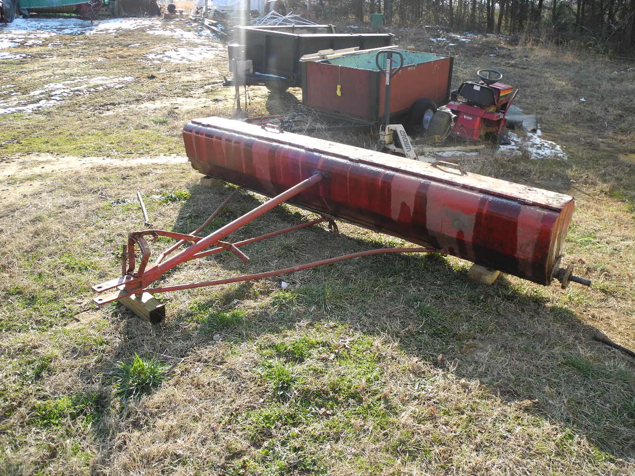

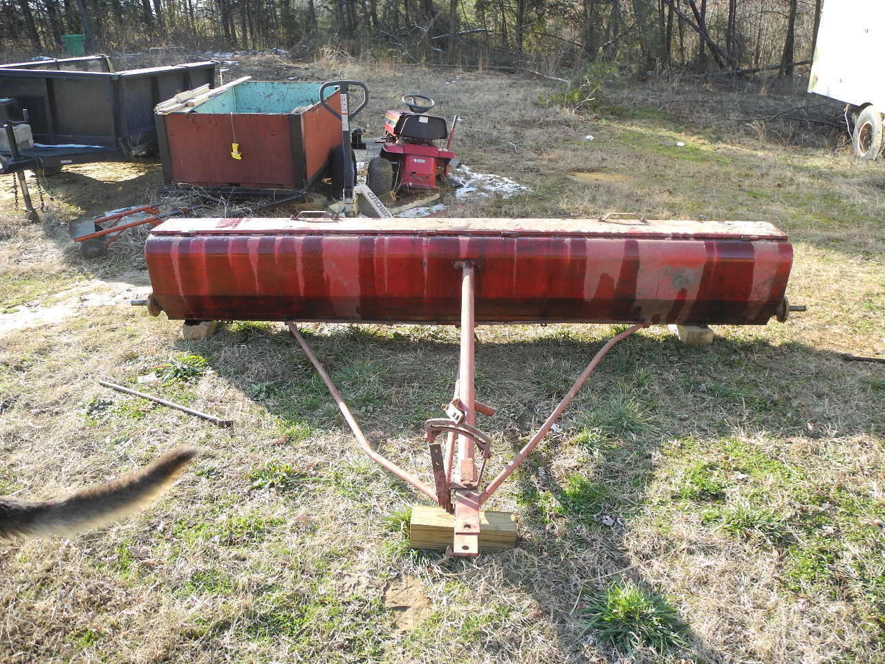

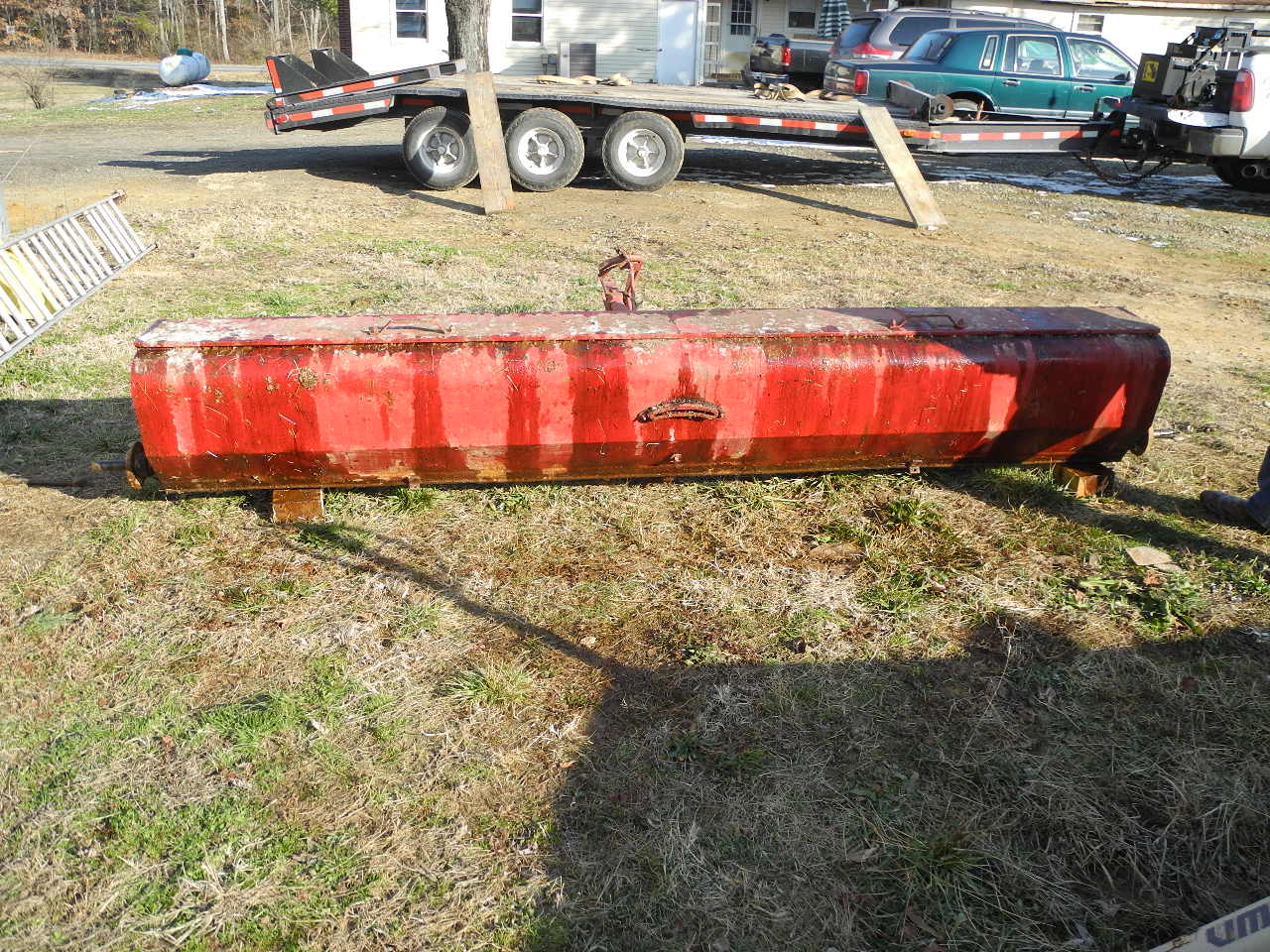

Howdy folks,
I picked this up yesterday from a nice fella up in Pennsylvania. The red looks to be its original color. The wheel pattern is a 5-spoke star. It is ten feet wide. I did not see any data plate or any thing with a make and model number. It is in great shape (well, it does need a little TLC). After getting it to the house, I had to free the metering gate on the bottom. It was caked with old fertilizer and dirt. After a little banging with a hammer, some oil, and scraping with a chisel, the metering gate now slides freely back and forth. One of the axles was locked too. Again, a few shots of grease, and some rocking backing and forth of the wheel, it broke loose too. I got the wheels off becuase the tires are completely shot. Once I get those replaced and back on, then I'll be laying down the lime. I would like to try and get a manual or something though to make sure I got the settings right.
Thanks.

It's a grass seeder is'nt it .??
/ Need some help identify this fertilizer/lime spreader? #3
These are called "drop seeder/spreaders" and will spread seed, ferterlize, dry lime, dry litter or a combination of any of these materials mixed together. I have been using these for over 50 years. Ken Sweet

Possibly a Gandy brand?
The hopper looks very similiar to both the Gandy and Ford Dearborn/New Holland Models I have come across. However, the metering lever on those models were different than the lever on this one. If I can't locate a manual, I reckon I'll just trial and error it.
I have read threads both for and against these types of spreaders. Key is making sure it is dry. The main reason I went with this spreader was I having a hard time getting someone to come out and spread lime on my small field (only 5 acres). I'll see how it does. I do have a spin spreader where I could use the pelletized lime, but I can get ag-lime for a little over $11/ton versus several dollars per bag (adding to over $1000) for the pelletized.
