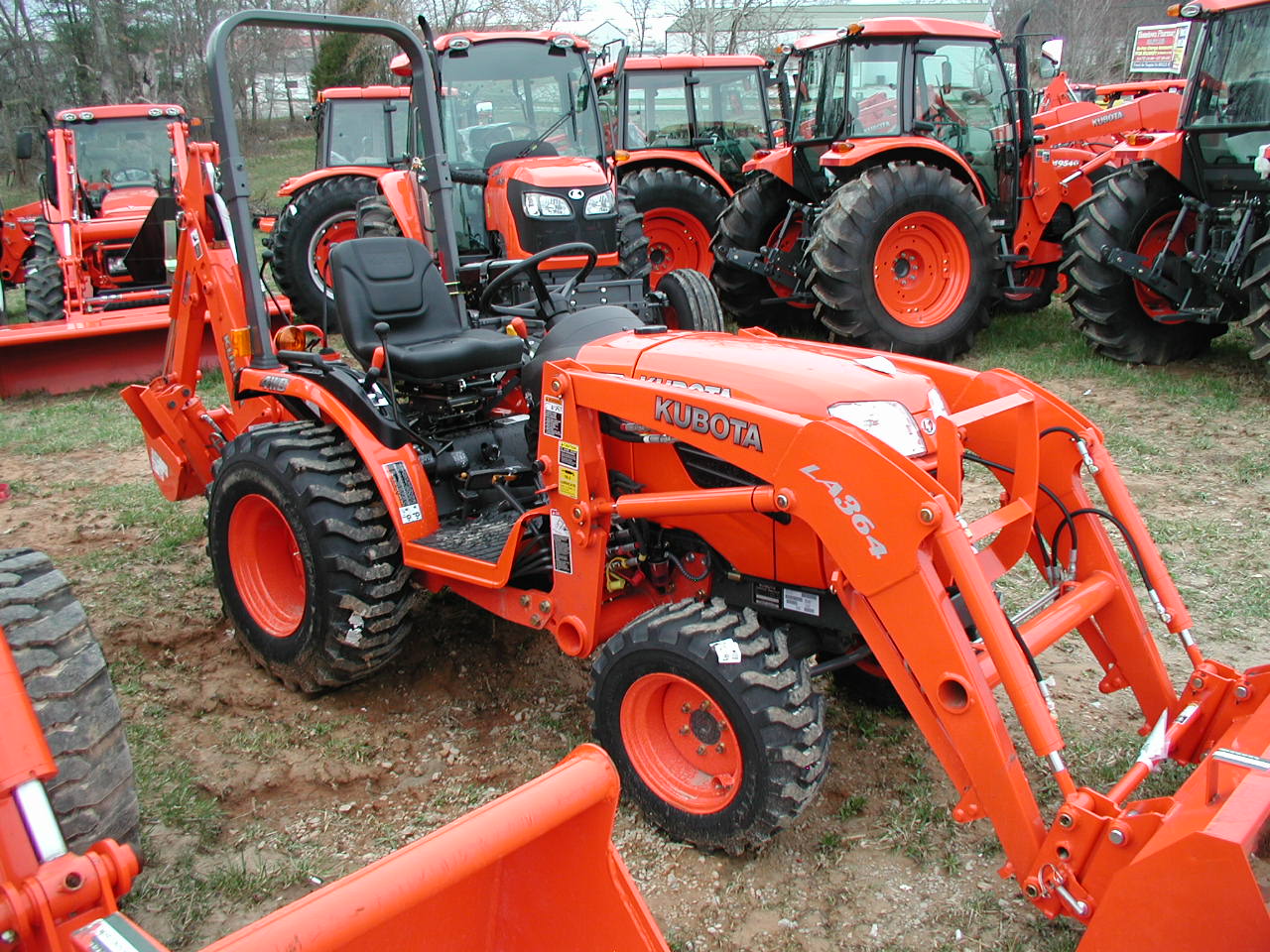

Hummmm - not sure I would totally subscribe to the statement the B series does not come with a quick attatch bucket. I just brought home my new B2920 last weekend and it has what is called a B1658 Quick Coupler on the loader arms (see pic) - the manual states it is for a LA504 but my B2920 can right from the factory with it.
Funny but I was provided with a manual for this specific option - and in it it states --- "The B1658 Quick Coupler is desighed to be used with the LA504 Loader and is compatible with the B1625 54 inch Bucket, B1626 60 Inch Bucket and B1659 Pallet Forks".
If this isnt a option on the B's than maybe someone at the factory goofed - but I doubt it. I'd go back to your dealer and ask if the B1658 is a option on the LA364 loader. Heck - show him (see pic) :D

By the dealer price book, it doesn't list the LA304 and LA364 as having the QA option. But thanks to you, I now know that it's possible.
Kubota is probable concerned with the added distance of the bracket on this size tractor if I had to guess. I believe that there are alot of these instances that are like this with Kubota in regards to attachments fitting other items other than what our books tell us. Thank you for the information.

I thought I saw a pic somewhere of the pin-type QA on the little B. Must have been a pic of your new machine, Jambx.

My L3240HST had the quick attach bucket. It was the skid steer type quick attach. 2 big levers pulled up near top of bucket on the back which pulled the 2 round pins with a tapered end up out of a catch plate on the bottom of the bucket and bucket comes off. My new B3200 has what's called the quick attach bucket. Rear top of bucket has the lip to catch at the top but the small pins pull loose at the bottom as shown in the earlier picture. I had a B7800 and the bottom of the bucket had big round rods that had to be driven out of the bottom and then driven back in. Extremely difficult to do alone. People are using the terminology of quick attach as all being the same. They are not. The skid steer QA is the easiest one and can be used with other skid steer attachment plates. I had the skid steer QA plates welded to my forks but when I got my new B3200 the forks won't work on it. I traded the old forks to Barlows for new ones that attach to my bucket.
