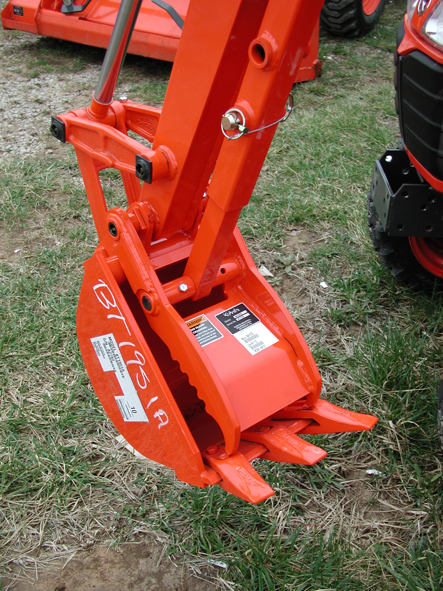

Oh and get a thumb - it is a huge addition of capability to an otherwise great attachment (I use mine to pick up cut logs and place right on my log splitter :)).
