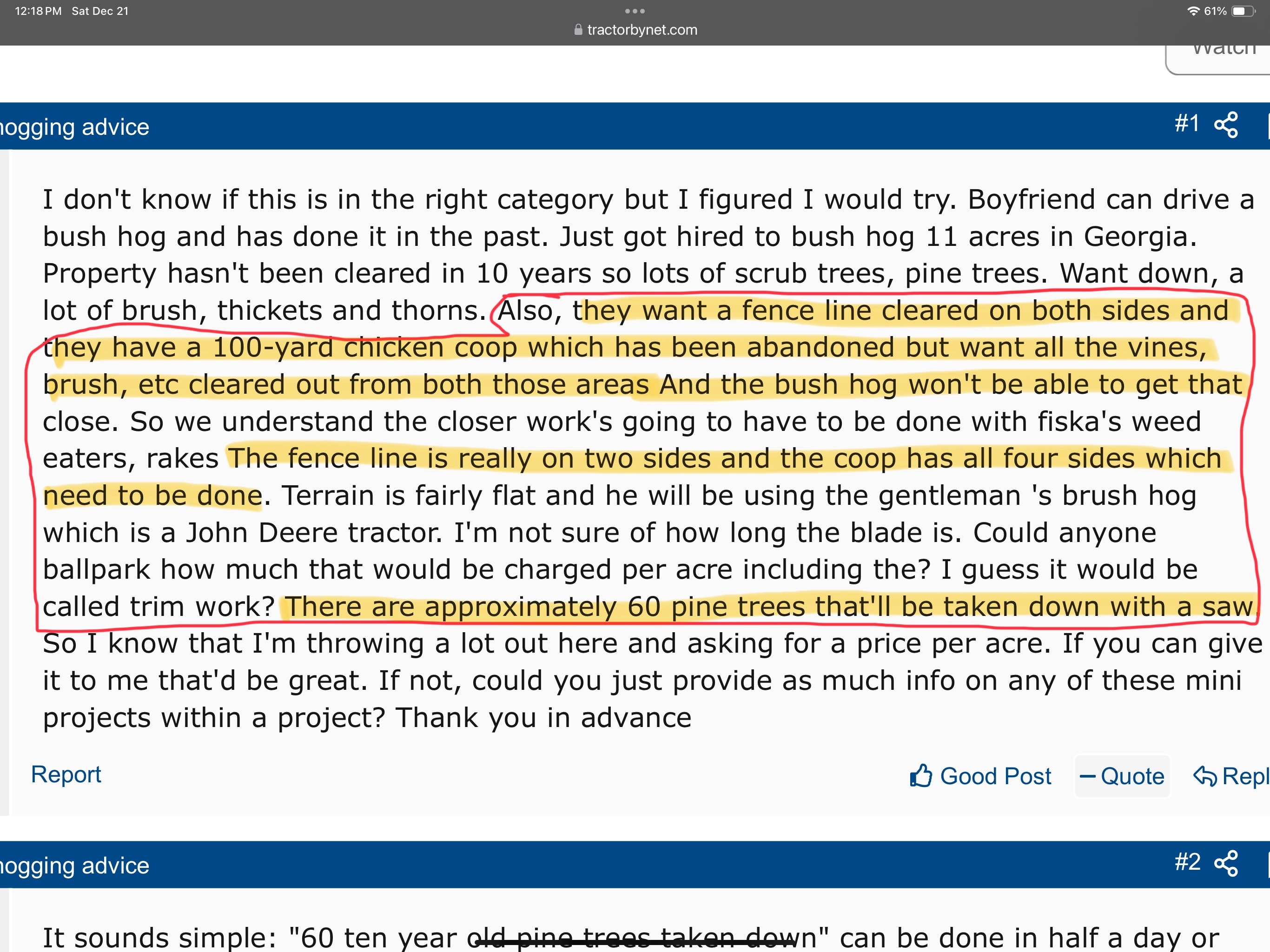

Isn’t the OP also doing other things that don’t involve the customers equipment?
Taking down 60 pine trees? Cutting with a weed wacker/saw blade near buildings? Chain sawing? Maybe chipping the trees, branches, etc.
1. How do all those tasks fit into ONE hourly rate? Thats like saying “I’ll do carpentry, plumbing, electrical and masonry for $100/hour”.
I know this, I’d want different rates for all those different tasks. Running a weed wacker is a different pay than driving a tractor & bush hog-whether you own the bush hog or not.
Also….
2. The different tasks require different amounts of time, right? There might be 11 hours of bush hogging, 25 hours of tree cutting, 40 hours of weed wacking, etc.
It won’t fit to ONE “hourly” rate unless this is a customer who just wants to help this guy out and give him some work. If there’s multiple bidders, he’d have to be lucky to get the job at one hourly rate, or underbids it and the customer takes him based solely on underbid cost.
Even if he takes the work on an hourly estimate, the customer will be watching him constantly to make sure he’s working. An overall job bid allows him to do the work at a more comfortable pace and take the “pressure” off.
I really only wish the guy success, but everything becomes easier for him and the customer if he “internally” prices it all out per hour for all the different tasks, adds it all up and gives the customer a Proposal of overall cost.
We don't know. That wasn't specified by the OP. If he is doing those things with his own, or rented, equipment, then it would certainly make sense to bid those things.
   / Need some bush hogging advice #39
We don't know.
I do. The OP listed them.
Yes, it very clearly was. Go look at post #1.
Here’s the other things that have to be quoted separately from sitting on a tractor pulling a bush hog around.
   / Need some bush hogging advice #40
I do
Here’s the other things that have to be quoted separately form sitting on a tractor pulling a bush hog around.
I meant that we don't know whose equipment is being used. She did not mention a chipper. She mentioned that they are "in the South so it's saplings and Small pine trees". I'm not sure what being in the south has to do with the size of the trees, but she seems to be implying with this statement that they're not dealing with anything of any significant size. She also mentions "fiskas" several times. I'm just guessing here but I'm thinking that "fiskas" might refer to the brand Fiskars. Fiskars makes a wide variety of gardening and yard care type hand tools, such as loppers, pruners, saws, axes, rakes etc. as well as crafting supplies, such as staplers, scissors and paper cutters. Given the context, I'm guessing we're talking about either loppers, pruners or possibly rakes. She mentions that the trees can "more or less be taken down with a chainsaw". Any tree can be taken down with a chain saw, so I really have no idea what exactly the "more or less" is about.
I say all this to point out, again, that we're talking about someone who is clearly very new at this. I say this, not to denigrate the OP or her boyfriend, but rather to point out that trying to help them bid a job of this size (20 acres of nasty brush is a big job for someone who is new to this and doesn't own or rent equipment) without more information is going to be extremely difficult or, more likely, impossible.
