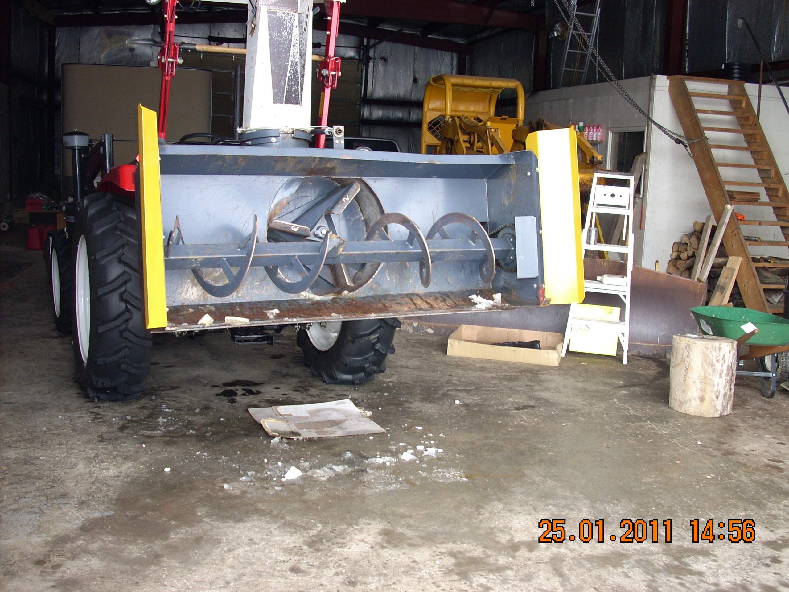

I have a tractor the same size as the OP and I have a front mount snowblower for it. I very seriously cross-shopped the 2032R and the B3350. I think he's got plenty of tractor for his needs. If snow was as big a part of my use as his, I'd have gone with the Kubota because of the fantastic 63" front-mount snowblower they sell for it. It's incredibly heavy-duty.
If I were him, I'd purchase that snowblower as soon as possible. 63" will clear a >10' path in one trip down and back, even with a little overlap. That's plenty wide to drive an SUV up and down. I know he's worried about having the FEL on to clear drifts, but the joy of the snowblower is that you don't end up with drifts anywhere. The road is less than a mile, so he should be able to clear a path down and back in about an hour if he can maintain 2 MPH. If they really get hammered with snow, then he might have to slow down a bit and it will take him a couple hours. Still way less time than he's devoting now messing with the plow and blade.
The other disadvantage to the plow/blade when he gets as much snow as he does is that it is just going to continuously build-up at the side of the road. He'll have to do something to push back the banks at least a few times during the winter as the cleared path narrows, and imagine having to do that on both sides of a mile of road!

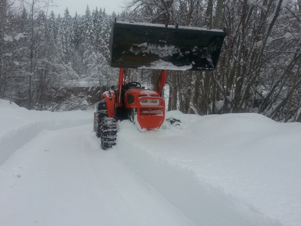

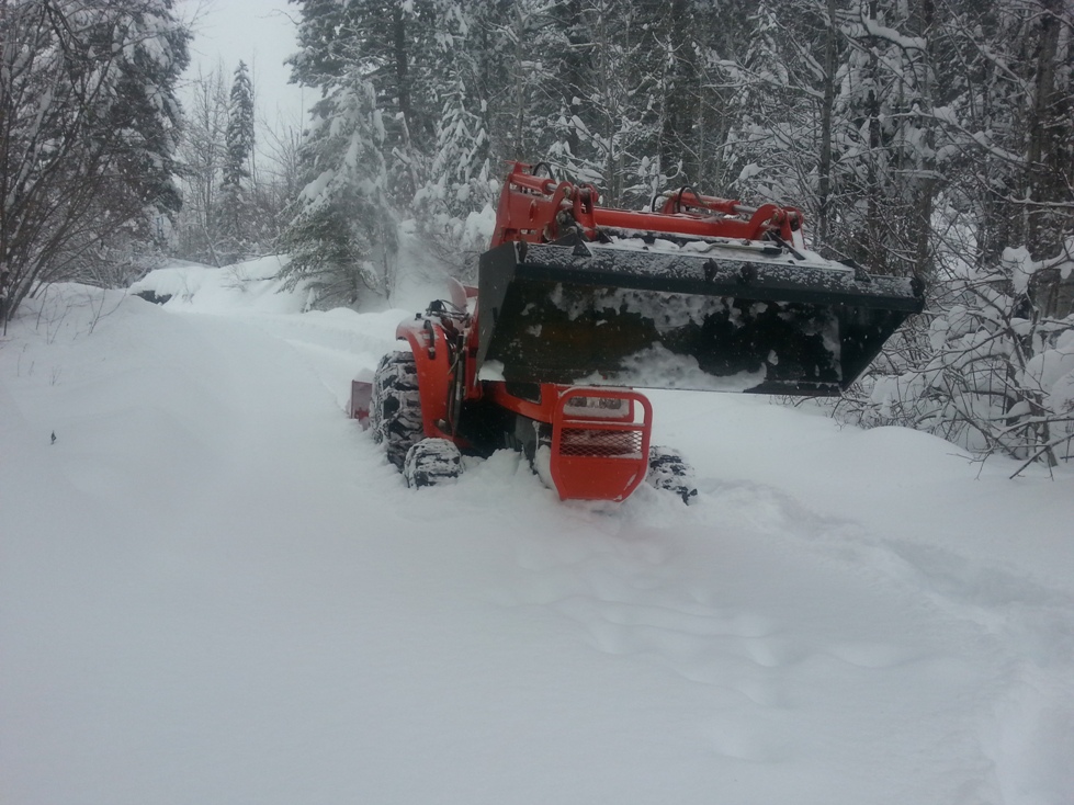

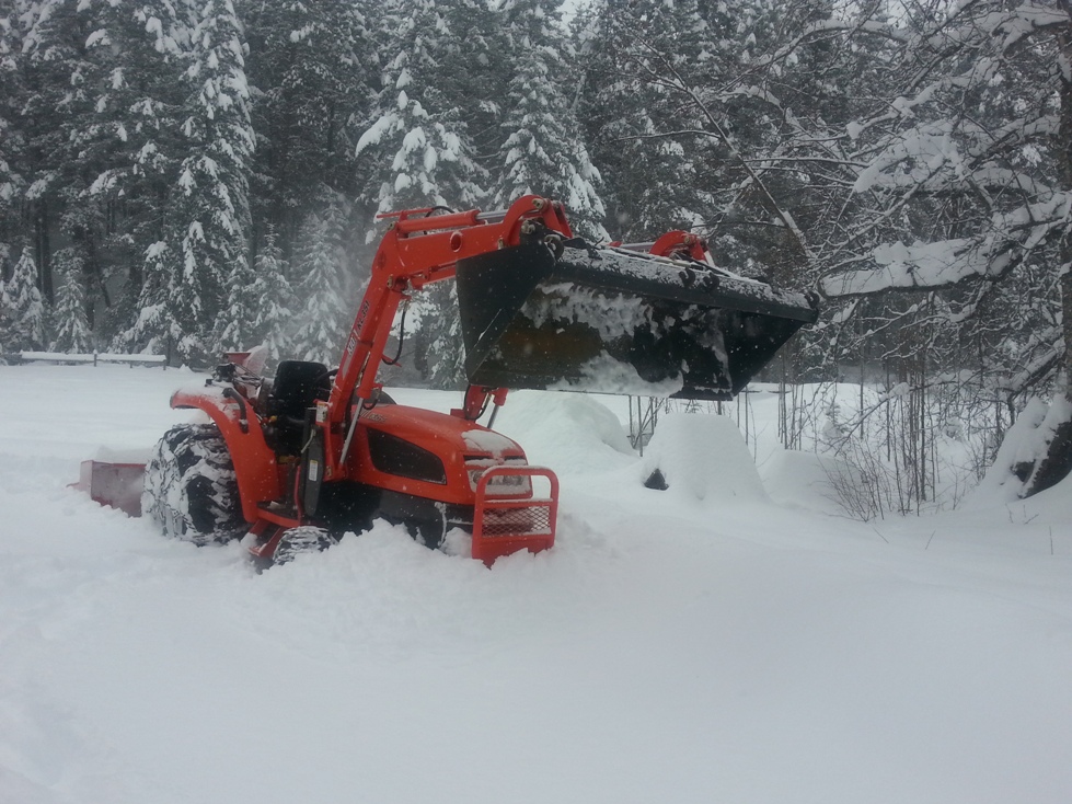

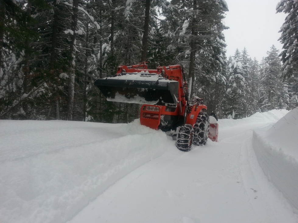

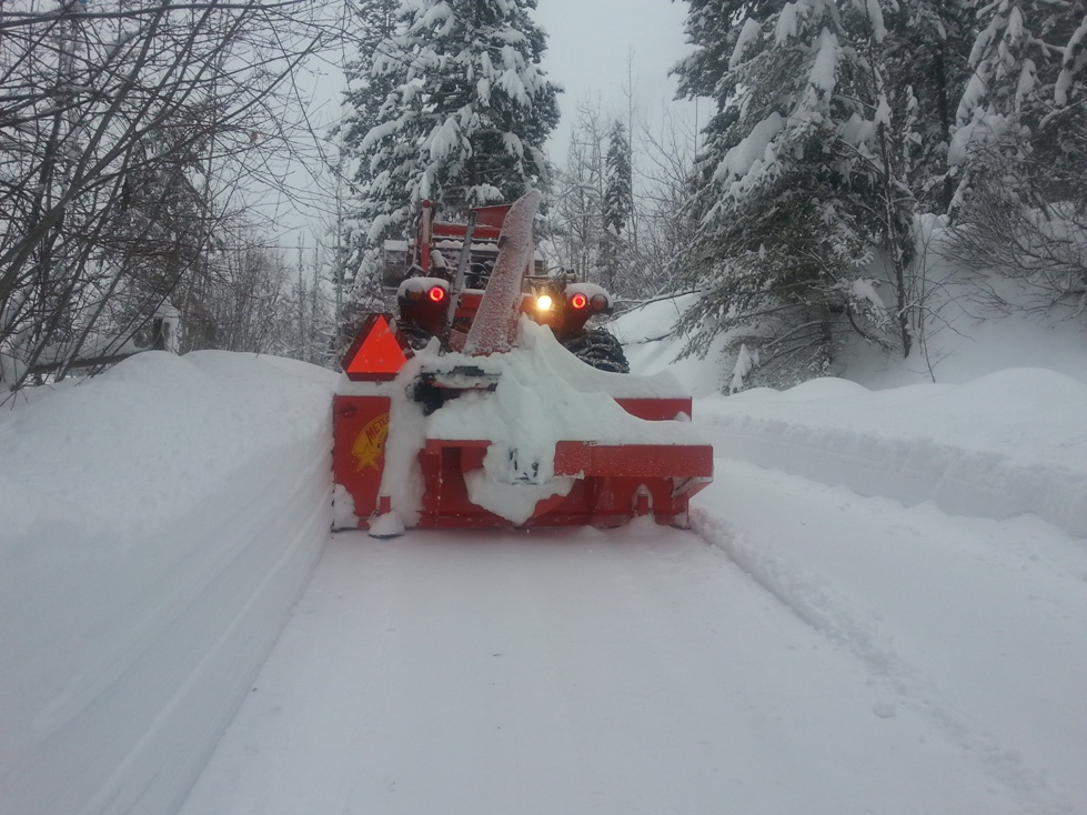

Impressive, kco! Without a cab, what do you do about keeping your coffee warm?
We could use some of that snow please . . . last year was bleak and this one is shaping up to be even worse.
A cab would be nice but would not let me do the majority of my work, which is in the bush. It was not that cold and warmed to about freezing through the day. That made it worse because it snowed lightly all day(we got another 6" through the night) and I got soaked. It is much more comfortable at -5 C. It was a bit better after lunch because I changed and put on gore-tex.
I spent over 10 continuous hours(plus 1/2 hour for lunch) that day. It is the most sustained work my tractor has done. The throttle was wide-open most of the time and I just kept it at 540 PTO RPM by varying the HST pedal.
But a funny thing happened at the end of the day. I was travelling home in the dark at 17:30 when I met another neighbour with his DK45 cab/blower tractor at our only side road intersection. He was returning from clearing other neighbours. I was soaked and very miserable. He came out of his nice cab in his shirt sleeves, and we chatted a couple of minutes before I shivered off home. I didn't ask if he had warm coffee in there!

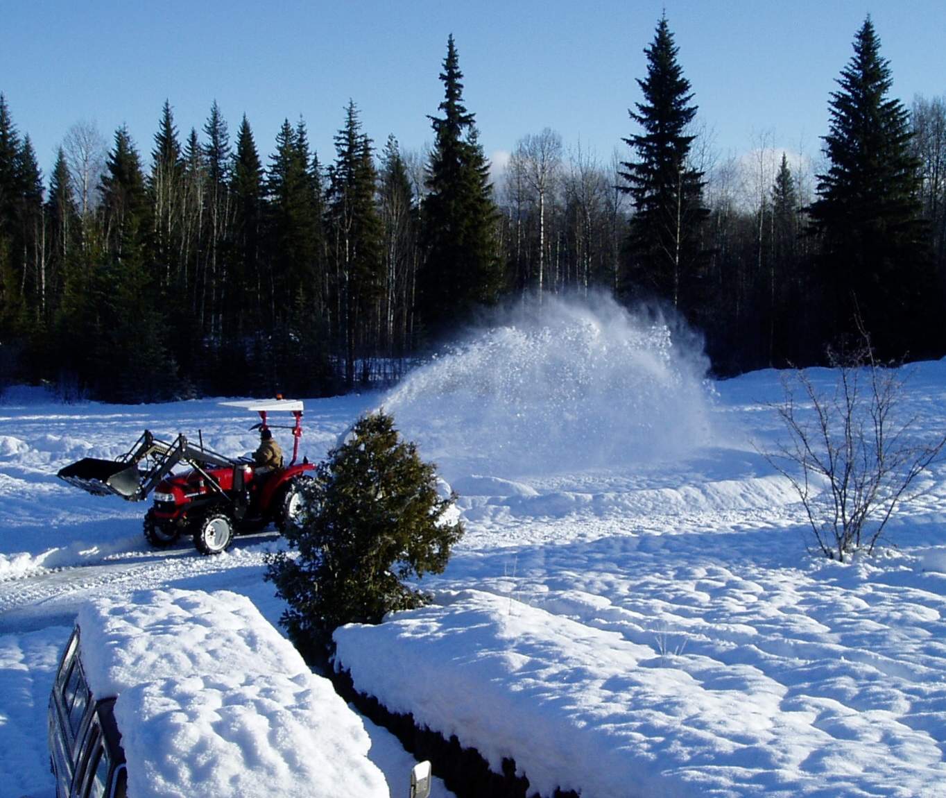

If "I" had a choice between a rear push or a rear pull blower, I would definitely go for the rear pull.
The only thing I don't like about blower's, is that their slow, a front mounted blade can be "driven into" the side snow banks, pushing them back, making more room for snow. Using the bucket to remove those "hills of snow" that accumulate at road ends afterwards.
A QA bucket and blade is about all you need, the blower is just a nice accessory to have.IMO
