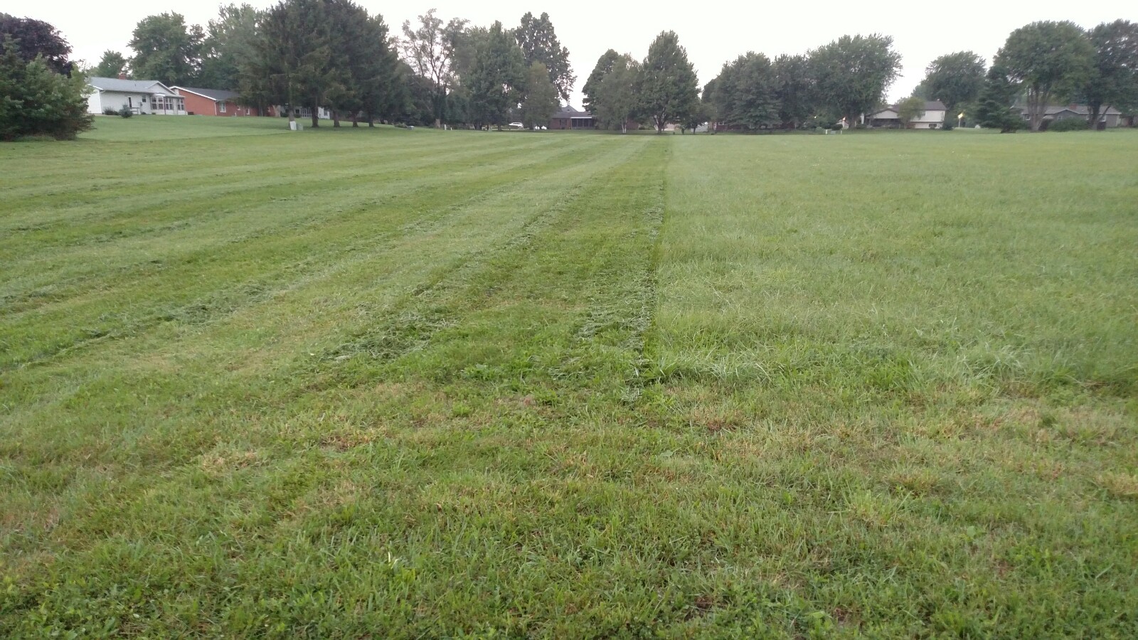

You might want to consider something else to do with the land instead of finish mowing 20 acres. Even 10 is alot, but depending on obsticals, ~3 hours on a 84" Zero-turn.
Anyone around there that can make hay? Just how hilly is it? Could it be farmed....beans and corn?
IF those dont work......I'd be looking at something like mowing ~5 acres around the house with a finish mower, and do the rest with a bushhog monthly. Grass dont get real bad after a month. Especially on an area that large. But what are your intended uses with the 30 acres other than to mow.
Here is what waiting a month, and mowing at ~4" height looks like with a bushhog. (and this was mowed way faster than any finish mower would have done it)
IF you want it finished mowed.....you are gonna have to do it every week.
