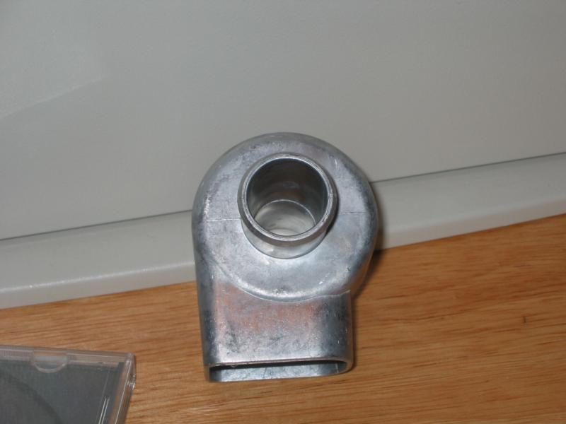

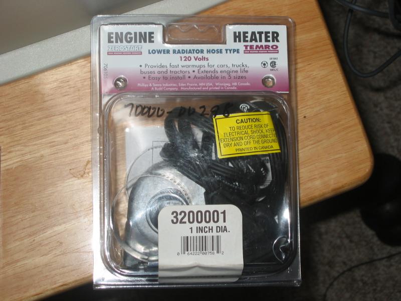

Attached are a couple shots of the heater I got from the dealer. The heater came shipped in a Kubota marked box from Kubota Tractor Corp. Groveport, OH and is not a Kubota branded heater. Has anyone installed this heater on a BX2230? Instructions call for an upward slope of lower hose towards the block and mounting the plug cap side of the heater facing up. I don't think there is enough room to do this without hitting the fan belt or the dynamo/ alternator. There is also no upward slope to the hose as far as I can tell towards the block It just kinda comes off the radiator makes a 90, then makes a U shaped loop under the alternator and goes into the block just above the oil filter.

According to my parts book, there are 4 different heaters available for BX series Kubotas.
Based on this it doesn't look like there is a freeze plug model for your tractor. Does the engine block have a freeze plug that can be removed? You can always try one of the first two parts above.
/ Need Part Number For Block Heater
Thanks for the info Mad. According to the part number (70000-00298) and looking at the invoice for what I recieved , I do seem to have the correct part, though the invoice calls it a "Kit, Frost Plug".
Anyway, I have found out that while a tight fit, there is supposed to be enough room to install it in the straight part of the hose by the oil filter and just before the hose connects to the block. So I think I will try the install sometime this week and see how it goes.

Charlie,
I looked at your posting but must have spaced out the photo with the part number in it. If I had noticed the part number, I would have given it to the parts counter to order. Guess I can see if they will take the one I have back and give them the new number so they can order the actual block heater. If not I will go ahead and install the hose heater.
I think the block style heater would be a faster install and keep me off the ground more, which would be good as there is still snow on the ground, and not to mention ifeels like it is 1* out.
Dusty, I could probably fit the hose heater in the space as I am pretty handy with tools, but it sure looks tight, and if I upgrade the dynamo to an alternator, then from reading other postings, there may not be enough room for both to fit. Kinda like trying to put 10 lbs of s... in a 5 lb bag. I could let the dealer handle the whole thing, but I want the satisfaction of doing it myself.
