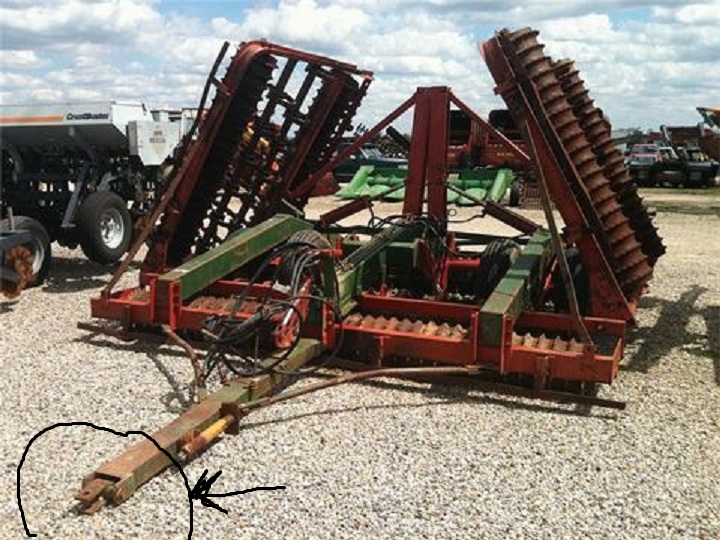

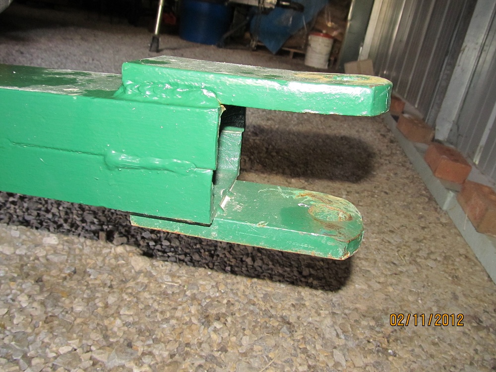

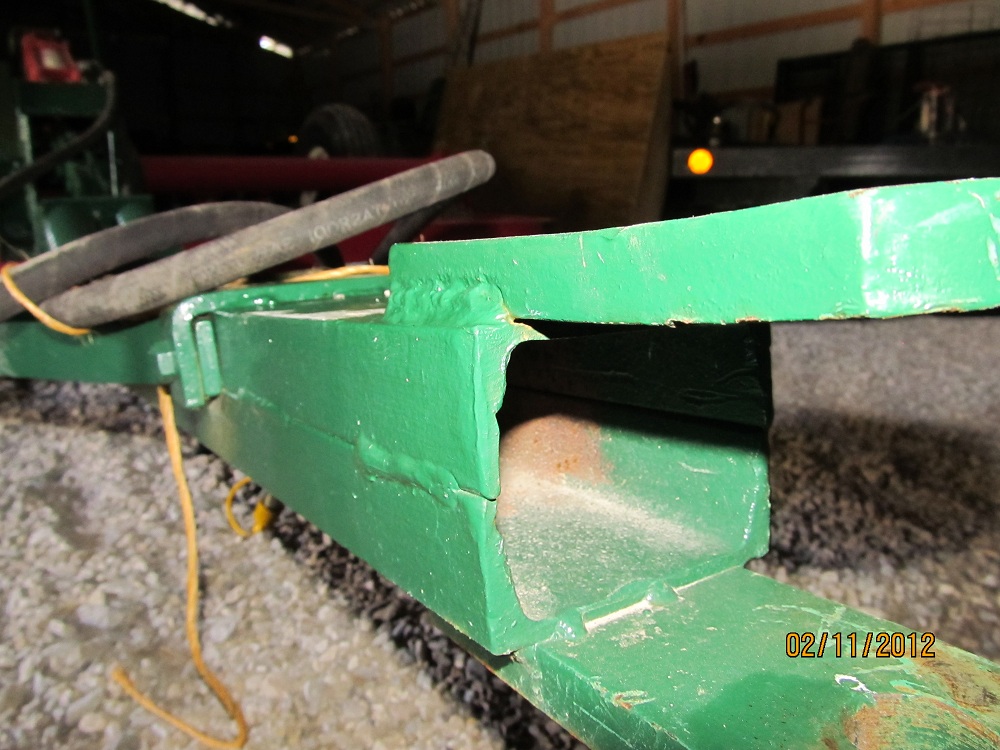

I have welded MIG for years and recently completed a Tech school welding class. My experience at home was with my Lincoln SP 170T (240volt 30-170 amp) and ag type thicknesses on the order of 1/8" and maybe 3/16". In school I used a much bigger Lincold welder--maybe 225--on thicker steel and it dialed the amps/volts itself on auto. It was wonderful.
Feeling my oats now I wonder if I can weld something with the SP170T that I have or if I should tack it and have someone else weld it? Photos attached. I want to cut off the upper and lower 1/2" thick plates and re-weld them sideways so I can use a clevis hitch with it that would fit the tractor better. The implement is a 2200 lb Brillion cultimulcher. Can my SP 170 handle this weld? I do not understand the relationship between amps and volts. I have it set up now with .023 wire and 75/25 gas. I also have some .30 wire but never used it. I also have .030 and .045 flux core wire. What do you think? Maybe I could also bolt the side plates to the hitch pole and then weld?
It would be nice to have a bigger welder but I don't have that much of a use for more than what I have, A stick welder does not appeal to me since the MIG is so clean and easy. What are the limitations of my SP170 and can I weld those plates to the sides of that steel hitch? Should I buy that bigger Lincoln welder? Any advice?

The 170T is really for all practicle purposes a 130 amp unit but it will work. When you cut the pieces off, Make a slight bevel in the areas to be welded. Clean very well..
Set in place and put a couple tack welds with .035 S6 mig wire to hold it in place. Pre Heat with your torch to about 500-800 degrees. Apply multiple passes running full power. Maybe do a little weave in your welds to burn in on both parts.. Nothing to it.

I own this mig also and with practice and the right wire speed you can definitely weld more than the rated capacity
I would drill your piece of steel (either the tube or plate not both) with a 1/2" bit and
weld the whole to the other piece as extra insurance against breakage

I have the same Lincoln wire welder. You can absolutely weld it up solid. The advice from the folks above is correct. Bevel and fit up your pieces very well. clean the parts with alcohol (not beer) to remove any oil. After the alcohol dries, clamp your parts together and pre heat with your torch. If you have a rose bud you can heat the parts up red hot. Use the .045 flux core wire at max amps. Before welding your parts, practice a few beads on a scrap piece of metal (clean and pre heat the scrap too) to get your wire speed right. Don't weld with little stringy beads, make the beads nice and wide. Practice and practice some more until you feel confident in your beads. Now weld your pieces together. If you can, start the weld bead before you get to the two pieces of metal. This helps you not have a cold start at the joint.
Be sure to change the polarity to negative for flux core wire. Instructions are inside the wire lid on your welder.
If you are not confident in your welding ability, having the mechanical fastener may not be a bad idea, or have a competent welder weld it for you.

I have run mine with flux core.
I would use the flux core, and preheat as described by yomax4.
I have welded metal that thick in the past, without any problem.
Keep in mind you will at some point run up against the duty cycle, and the welder will shut down while it cools.
You can't weld with this machine set at the higher limits for hours on end. But, you can do this kind of job with it.
