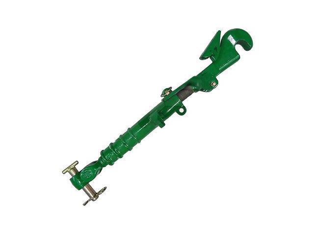

If you have a John Deere Category 2 top link similar to the one shown in the attached photo (part # AR34209) would you mind obtaining a measurement for me?
I need to know the minimum and max distance it will screw to.
Thank you for your help!
Mike

I have a JD 5525 with cat two but it does not look like this one. Willing to measure for you if it would help. It is not being used right now so would be easy. It maybe the model of tractor is more important than the design of the third arm is.

The photo in my post is the best one I could find that looks similar to the JD's. If yours has a hook on one end (like in my first post photo) and a knuckle on the other (like in the attached photo below) that'll be the one I'm looking for. If you have time, I'd sure appreciate the dimensions of when it's screwed tight and when it's screwed open. I believe, the John Deere part number is AR34209.

Top Link Assembly
John Deere - Fits: 520, 530, 620, 630, 720, 730
Replaces: AF2799R, AR21917R, AF2873R, AF2798R
This John Deere top link includes the hood on the end and the chain. Adjustable from 21-1/2" to 30". Uses a 0.750" diameter pin in one end and a 2" diameter ball in the hook end.

Thank you for the link! That is the information I needed.
