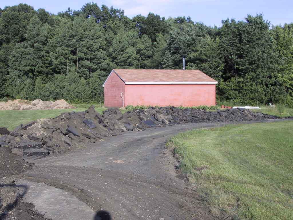

Here's a photo of a project I started this past summer - relocating and replacing the driveway. I used my B2910 and FEL to remove probably 400' of asphalt pavement that was 4" to 6" thick.
The shed in the background is 32' x 28' and sits about 15' behind the asphalt pile. The pile itself is probably over 70' long, 8' to 10' wide, and about 5' high. I wouldn't even want to guess how many tons - probably over 50 ton easy.

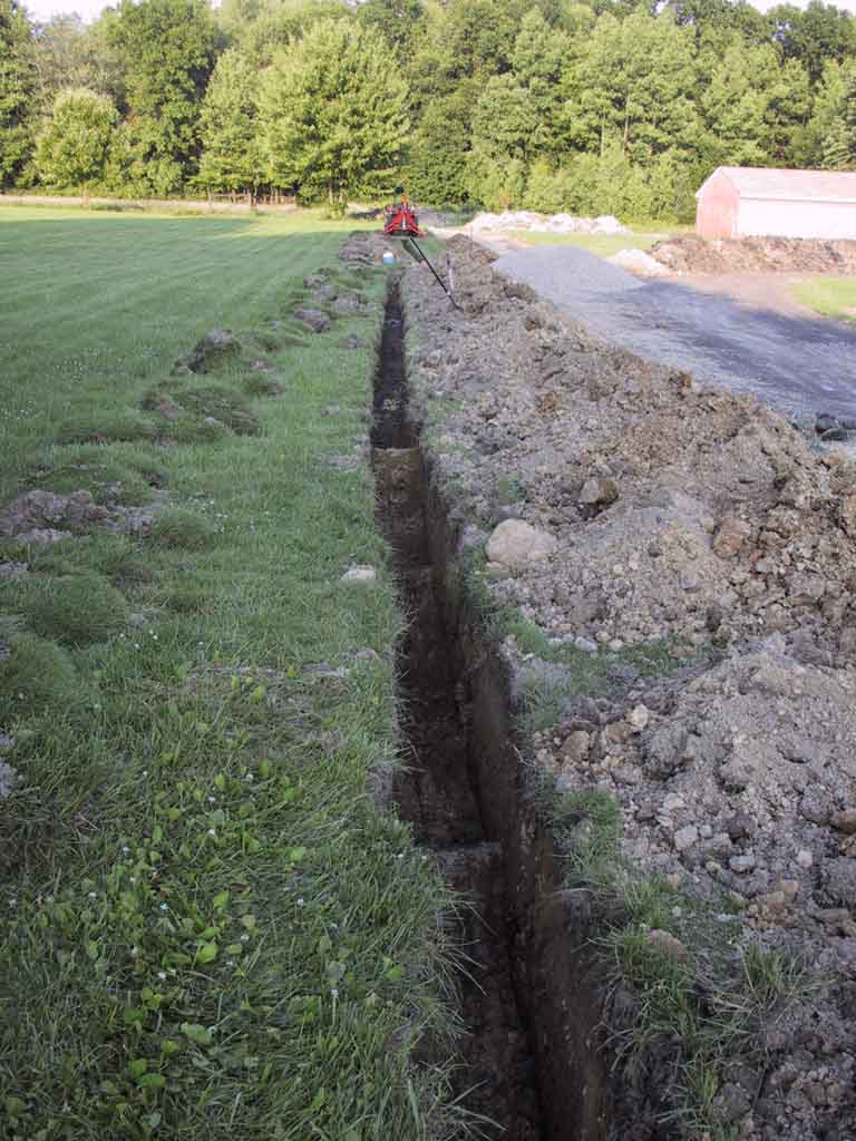

Attached is photo of another project I did last summer with the backhoe - installed 250' of french drain, along with a catch basin and 20' of culvert under the new road.

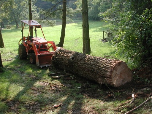

Here's a shot of a Willow trunk that fell in the ditch between at the property line and onto my neighbor's yard.
I was a bit of a struggle, but my B2910 was able to drag it out. Then my 18" chainsaw was too short to cut it, when trying from both sides, so I had to borrow my neighbor's 20" saw.
Will is not that heavy, but when in comes in logs this size, it's not light either!
For its size the B2910 tractor is a workhorse, at least around my place... /forums/images/graemlins/smile.gif
