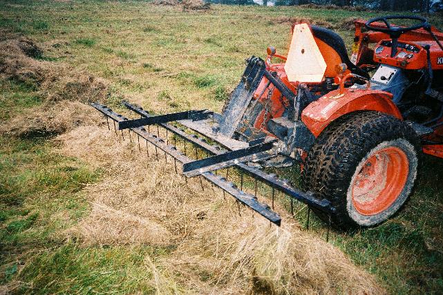

If you need to level the land prior to seeding a heavy object druig at an angle wiill be what you are looking for. It should be solid and as long as the tractor can pull. You should drag from diferent directions, till and drag again for a level lawn area. Might even take more times depending on how fussy you are. The draging will compact the soil.
Till again before seeding to loosen up the soil and use a harrow of some type to cover the seeds.
I made a smal harrow. [ pic. attached ] As you cansee it also has other uses.
