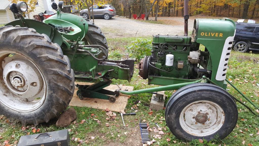

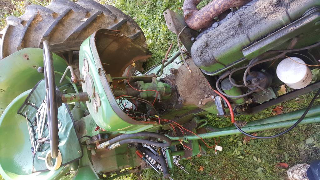

Here's the pics as promised. I am struggling with #3 and #4 from the voltage regulator. I believe #4 went to the 12v side of the resistor and #3 went to the 6v/coil side of the resistor. 20171102_172214.jpg20171102_170435.jpg20171102_170421.jpg

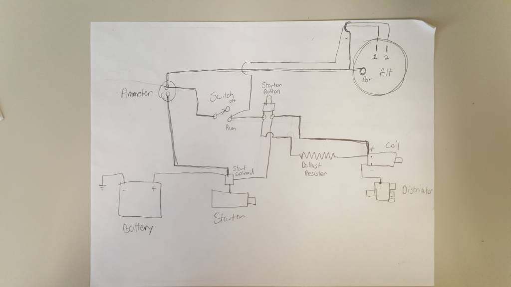

Thank you so much for that information. I believe you are correct and I have #3 and #4 backwards. Here is an updated wiring diagram. This is what I will go with and i will let you know how it works out.20171103_100630_001.jpg
   / Need help with wiring on an Oliver Super 55 #25
Thank you so much for that information. I believe you are correct and I have #3 and #4 backwards. Here is an updated wiring diagram. This is what I will go with and i will let you know how it works out.View attachment 527218
If you can wait until later today, when I have less nausea from the pain drugs, I will be able to think more clearly.
I think the ballast resistor should not be part of the alternator circuit.
Could you post a picture of the resistor and also of the diode you have previously mentioned.
Would hate for you to blow something and then have to get another regulator or alternator.
Dave M7040

I can definitely hold off. I believe the ballast resistor will work in place of the idiot light/ resistance wire in the diagram you provided me. I know it was hooked up to the resistor originally. I can take a pic of the resistor and diode hopefully tonight depending on the weather.
   / Need help with wiring on an Oliver Super 55 #27
Where is the Start Switch you had talked about?
If the resistor you have is a white ceramic one then it is for the coil and has nothing to do with the alternator and regulator.
Where is the diode in your wiring diagram?
Dave M7040

This is a better wiring diagram than I got from my old book.
Note the use of two resistance wires. One 10 ohm and one 1.8 ohm.
I added some color to the wiring diagram to help me understand it better.
I did not use the colors on the wiring diagram itself as there is no way to mark a white wire on white paper
Do you have a multimeter ?
Dave M7040
