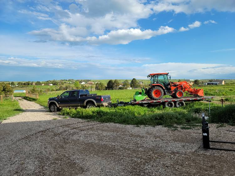

Exhibit 1: 4k of trailer, 5-6k of tractor loader & ballast & 1.7k of mower. Weigh Safe hitch says its 1.2-1.5k lbs depending on how I load things. Tows fine even at 75mph down the freeway (I'm usually on back roads or around 65 maybe 70). No WDH.

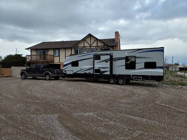

Exhibit 2: Toy hauler trailer. 12klbs, 1.5k hitch weight & everything properly sorted out according to cat scales (weighed with & without WDH). It tows really twitchy over 65 no matter how I fiddle with the WDH or weights. Not pleasant to tow more than a few hours. Hitch weight is way excessive if you don't have the toy in the back to unload the front.
Blue Ox WDH. Is OK to hitch & unhitch. Never had another WDH to compare it to. Trailer length, surface area & center of balance can be more important than a WDH.View attachment 758343View attachment 758344
Cross winds will push that camper around. I'm not sure your tractor load is as heavy as you think though. My JD 4105 is only 4K so unless you have filled tires, you're lighter.
