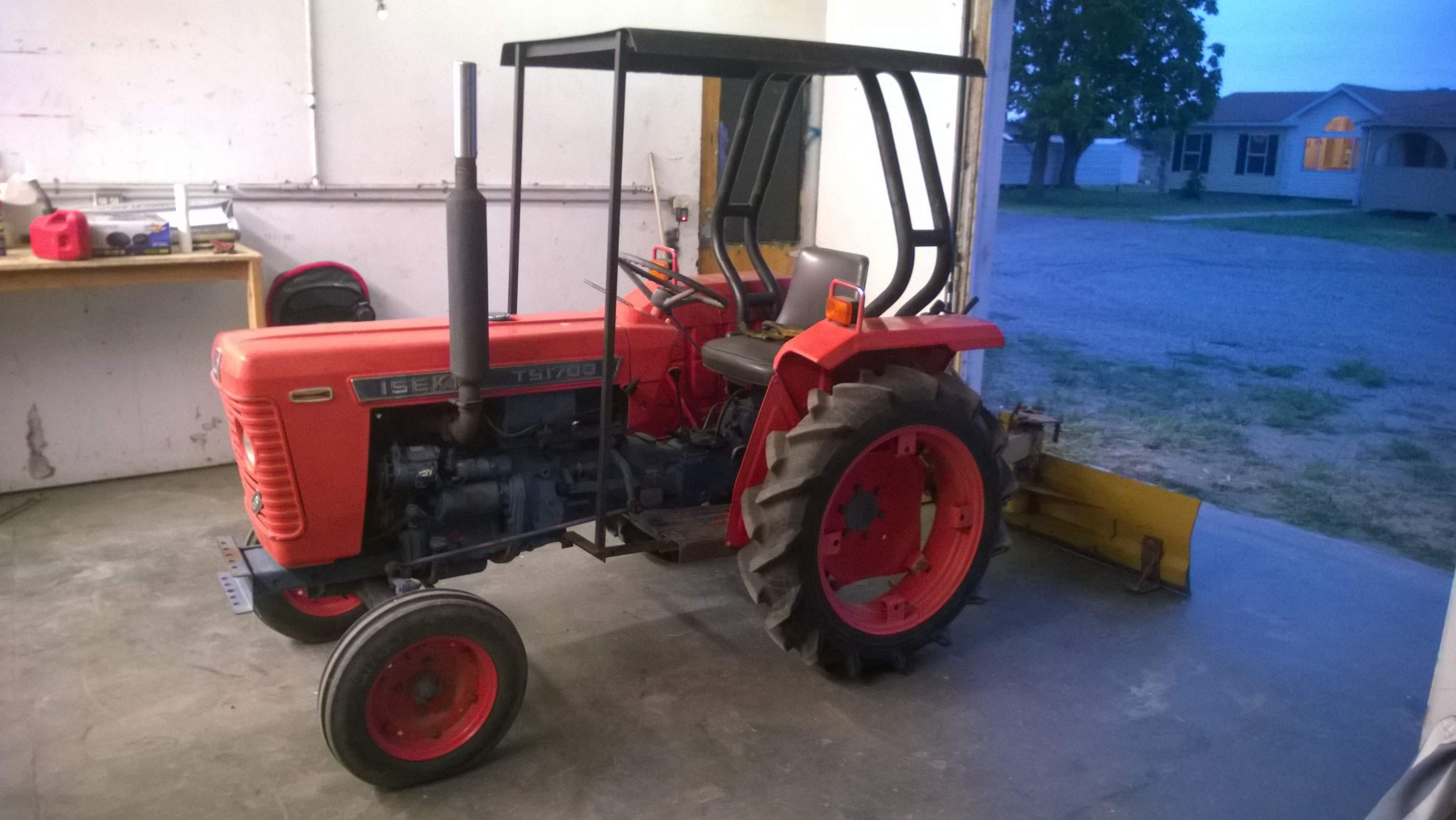

Hello,
New to the forum's Just bought an older Iseki yesterday it says its a 1700 on the hood, 2 cyl diesel. The issue I am having is it isn't charging the battery. I am not sure if their is a voltage regulator on this or not, never worked on many diesel's.
Any help would be appreciated.
It runs just fine once it is started, so I don't think it is the alternator. all the Lights have been unplugged and it still has a battery draw and won't charge. WP_20150904_002.jpg

no i can charge the battery with a charger, but while it is running it drains the battery and the alternator on the tractor will not keep the battery charged
/ Need Help With old Iseki and Charging issues #4
On my TS1610 the posistive line from the alternator connects to the positive from the the battery at the starter. There may or may not be a ground line on the alternator. And there is a ground line on the battery. You could look at those four lines for bad or dirty connections.
It is a direct connection from the alternator to the battery, through the terminal on the starter. On the TS1610 there is a voltage regulator but that is not part of the charging, it regulates the voltages to the warning lights and head lights.
You could also take the alternator to a car parts store and have them test it. Autozone and some of the others can test the alternator for you. Or if you have a voltmeter you could test it.

ok cool thanks for the help Rich, yea mine is a TU1700 but I will look into those wires. It has a really old connector at the alternator that is falling apart lol
/ Need Help With old Iseki and Charging issues #6
Hi I am having the exact same problem. Brought the alternator to a guy who strips them and hoe could do nought saying the windings are gone. Have not been able to source original but getting a replacement new one with a built in regulator. Bit of messing to do with the wiring now though! Mines a tx1510. Did you have any success? Thanks
