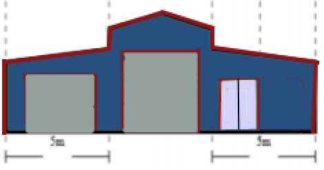

I'm building a steel Barn at present so to give you an idea. 50 ft x 40 ft
Kit $33700 Incudes 2 x Powered Roller doors and a Glass ranchslider door and some windows. Guttering and downpipes included.
Concrete $16200
Labour to construct $7500 (includes site prep)
Building application/permit $1674
Insurance $357.60
Doesn't include electrical supply to shed or power points etc
Slab is finished . Kit arrives next week.
