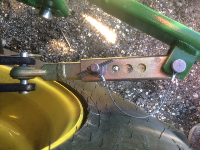

If you use two different hole spacings,,
you will be able to get adjustments of far less than 1/4" per pin move.
Example (I ain't saying this is right)
On the exterior part, use 1" spacing
On the interior part, use 3/4" spacing.
Adjust to where you want it, then select the holes that happen to line up!!👍
I have had my tractor since 1995,, I have never adjusted them
so I could care less if they were welded.
I doubt they have been moved in the 35+ years life of the tractor,,
at least, they do not look to have ever been adjusted,,,

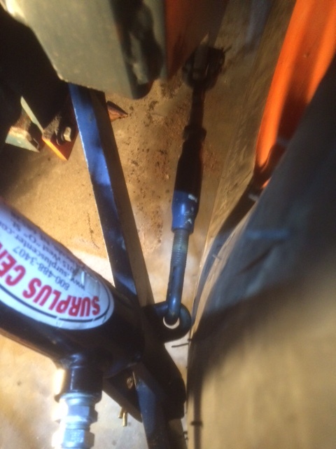

Below is probably the worst system EVER devised,,
inside the arms, turnbuckle chains.
A chain has to be un-pinned, and removed,,, to remove an attachment,,
or, the arms must be left VERY loose,,, :confused2:
Vernier hole spacing.

And here are some photos of my B9200 HST 4WD showing the existing arrangement (yes, there are some non OEM components currently in use - the shiny nut and bolt in place of the stock pin and split pin) as well as the location of unused mounting holes (circled in red - apologies for the yellow debris that's lodged in the middle of the three holes beneath the PTO, I didn't notice it while taking the photo) that could potentially be used for mounting telescoping stabilizers inboard of the lower arms as well as a simple depiction (a crude red line) showing approximately where I believe a telescoping stabilizer could be spanned. I also include a cropped image (blurry) showing a close up of the three mounting holes beneath the PTO).
