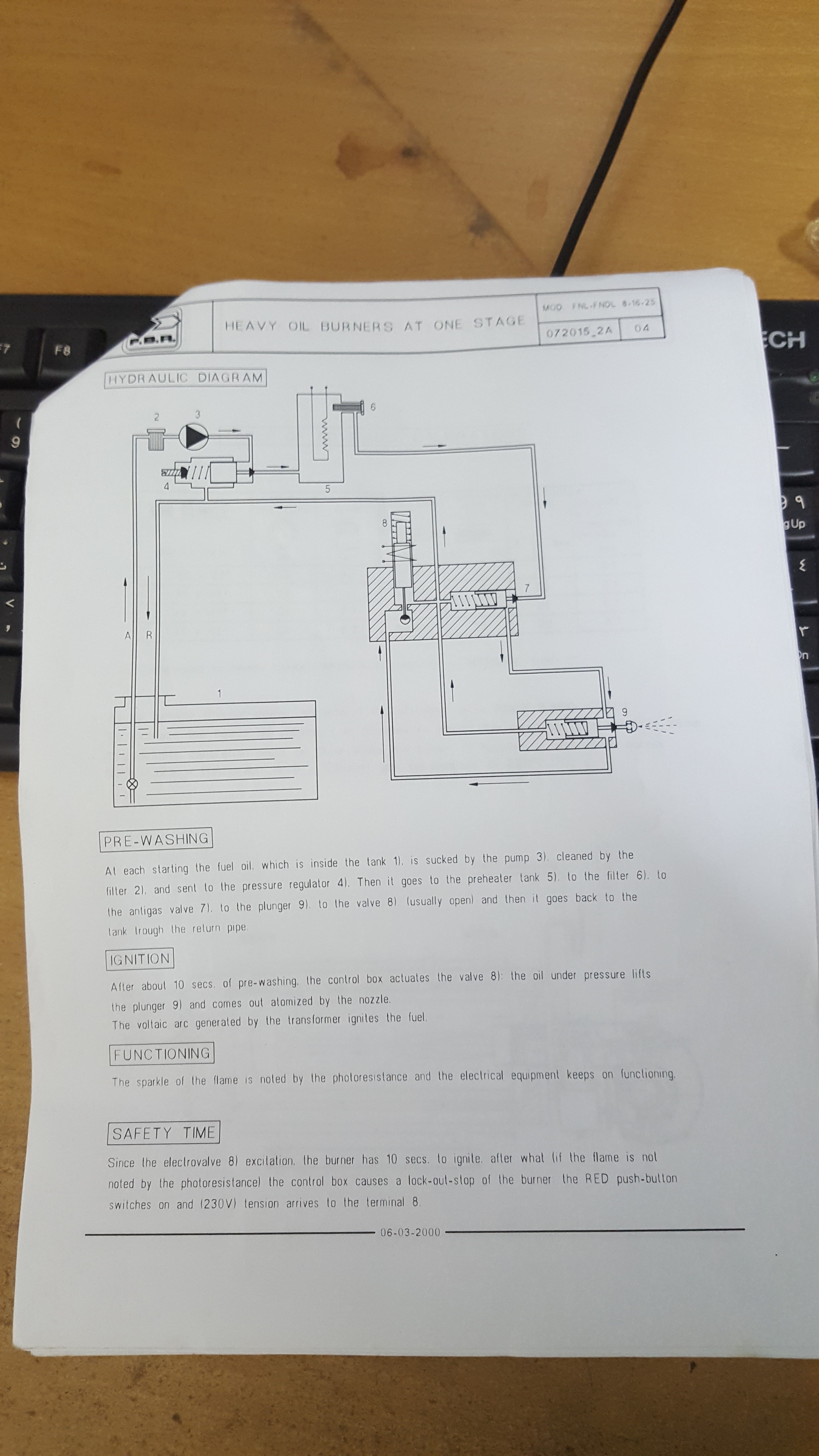

Hello folks,
Need help understanding this diagram ( how the fuel is running ), more specifically with YVA, YVU, and YVN1. It's a diagram for a heavy fuel burner.
YVA => anti gas valve.
YVU => Nozzle valve.
YVN1 => Solenoid valve.
Any help is very much appreciated. I will post another alternate diagram for the same process if needed. Thank you for taking the time to look at this. Cheers.

I am not sure what you are asking here? The flow path is clearly laid out on the diagram. YVA and YVU appear to be pilot operated valves. That require a certain amount of pilot (incoming) pressure to overcome the spring to actually open and allow flow.

What problem are you having? The arrows indicate direction of flow.

Those look like standard hydraulic schematic symbols, both valves are shown closed with solenoid coil NOT activated - think of the boxes as a sliding spool valve (they usually ARE) - so when the solenoid is energized those boxes will slide up, enabling flow. The Arrow on the flow path indicates that this particular valve also incorporates a check valve for DIRECTIONAL flow -

What happens with the flow when it reaches YVA ( Anti-Gas Valve ). YVA has 3 lines connected to it ( 2, 1, and left side/spring symbol ). The fuel is coming in at terminal 2, does it go out from the left side or from terminal 1? Furthermore, what is the role of the dotted ( pilot line here )?
YVU is the nozzle valve how is flow coming to and out of it?
2) After YVN1 is excited, how is the flow affected? The fuel is supposed to come out of EU1 now, how does that happen?
For there to be fire after burner starts, the fuel needs to come out atomized from EU1 ( the nozzle ). This happens after the solenoid vale ( YVN1 ) is excited which happens a short while after the burner starts. I'm basically trying to follow the flow ( from YVA forward ) of the fuel before and after that point.
Please note that I have zero experience with hydraulic diagrams, but some experience with electric diagrams.
Side question, how does the pilot/dotted line behave before and after YVN1 is excited?

Here's my interpretation:
Fuel flows into port 2 of YVA. It cannot go anywhere till that valve switches. It switches by pilot pressure. That's the dotted line going to the right. Once a pressure is reached out overcome the spring on the left of the valve, it switches. Then flows into port 1 of YVU. Then it's the same thing. Pilot operated.
YVN1 appears to be a normally open valve returning fuel to tank. Until some condition is met that the solenoid activates and closes it off. THEN it can build pressure and switch YVU via the pilot line.
The line coming off the spring side of YVA and YVU is probably just to return valve leakage back to tank

What I understand from your post is the following:
Fuel comes into YVA port 2 and builds up there. Pressure through the pilot line causes valve to open and fuel comes out of port 1/YVA.
Now, fuel continues and goes out of open solenoid valve YVN1 to return to tank ( SEA ). When YVN1 closes, fuel builds up in YVU and comes out of port 0/YVU then continues to EU1.
Okay, regarding vales, what about the third line ( coming out of left side )? There's no flow through that line?

Here is another diagram for the same process with explanation.
/ need help with diagram
#13
Reading that word for word gives one helluva explanation
Okay, with the functionality out of the way, it's time for the troubleshoot if you're up for it:)
First of all, YVA, YVU, and EU1 are supposed to be one block as indicated by the dotted line.
