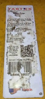

It's definitely County Line. Though, the manufacturer decal on it is something else:
"Tarter Rotary Tiller Yellow 5 Foot"

/ Need help understanding PTO shaft designs
I just spent some time reading the manual for the Tarter 5' tiller. It's the brand that TSC sells, and apparently also goes by the King Kutter name. The manual very clearly shows what you described... the female (outer) shaft connects to the tractor. I looked up some YT videos on the same tiller, and all of them (including ones on how to shorten the shaft) show the same thing.
So I don't quite understand how this tiller has the outer shaft on the tiller. For about $150, I can get a complete replacement shaft (with new slip clutch and full covers). I'm gonna play with it some more tomorrow to make sure I'm just not going crazy... and failing that, I'll order the new shaft.
The tiller lists for $1500 new - so putting 10% into it to get it going (assuming nothing else is broken), doesn't seem unreasonable.
Make sure that's not just a regular PTO shaft. Your tiller goes into a gear box, not a splined shaft, so you would need to take apart the universal joint on the tiller side.
/ Need help understanding PTO shaft designs #11
That's correct. I doubt you will find a shaft including clutch for $150. There are sources for 1/2 shafts. You could also shorten a regular male shaft if that's all you can find.
