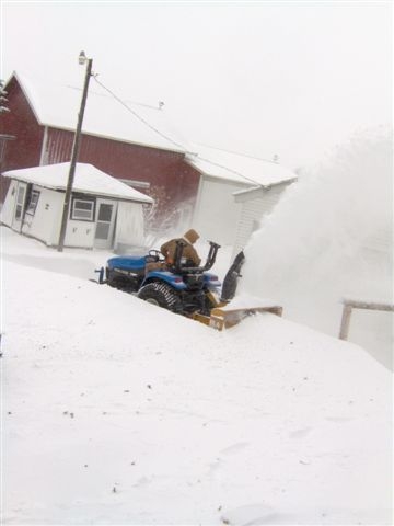

In very dense drifts, my 5 ft Lorenz blower was needing all the power my NH TC33D tractor could muster and I was barely moving.
