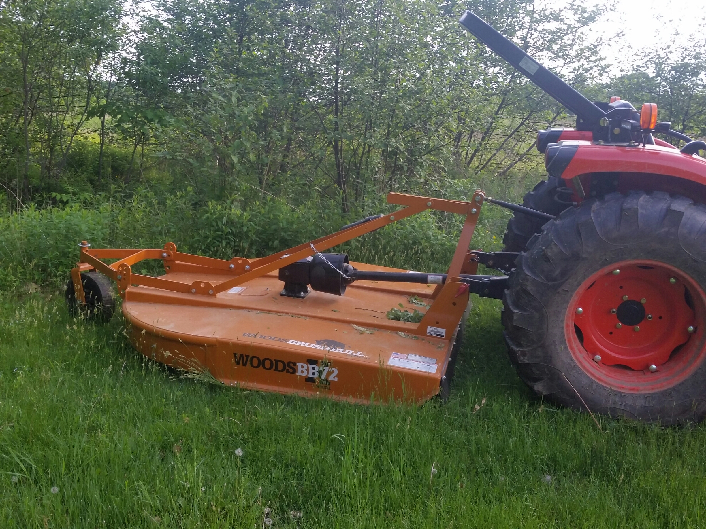

Just an update for anyone interested. Sold my finish mower on Saturday, picked up a 6' Woods BB72X Wednesday, and mowed 3 to 4 acres today. So far I am very pleased with the cutter. I set it for a 3" cut and went straight to the tallest thickest grass we had and it chewed it right up, the same spot would have bogged the finish mower down easily. Also I ran the finish mower at its highest caster setting, about 5". It's still early but so far I am happy with the cutter and glad I didn't go with the 5' cutter. It seems to be well matched to my tractor as far as weight and size.
I have the BB60x version on my DK40se. I use it only for thick brush and it does a great job with brush that would strain my flail. Only reason I didn't get the 72 was that I found the barely used 60 on CL. If buying new I'd definitely get the 72.
