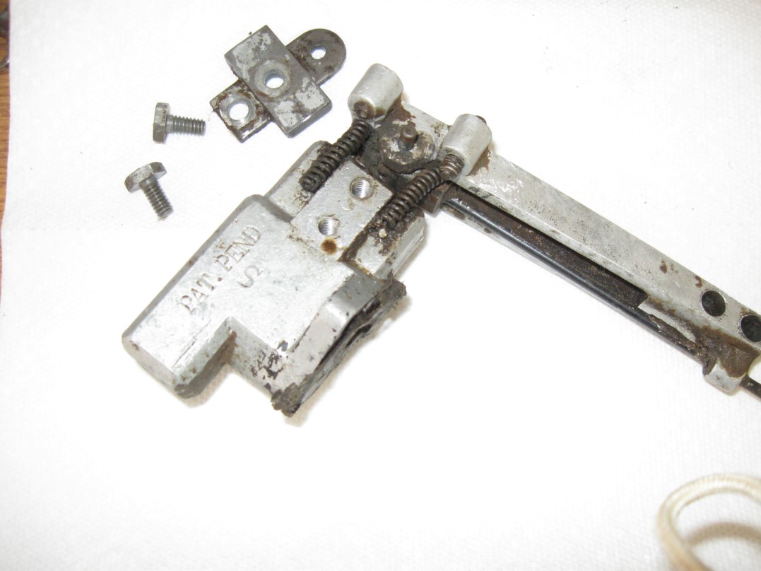

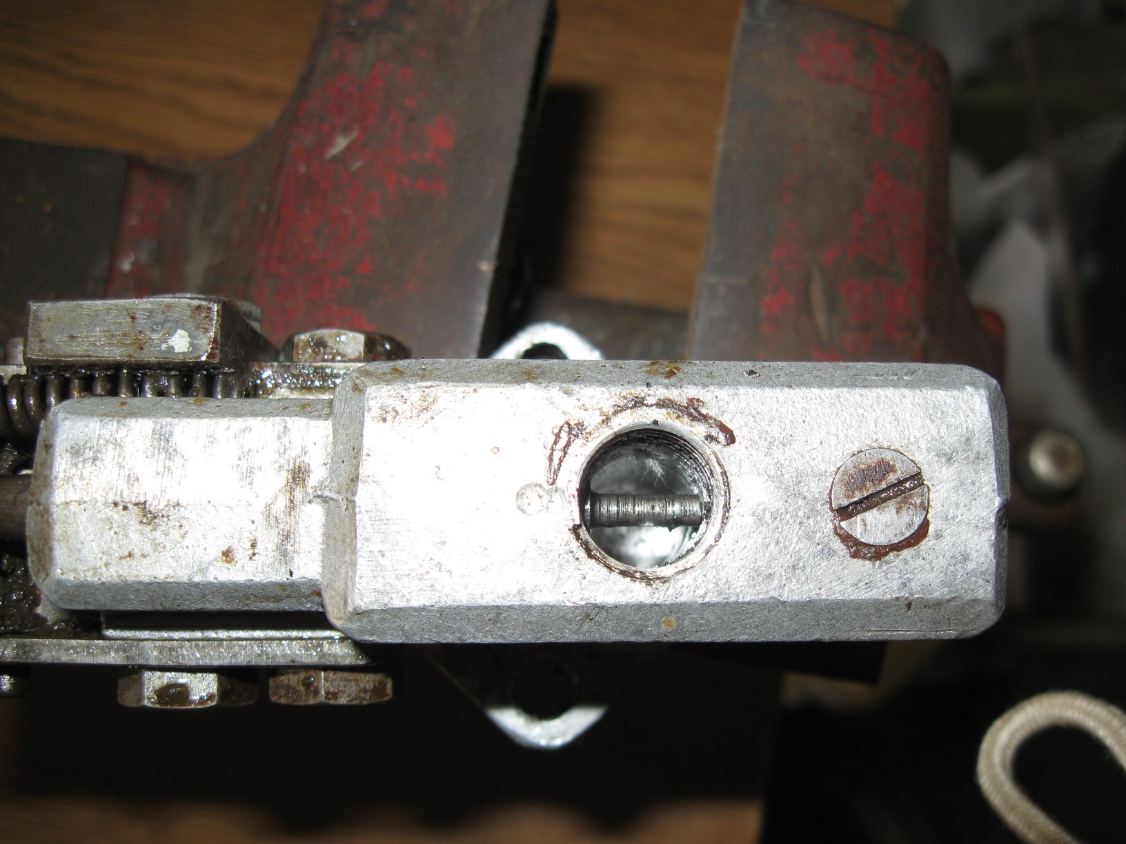

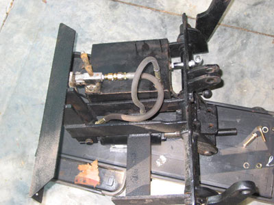

We have a Newgren lift on our 49 Willys CJ3a. It provides hydraulic lift for standard 3pt implements. We were testing a new pump (another posting coming) and the control valve stuck. Couldn't lift. I took the lift off the jeep (it sits under the rear cargo area) and removed the control valve. It appears the return side plunger is sticking. I don't have a good (operative word) hydraulic repair shop within an hours drive, so I'd like to rebuild the valve with your help. I'm a rookie and there is no known documentation (other than installation instructions) for the lift and valve. So I'm hoping that with some photos someone (or many) might step me through the process.
The lift off the jeep is in the first picture. The "L" shaped control sets on top of the reservoir. The leg bolted to the control is moved by two rods. The top rod goes to the rear of the unit and jeep and the second rod is next to the drives seat. Pushing forward on that raises the lift, pushing back lowers it (gravity).
The next photo shows how the control sets on the reservoir. The next pictures show the "return" side (fluid back to the reservoir) plunger in the "out" and "in" position. I can move the plunger with my finger, but it doesn't move as easily as I think it should.
I'll post additional pictures.

You could try removing the spool and polishing it with some #0000 steel wool and diesel fuel.

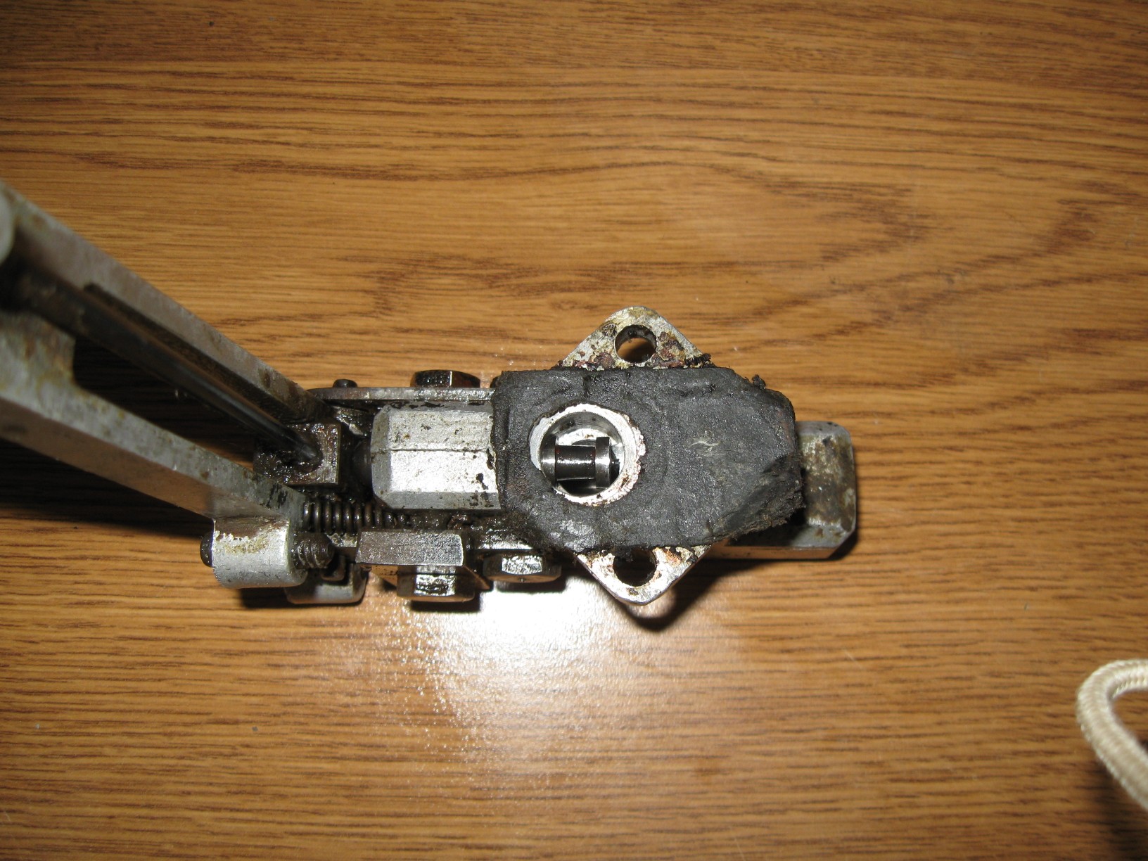

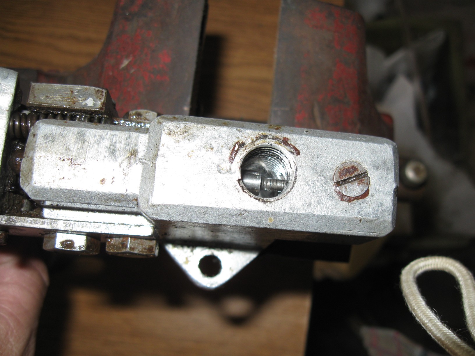

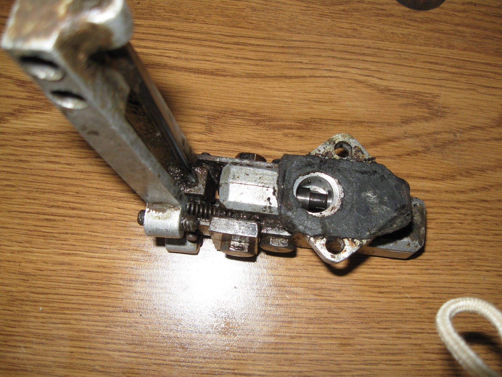

The first two pictures show the plunger operation on the pump input side. This plunger moves easily. The third shot is of the output to the ram. Beneath the screw (head visible on the fist two shots) is a steel ball.
I'm not familiar with control valves, so not sure what to expect when I start to disassemble. Should I be looking for "O" rings or seals? I may have to fabricate those or find something that will work.
How should I proceed? Just take the control lever apart so the plungers can be removed?
Any and all advice appreciated.

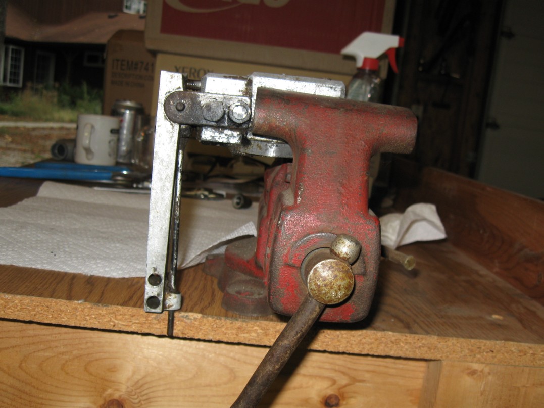

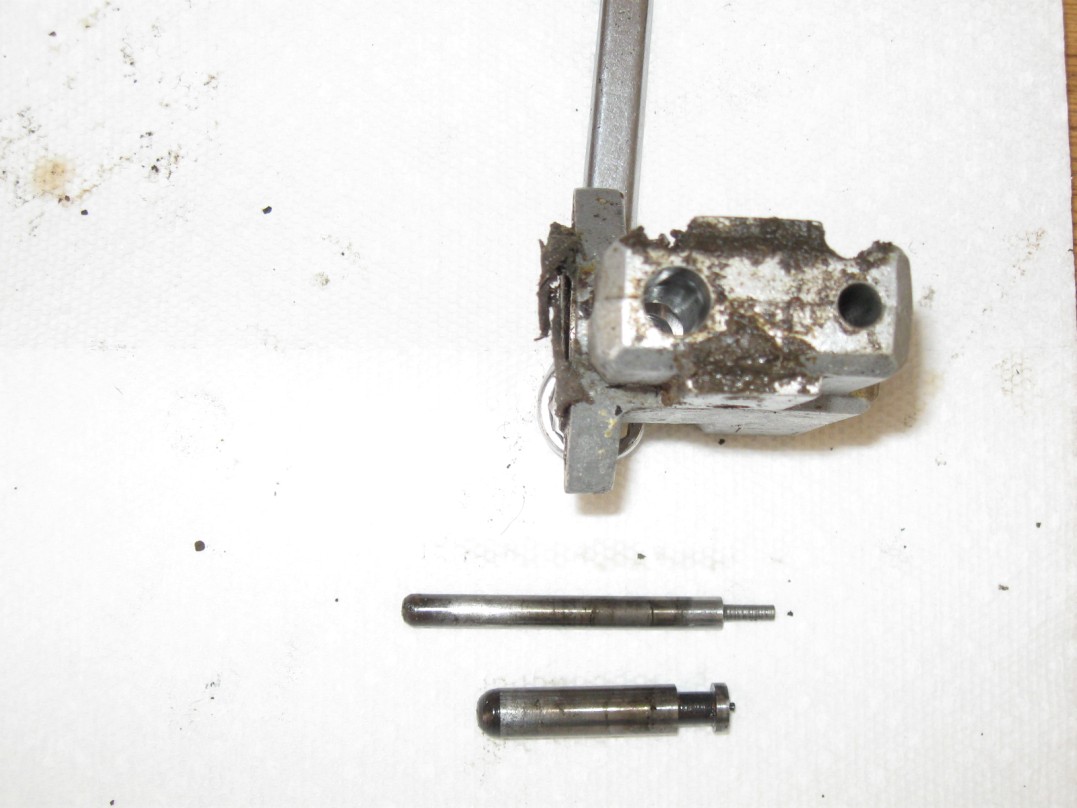

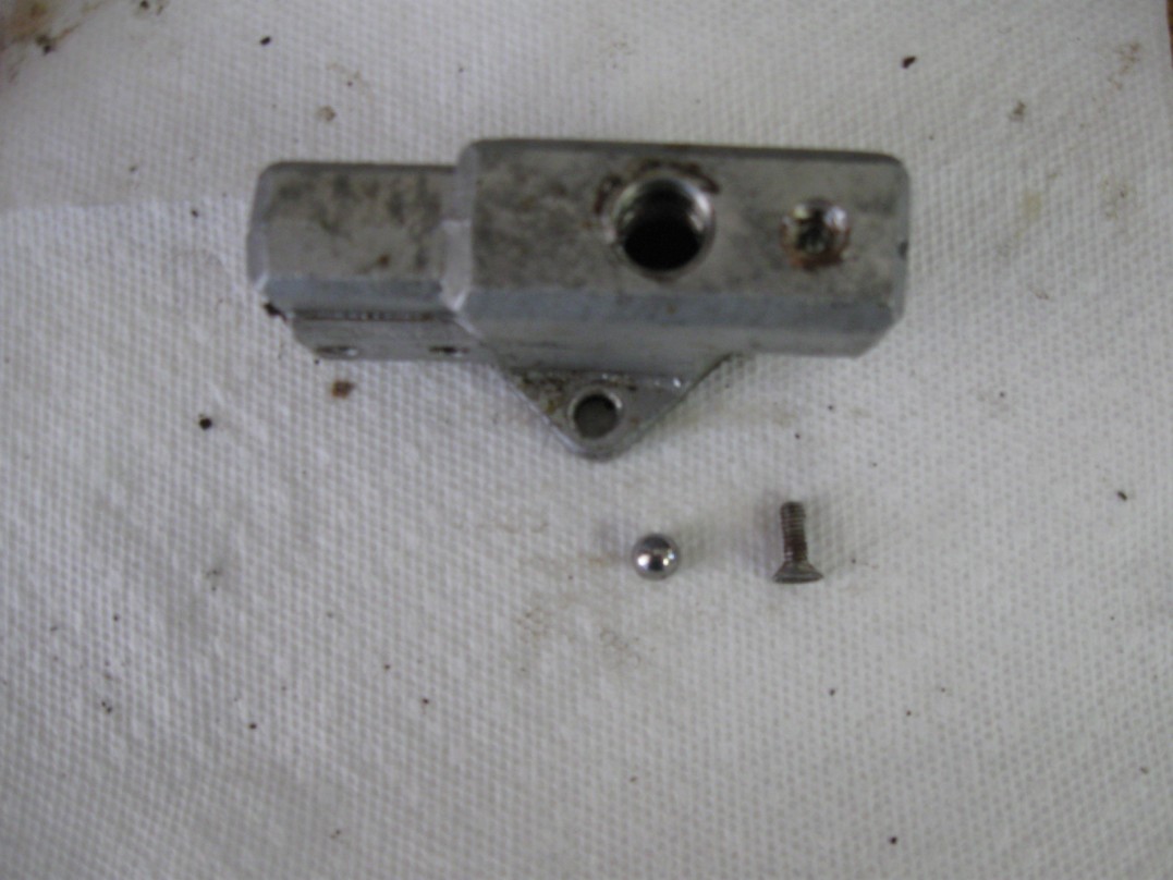

Here is the disassembled valve. I can't find anything that looks like a seal. Is it possible that none were used? What should I use to clean the entire unit? Diesel was mentioned earlier. Should I use air to blow the dirt from the body?
Sorry for the brightness of some of the photos.
Thanks,

Looks like you are making progress. And good pics too.
A good polish of the inside parts with close tolerances (try not to change them) would be recommended. I'd be careful with blowing things around inside the body but get it clean. Bothers me to see inside parts lying there with the 'outside' dirt. But I'm **** about that. :)

My mistake. I did move them to their own storage bag as soon as I took the pictures.
This thing is really small. I'm wondering how I should clean the inside. Don't know if a Q-tip dipped in diesel will leave residue. You can see in the fourth picture that both spools have very small ends. I haven't been able to see well enough inside the housing to determine what I'm dealing with. Next step is cleaning.

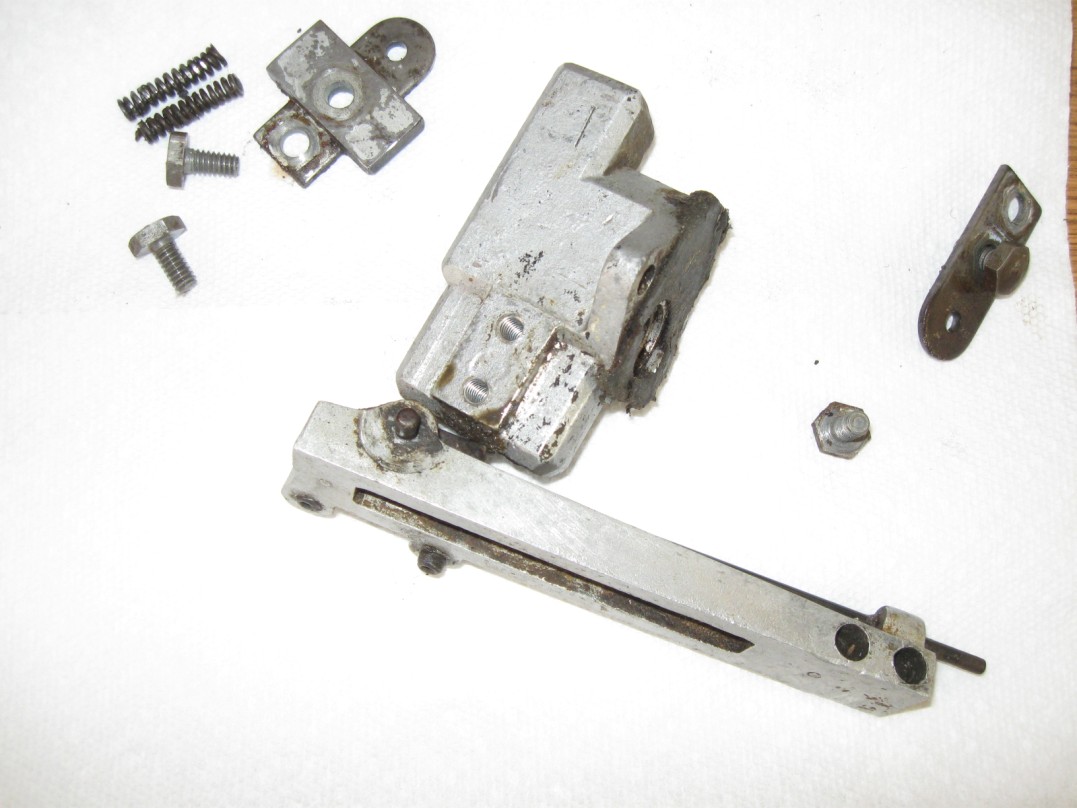

Most spool valves do not have "seals", the use very close tolerances between the valve body and the spool. The best you can do at this point is to polish the spool to remove the rust.

Regluar spool valves like mono block valves and stack valves DO have spool seals between outside and the return core, to prevent external leakage from the low pressure return core...
If spool valve are built into tractor transmission etc, no seals needed if oil leaks to the sump....

I didn't find anything that looked like a seal or "o" ring. Again, this is an antique and the installation instructions say some "small drops of oil" is normal. Here is the disassembled valve. I'm trying to locate the two small "return" springs. We don't have a local hardware store, so shopping for them when I'm visiting towns that do.
