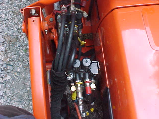

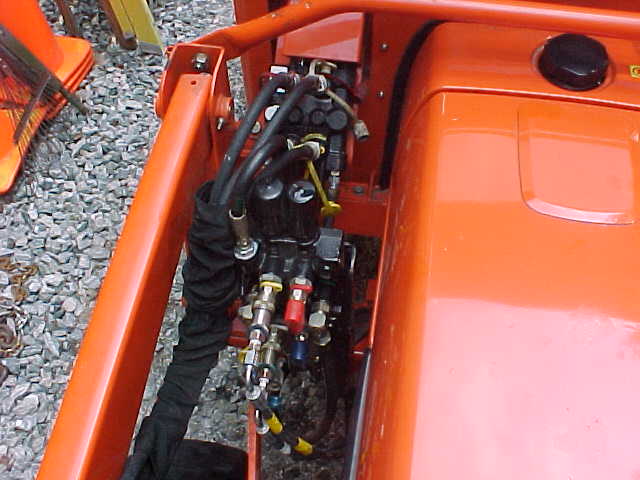

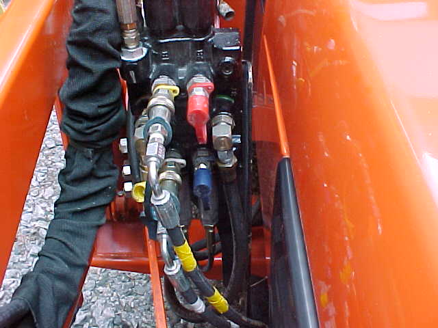

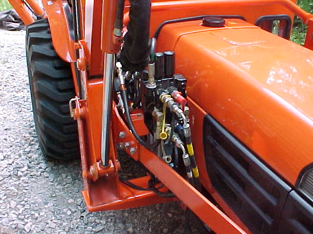

Everything works smoothly, no jerks or bumps. I'm now thinking about a hydraulic chute rotator for the snow blower.
This was a project that has frustrated me for the last couple of years. Having a house with a metal roof, I would get all the snow cleaned up and the tractor in the garage, and the snow would come off the roof, and I would need the bucket to move it. A real pain to mount the bucket again, now all the hydraulics are still hooked up and working, simple drop and attach.
This was a great Ebay find. A complete B3030 quick attach subframe (which I don't need) and all the hoses, brackets, loader valve and controls.
AND, thanks to you guys here, an easy install for someone who didn't know diddly about hydraulics!
Regards,
Rick

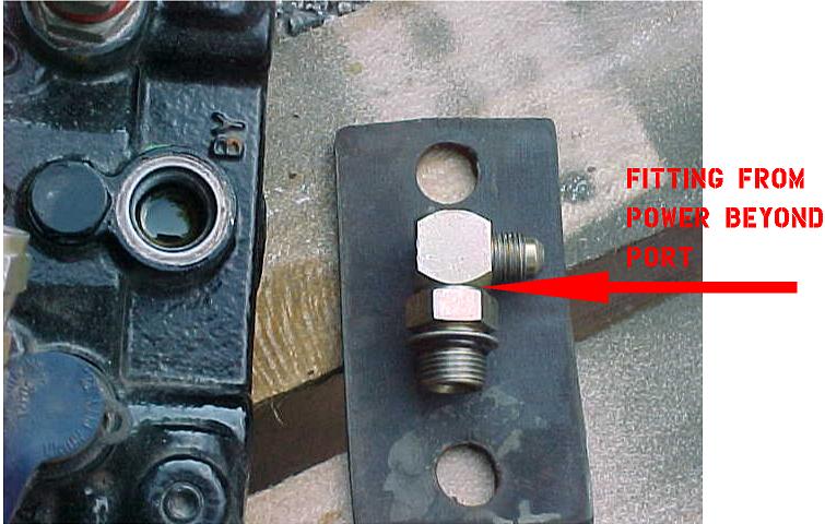

Well the weather finally warmed up so I could get going on adding the hydraulic control for power angling the snow blade. I said I would get back to you. I ordered everything from Surplus Center including the two circuit selector valve. I used 1/4" hose for the blade as we had discussed and that seems quite suitable. I mounted the valve and connected all the hases and wired with a SPDT toggle switch. My initial testing seem to go well. I was able to curl with the Kubota control and then I tried to angle the blade.
When I angled left it went quickly, but not bad. When I tried to go to the right, no go. If anything it was still trying to go to the left. I double checked everything I had done.
My opinion is since all works well in the first circuit (bucket curl) then the only possible problem is a defective selector valve. I am looking for a second opinion. Actually I'm looking for some suggestions.

What you are experiencing is a common problem on the Kubota FEL valves. What's giving you grief is what is called the "regen" or "regenerative" function on the valve-some call it "fast dump" also. Basically what is happening is both hoses are being pressurized when you push the joystick left only a little bit. To get past this feature you must push the joystick further to the left past the detent and blade should then angle properly.
This has given people with plow's and snowblowers(the chute rotation) fit's for a long time. Why Kubota put the regen function at the first part of the joystick throw is a mystery to me-most tractor's it's in the farthest position to the right. Also putting the split brakes on the same side as the HST controls is another mystery also...
For a more detailed explanation, view THIS thread, and for even more info and to read other threads about it do a search on the word "regen"

No , I do not think that will work because there will still be no weight to pull the cylinder like there is with the leverage of the bucket wanting to fall. It's just like the guys with the snowblower chute rotation cylinders if you read any of the threads after searching like I suggested above.
I am now betting you have a 3-way valve like Kubmech explained in the link I posted above...and now your only solution will be a new valve unfortunately. One like THIS would be perfect...
I know this is not what you wanted to hear-but I had kind of forgot about the issue with the older Kubota's (they are the only ones that used 3-way valves a lot and cause grief for many customers)
Try this please: reverse the hoses going to the cylinders and see if it gets "stuck'" the other way...If so then your only option is a new joystick valve, or forgetting the diverter idea and goes with a separate remote valve-either electric or manual.

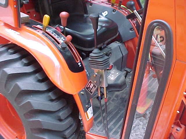

The valve I was trying to use was Surplus Center # 9-5117.
I have ordered their # 9-6765 to use in this project. It is a single spool, open center and spring centering. Now I'll have to figure where I can mount it.

The second try was a success. Everything works very well. I managed to mount the new control valve so it's easily reached from the seat. Thanks for you help.
