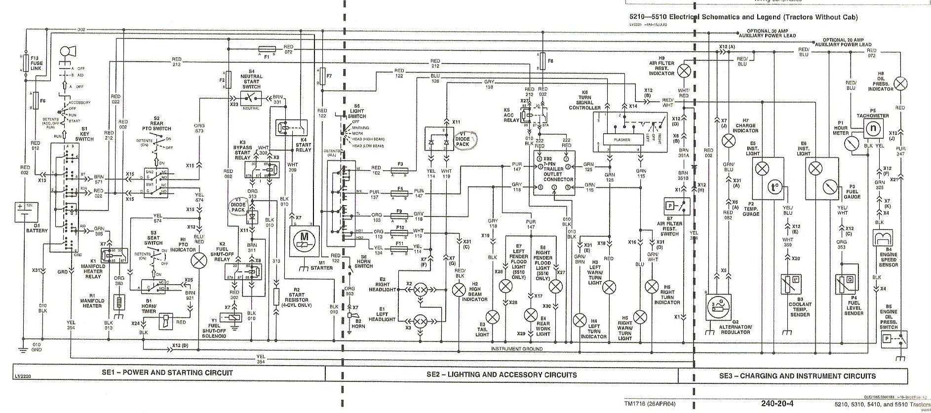

I have a 5210 which also has a 3029 engine. It has a manifold heater, the manifold heater and the air preheater for the 5045E use the same relay AL81719. The attached wiring file is from the tech manual for my 5210 and in this case to me is the same for the 5045E and what you described is the same. 385 is the green wire to the key, 383 is the orange wire, the black is the ground and the red is the power.
I think you have it wired correct, what happened when you pushed the key in?
The following is from the tech manual.
System is controlled by operator only. No automatic control is used. When operator pushes in on key in RUN or START position, current flows through 30-amp fuse and across starting aid contacts of key switch. Current exits key switch on circuit 385 and travels to terminal 86 of manifold heater relay. As current passes through windings of relay, a magnetic field develops which pulls relay contacts and connects terminals 30 and 87. Current then passes from battery through circuit 002 and to manifold heater.
