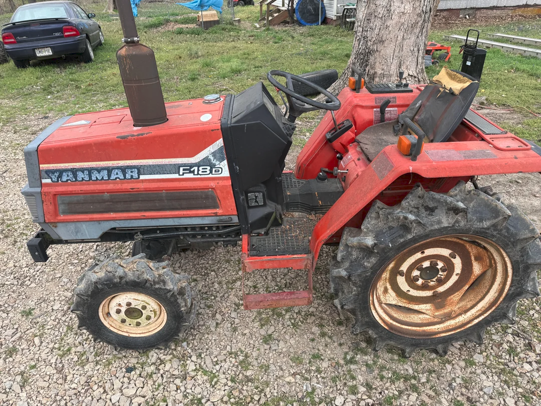

Yanmar f18d

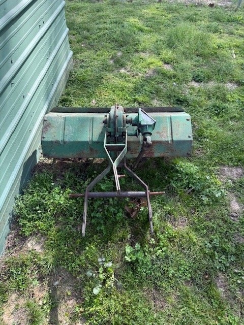

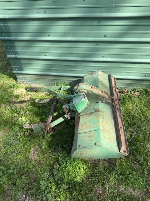

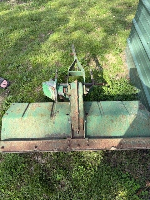

I need help identifying the make and model of this tiller. I need some parts for it. What grease should I put in the chain box?
/ Need help identifying this tiller #2
For the grease, it would depend on the chain and bearing system inside the drive housing. Cornhead grease is semi-liquid and a semi-grease very suitable for rotary tillers. TSC, Farm&Fleet, ASC, Farm stores and Coops all carry this.
As for the gearbox, 80W90 or 75W90 synthetic works very well.
This rotary tiller looks to be a CAT-0 or adaptable to CAT-1 use. Cub Cadet, Wheelhorse or many of the GT lawn tractors with a 3-point life, not sleeve hitch, would operate it.

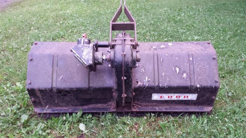

I assume you posted this on Reddit and it has the Yanmar F18D to power it then.
The YTOG has the manuals for the Yanmar. (y)
/ Need help identifying this tiller #4

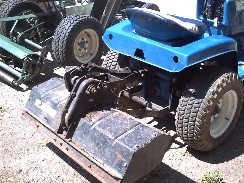

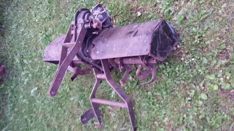

It took lots of hunting for this tiller.
Dumb AI image searches called it a JD31 fail mower. LOL
You have a Ford LGT tiller. Something very sought after.
The tiller was made for Jacobsen and Ford lawn tractors.
Yours has been modified nicely for a 3-point hitch.
https://www.gardentractortalk.com/threads/lgt-tiller.36211/
The Jacobson on a Ford LGT,

oh, I think I found the parts manual,
  • Jacobsen GT Tiller 36 in. 59734, 59844 Parts.pdf
Bmaverick. Wow, thank you so much for doing the research and finding out what it was. I really appreciate it more than you know I’ve been so curious about finding it and I have looked for several hours and couldn’t find it.
Yes I’m the one who posted that on Reddit. I have been trying to find the parts manual on YTOG but I’m having a hard time learning how to use the website I am not very tech savvy but I really am happy to be a part of this group and thankful to have others like you in here willing to help.
To find manuals on the YTOG, you need to login to the site.
Otherwise the manual section is hidden to the public.
When there, it's WIKI > Resource Page > Manuals
Manuals are hosted on our private cloud and on a second backup site tractorforum.com
There are other sites too, but you would need to speak the hosting country language in Greece, Poland, Croatia, Romania and Vietnam.
