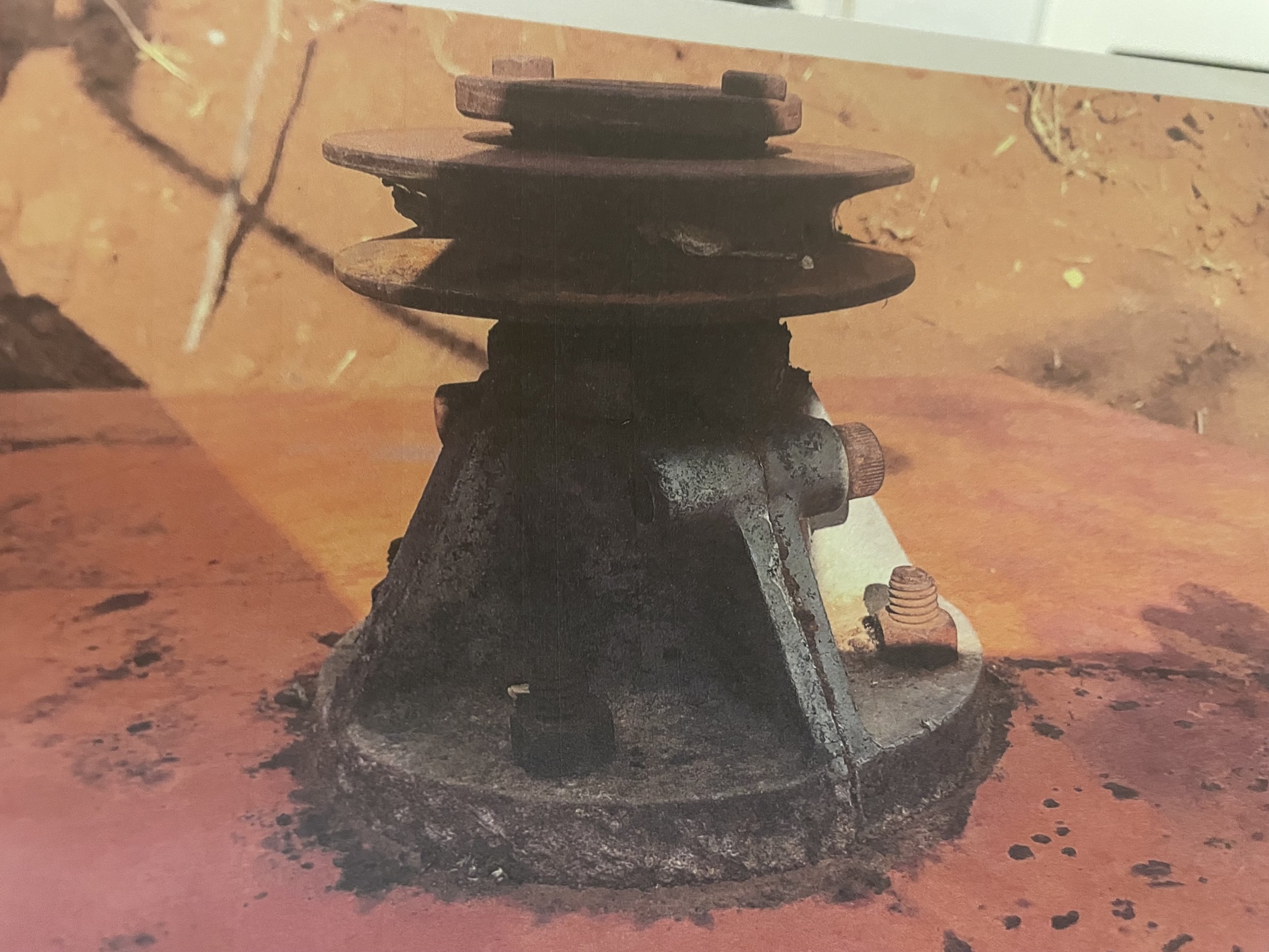

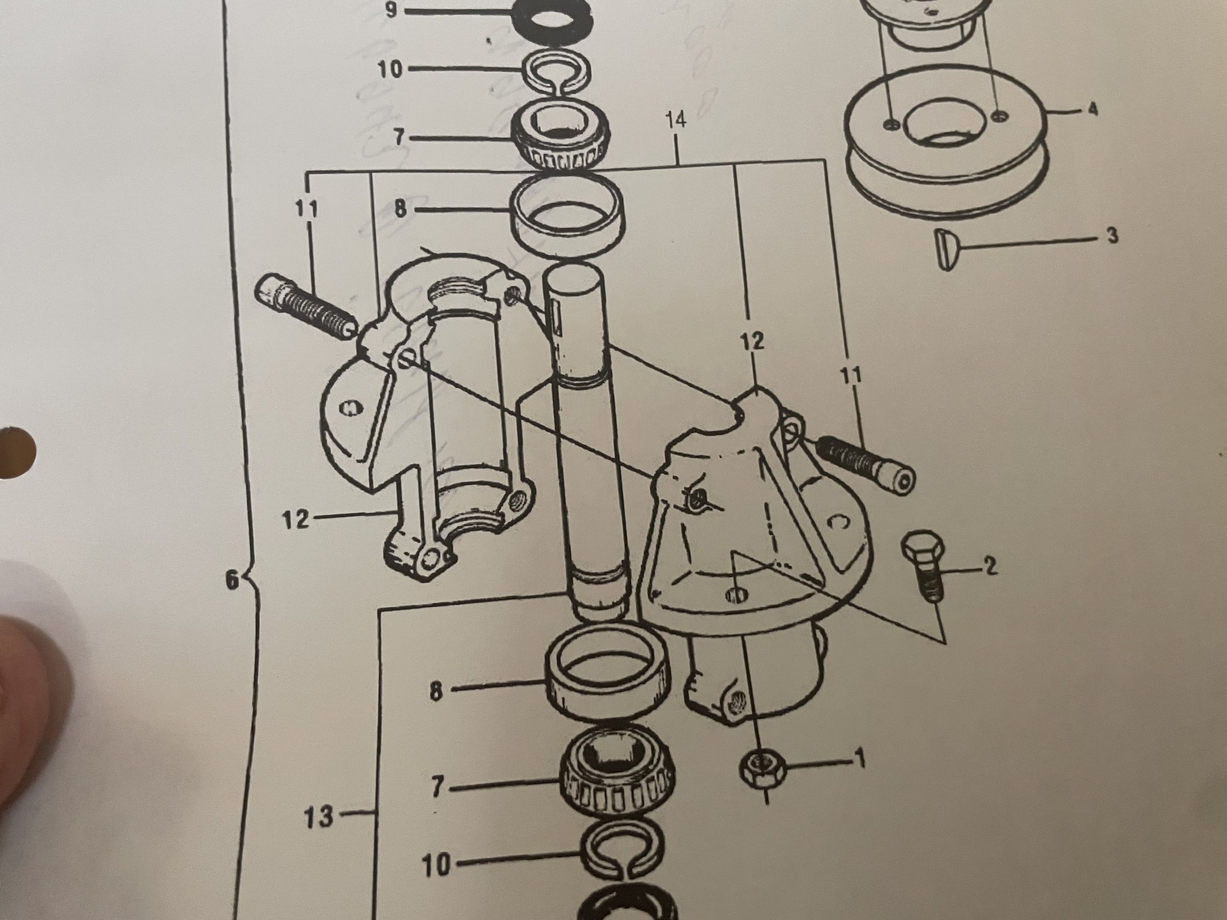

spindle was good, checked it on lathe and it was straight. Have a co-worker making a housing from some 2 1/2" stock, going to change it to ball bearings like the newer ones use. Tried to buy a housing but only available as an assembly which would cost about a grand canadian
   / Need help identifying broken Bush Hog mower #12

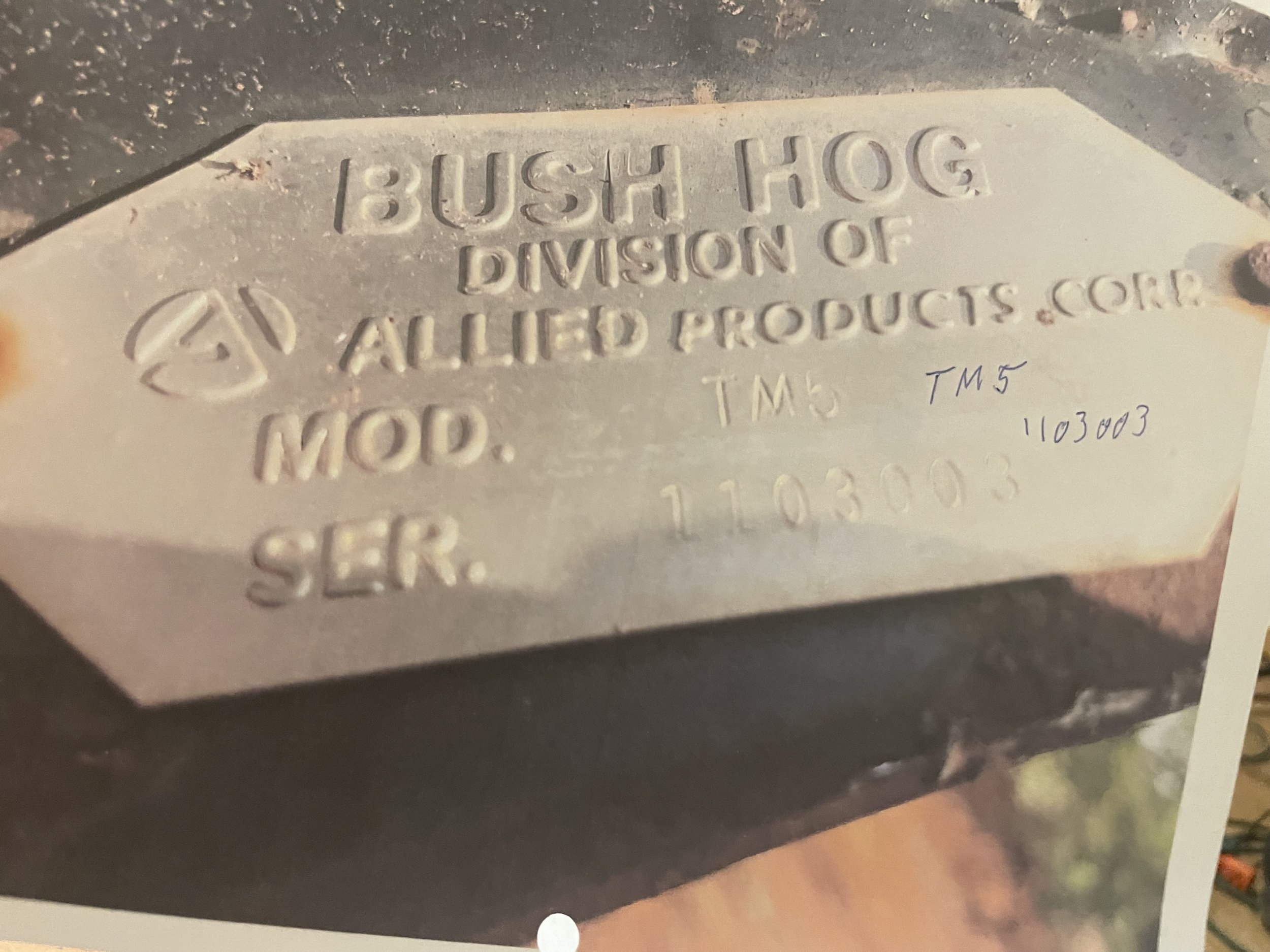

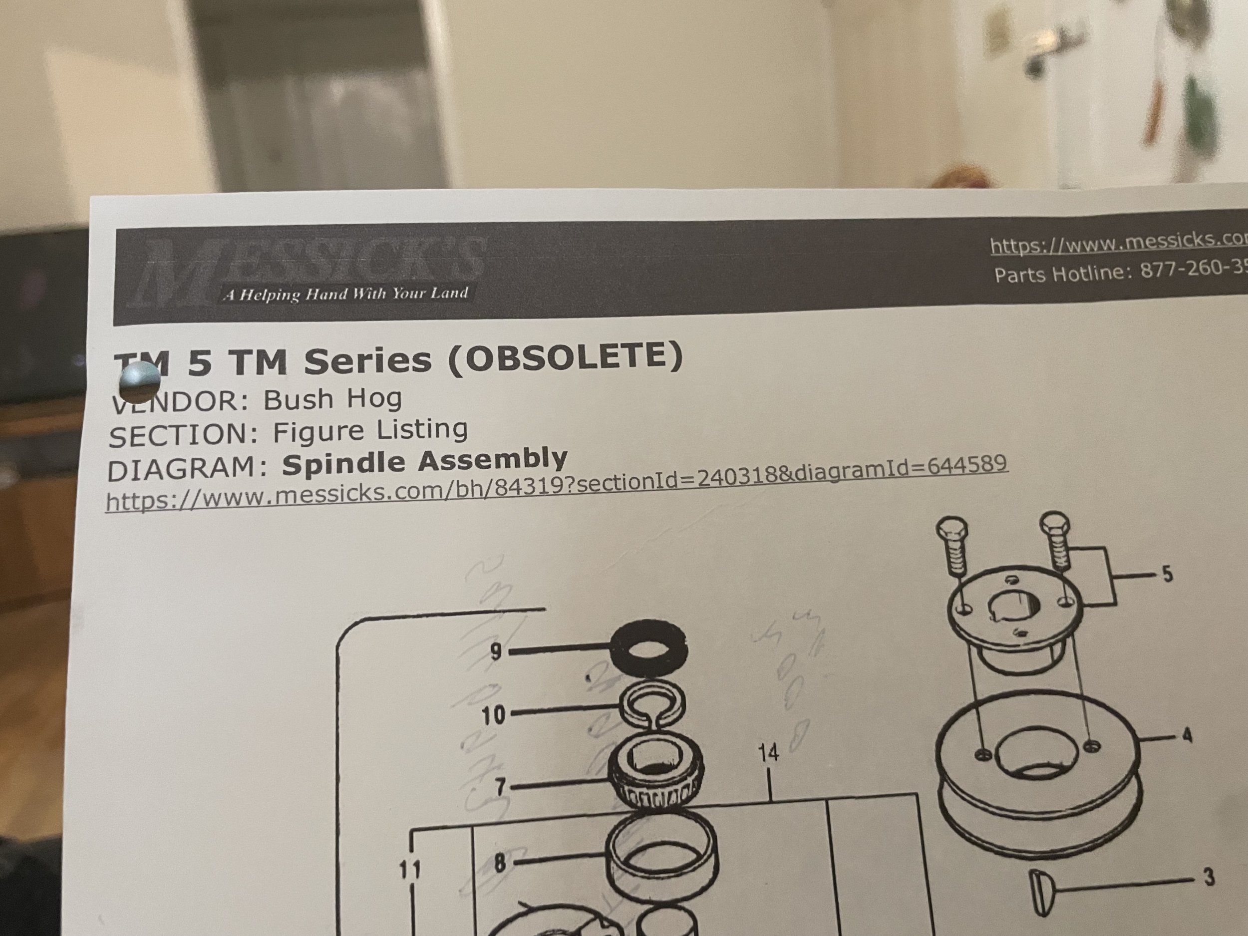

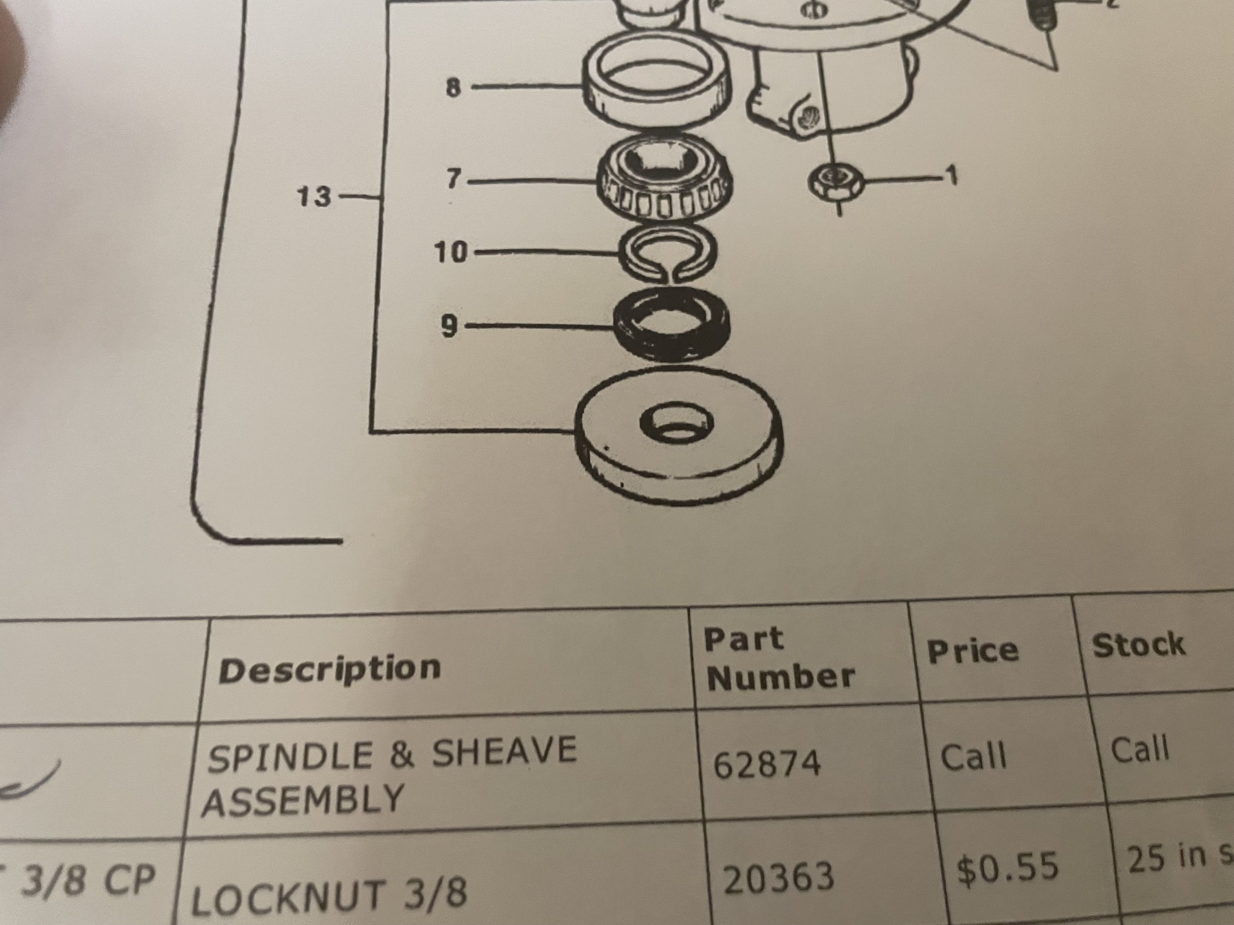

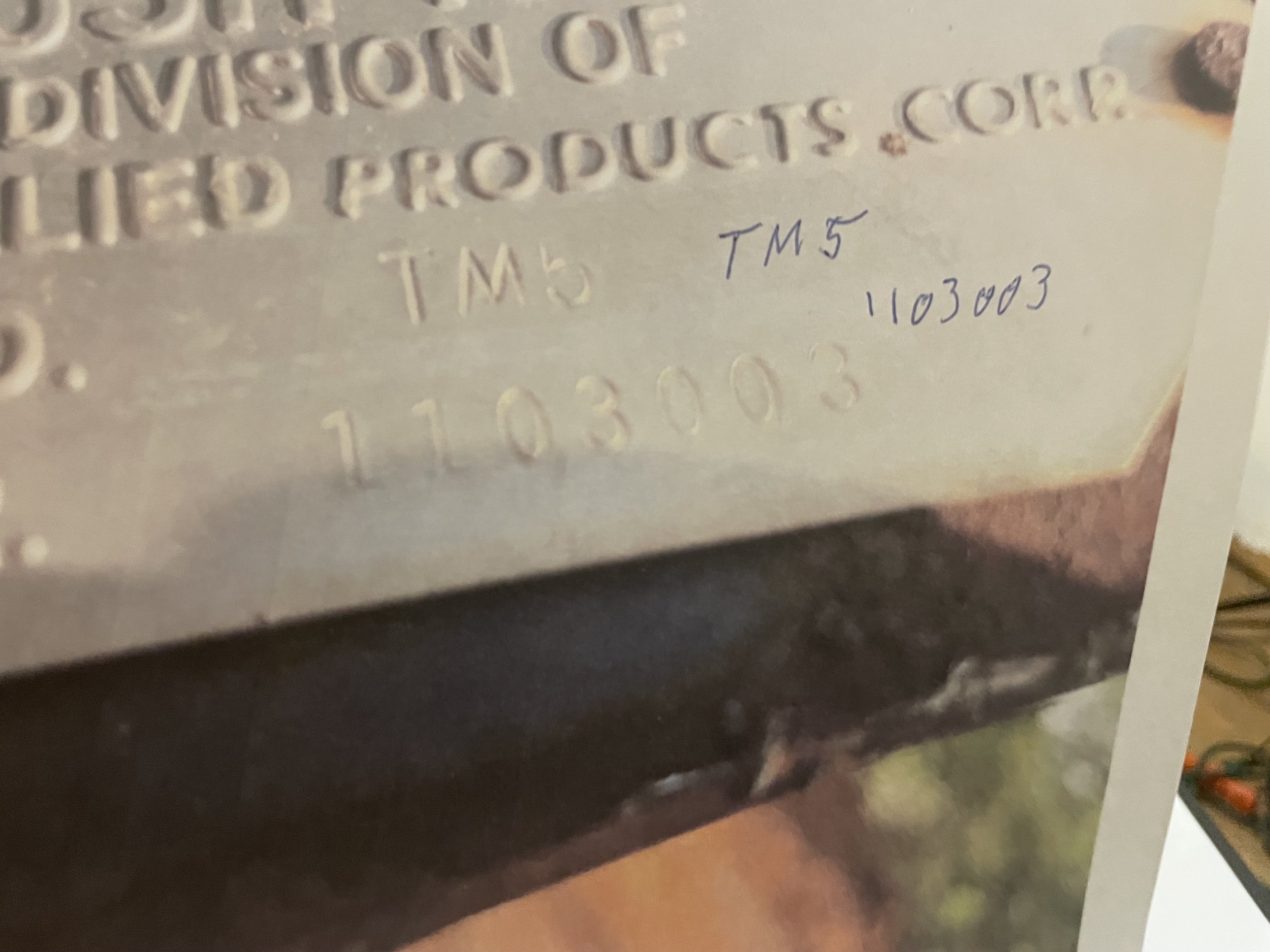

Picked up an old Bush Hog finish mower, it is a 5' mower and appears to be fairly old. Needs the usual bearings, blades and a belt, but it also has a broken spindle housing. Need to identify the model so I can try to purchase a housing or come up with a way to fix the broken one which appears to have already been welded once

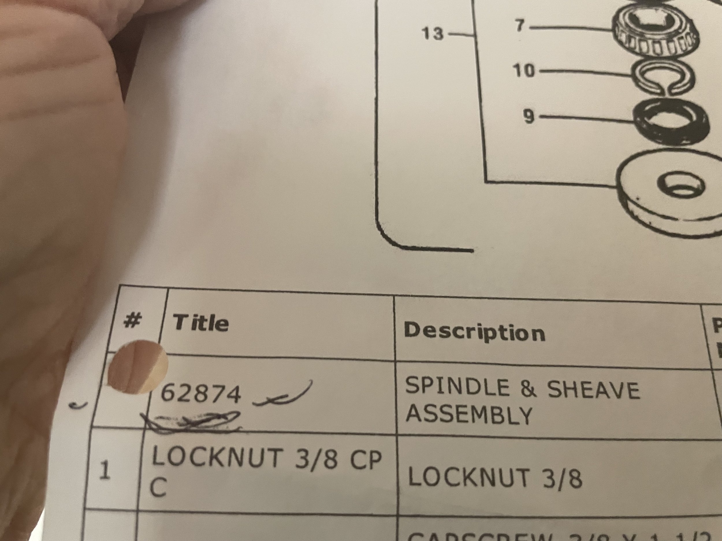

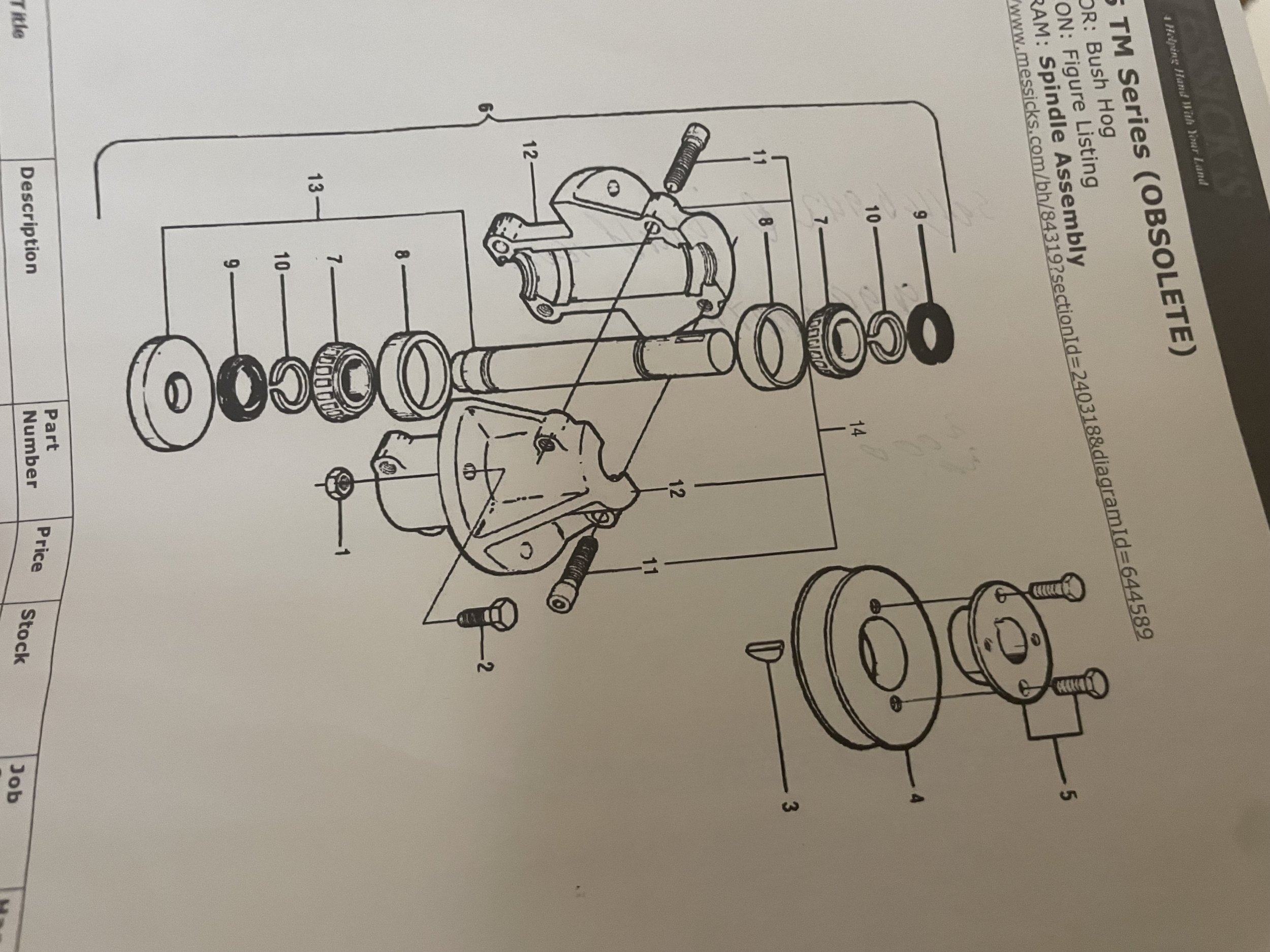

Looks like my Bushhog TM-5 Serial # 1103003 it is obsolete. It looks like I can buy complete spindles for about 52 a piece.
   / Need help identifying broken Bush Hog mower #13

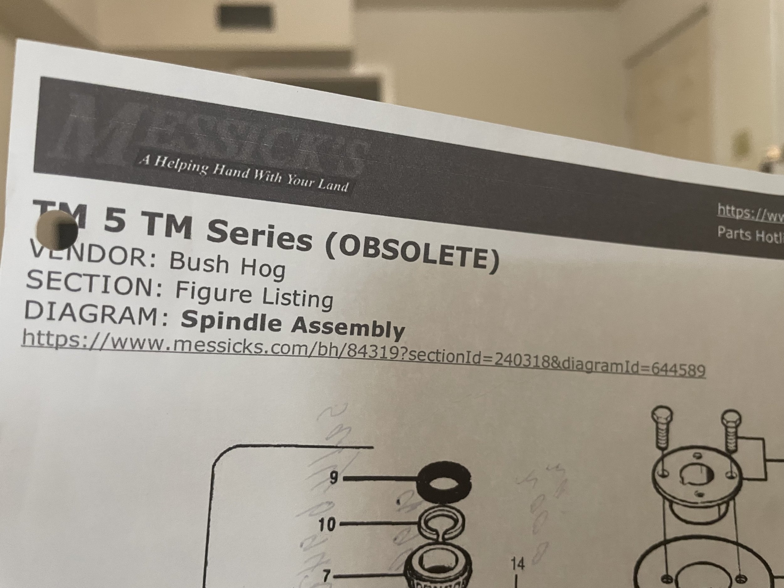

I downloaded manual from Messicks
The pictures are from my Bushhog TM-5 it needs total rebuild
That looks like the one I have with a broken spindle.
   / Need help identifying broken Bush Hog mower #16
Same exact one I have a TM5 and when the bearing went it destroyed the aluminum housing. At that time Messicks had a used one but they wanted $300 for it because they quit making them. Good luck trying to find one. I only paid $300 for the whole thing wasn't paying $300 for one spindle.
