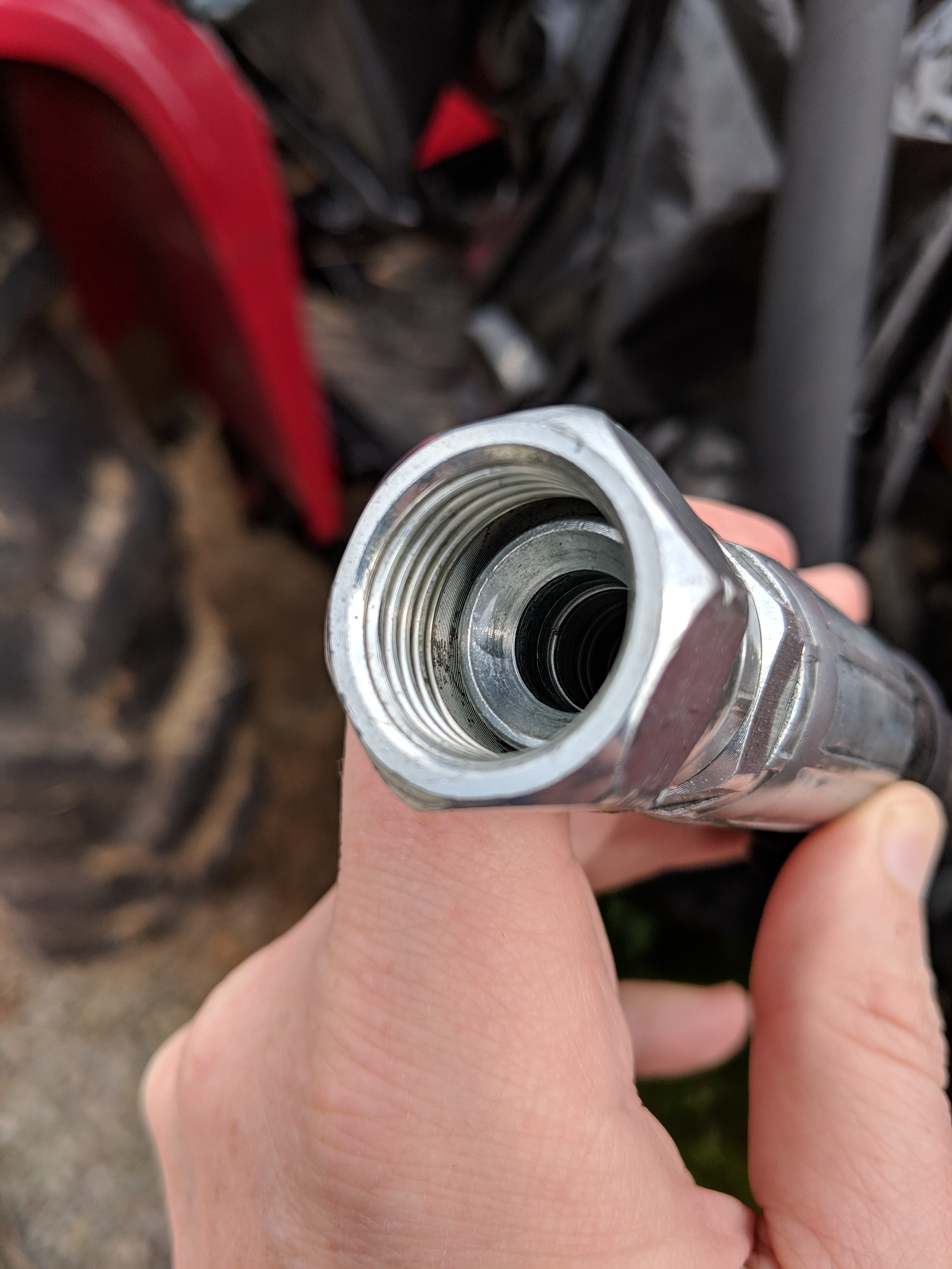

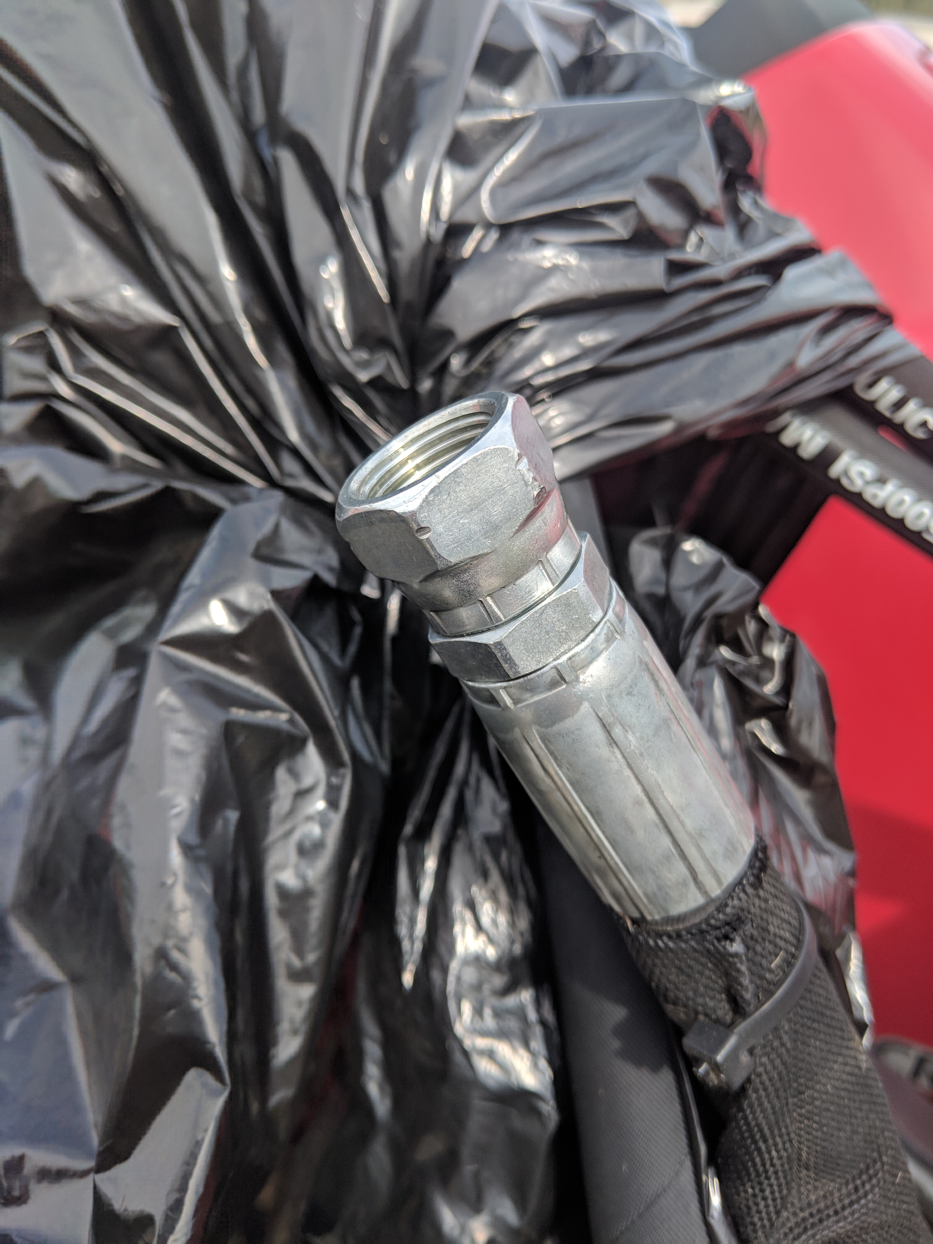

I asked this question over in the Mahindra section, but I'm not getting any response and my tractor is down until I figure this out -- so needing some help ASAP.
I'm setting up a hydraulic auger on my Mahindra 4540 Front End Loader and I have all the hoses and fittings for the new control valve, but I ran into one fitting that is different. This is the inlet hose that goes from the pump output to the input on the FEL control joystick. I think the control valve is a Besko model, but there is very little/no information out there on it and I can't figure out what fitting type/size I need.
Does anyone know what type of fitting is used on the Mahindra FEL control valve?
I do not have a good local hydraulic shop, so I have to order all this stuff online and shipping is killing me. I can't be playing the "see what works" game.
Here are a couple pictures to help...

Looks like JIC. Don't have a Mahindra so I don't know size. You should be able to find some sizing info online.

My guess would be #8 JIC which equals 3/4" SAE - NF thread. But guessing doesn't help you.
You really need some calipers and a thread gauge.
This might help.

Same thing he was told in the Mahindra section.....time to measure.
OP- a lot of local auto parts stores, truck repair shops etc have hydraulic parts. Hopefully their are local options to help you out.

A picture of the other side would have helped too. Flat, flare, etc...

This could also be 30 degree flare fitting. I know that it what is on my Branson. Totally different thread size than JIC 37 degree flare

Oldnslo makes a good point,( look at JIC, compared to JIS several pages later) and (for 3/4" size, anyway) the two are only about .002" different male thread diameter, so even a digital caliper wouldn't guarantee which yours is - check out both in the above guide, the bigger difference is the angle. I would hold a small straight edge against the angled part of the male, and find a way to measure that angle (see pics in the chart) - there's a noticeable difference in how steep a 30* angle is when compared to 37*.
Best I can offer, HTH... Steve
