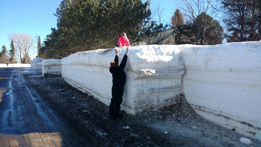

The bank on his road. With my wife and 6 year old for scale.
It is deceiving, because of wind the opposite side of the road the banks are half as tall.
That'd be my justification for a Unimog with snowcutter. Forget the tractor.

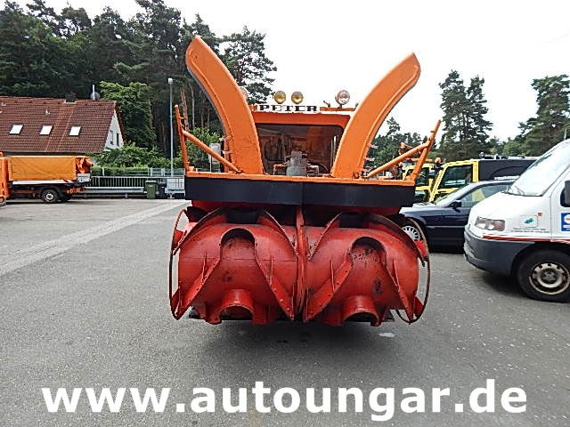

This would probably work ;)
