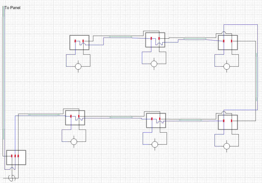

Is this What you are trying to say? Note that White wires are shown in BLUE and the Green grounds would need to all be connected together.

very good post a lay out of the room and i will try and help better .im a local union electrian for 26 years so i have some insite
Thanks.
When I first read your post I thought that guy is nuts, that will never work, or be a series circuit, so I started diagraming it. Turns out to be a good design.
Upon reading the the first post, my initial design for this circuit was that all the wires would junction in a central box, kind of like a star. The idea of the out and back for the hot wire didn't occur to me.

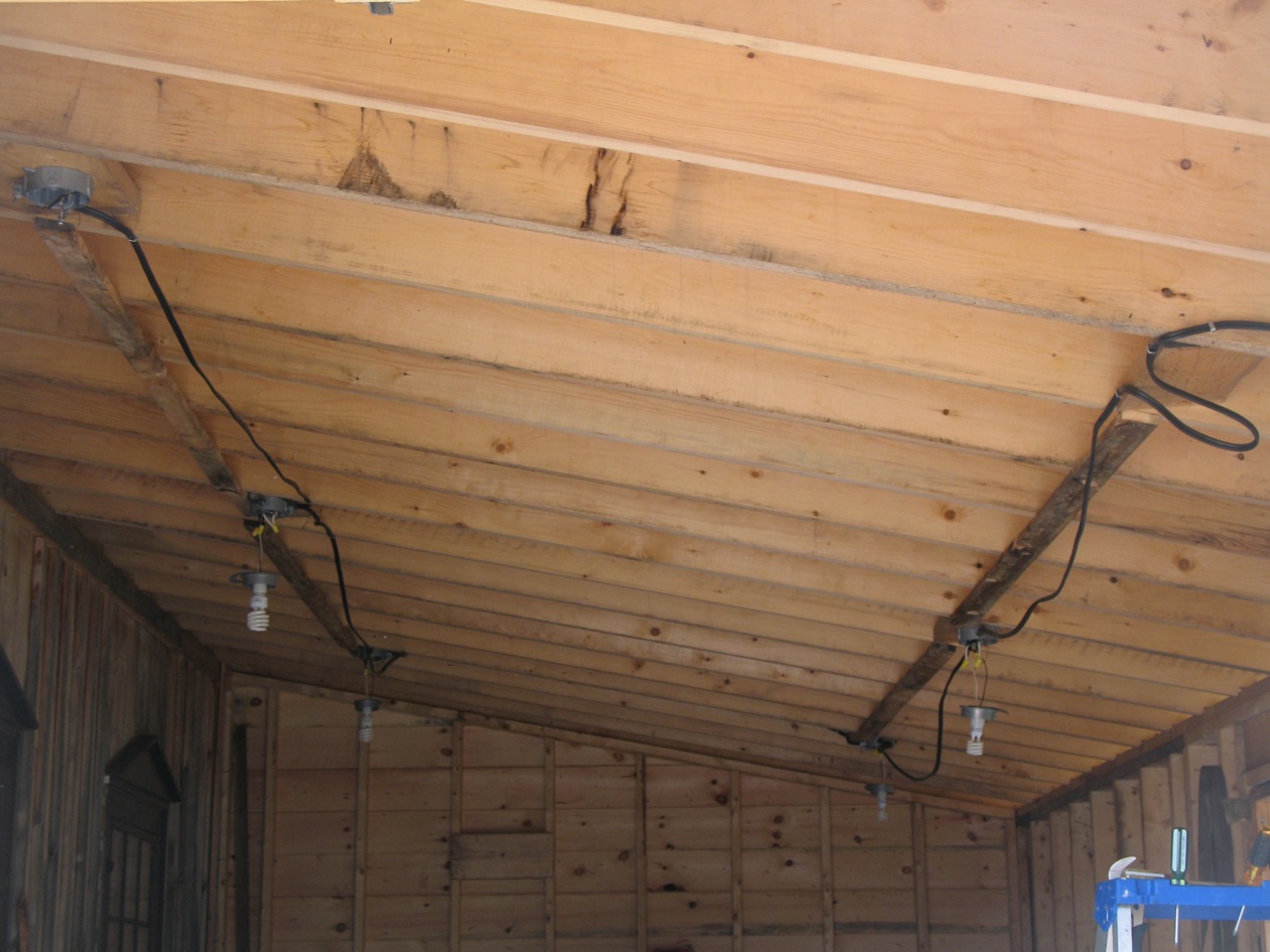

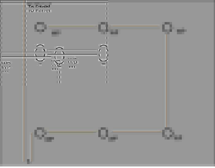

So I drew up a schematic: white, black and copper colour(ground).
Also, I have attached a photo of space. I also ran a wire from panel to switch but have not
hooked into anything. This is not in the photo.
So, I need to know:
1/ what wires get connected at the switch- it is single pole/regular house switch and yes there will be plate placed on it when finished.
2/ what wires get connected at each light fixture?
Note: the schematic is for six lights and I have 5 in place and 'am awaiting a 6th one to be delivered. I can wire that in at a later point.
Also ignore how the lights are wired now... Also, the wires will be stapled to the battens attached to the rafters.
I did wire up two weather proof outlet boxes from a circuit breaker and they work fine.

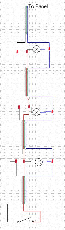

So, I need to know:
Based on what you've already done and how it appears wired in the photo, I created a diagram of how to connect everything up.
Lovemytoys: Would this be the easiest way to get this done?

Thanks Micropilot...
So if I read this correctly:
1: all grounds get connected - obviously
2: all whites get connected including light fixture
3: all blacks get connected including light fixture
4: switch gets black wires / whites get connected in box
I printed off your schematic and will proceed in the morning.
Again many thanks...
