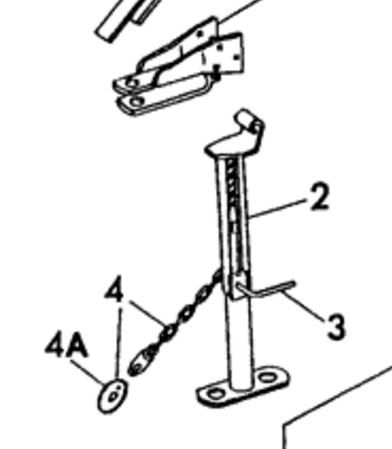

Well you said break-away. How about swing away? My New Holland rake has a swing away stand that sits over-center when its placed off the tractor. Can be held with a chain but not necessary. Keep it off the ground with a rubber strap.
I recommend a large foot on the ground line because a pipe or rod will soon sink into the ground at the most inop Rake_stand.JPGportune time.
