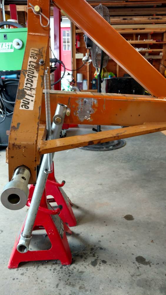

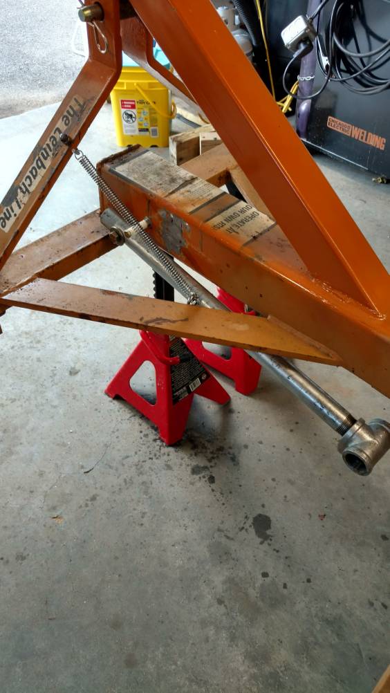

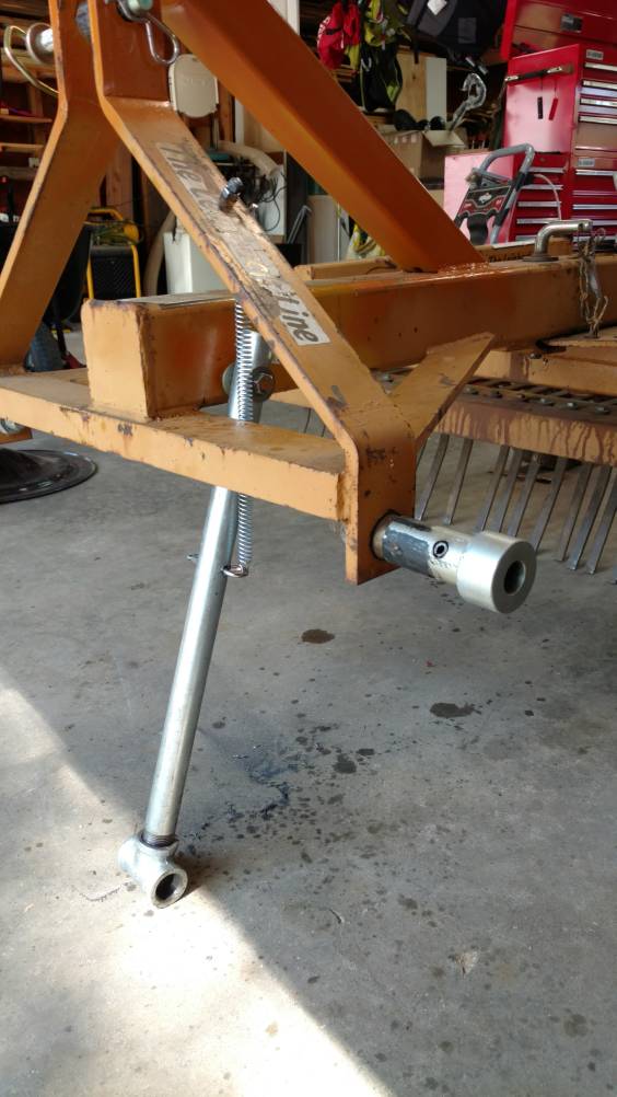

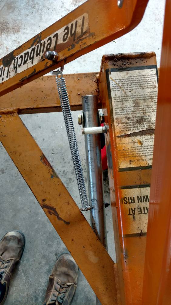

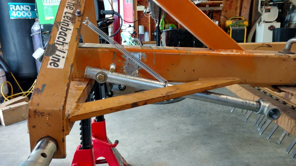

So I had my 3 and 5 year old boys by myself today which means no seat time. I wanted to get something done in the shop they could "help" me with. That means no welding and limited grinding.
So I set about to cobble together a 'snap-over-center' kickstand with what I had on-hand. (turned out the screen door spring I had was not heavy enough and I had to get one at TSC)
The axel is a 1/2" gr8 bolt tapped into the 3/8" frame sidewall. I'm sure this is a weak point but as I said I could not weld today so we'll see.

Pretty cool
I'd be a little worried about your kids (or others) climbing on or bumping it and having it injure themselves. Or is this not physically possible with the leg angle/weight ratio?

Pretty cool
Thanks.
I tried and couldn't but force it over. I guess it could fatigue and break at some point but our parenting philosophy is that kind of risk is part of life.
