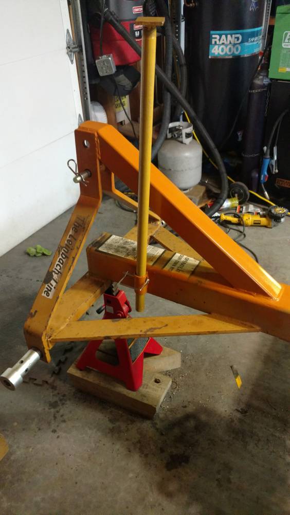

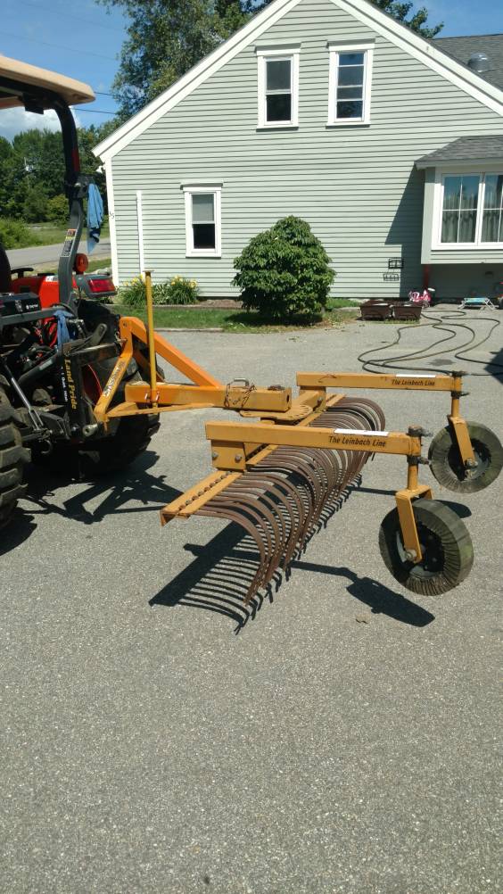

I recently got a screaming deal on a used 6" Leinbach landscape rake. I had to fab a new 'top link stabilizer' to make it quick hitch compatible.
While I was at I tacked on a Cat2-3 lift pin bushing and along with some 3/4 black iron pipe made a kickstand. Never had one, always​ fumbled with a bucket or something. Always wanted one. So...
I used iron pipe on purpose because it would be 'sacrificial.' Well, turns out that the VERY FIRST TIME I go to use I forget to flip it over and bend it up. I've just been using it bent and, of course, not forgotten since. But as soon as I straighten or replace that pipe I'll do it again.
That got me thinking about a more foolproof "fold-away" kickstand or something similar. I have an idea but figured somebody out there could do better.
My idea:
Vertically cut the current sleeve (Cat2-3 bushing welded on the rake) in half or a little less. This would make a half-pipe.
Drill/tap a bolt hole in the center into the landscape rake frame.
Fab new kickstand pipe with same size hole. Probably out of something more durable than black iron.
Place a long bolt as axle through a HD compression spring, through pipe, then thread into rake frame. Red Locktight.
When the kickstand is deployed the pipe would nest in the half-pipe sleeve. With significant forward/backward pressure (I forget to rotate it) the spring compresses and pipe can rotate.
I would grind some shallow grooves in the half-pipe sleeve to keep the kickstand rotated out of the sleeve and held up. I would also grind the pipe's transition path out the sleeve as needed.
Any thoughts? A simpler or more robust way to do this? Any advice appreciated.

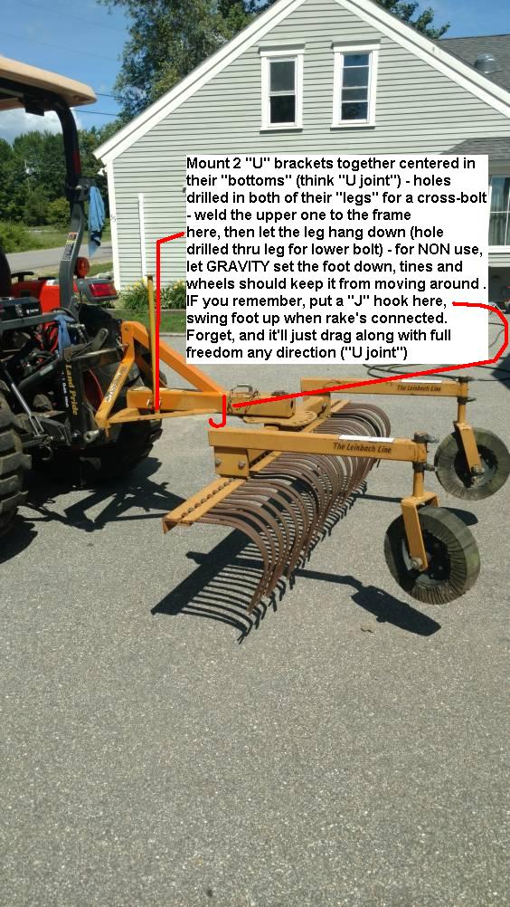

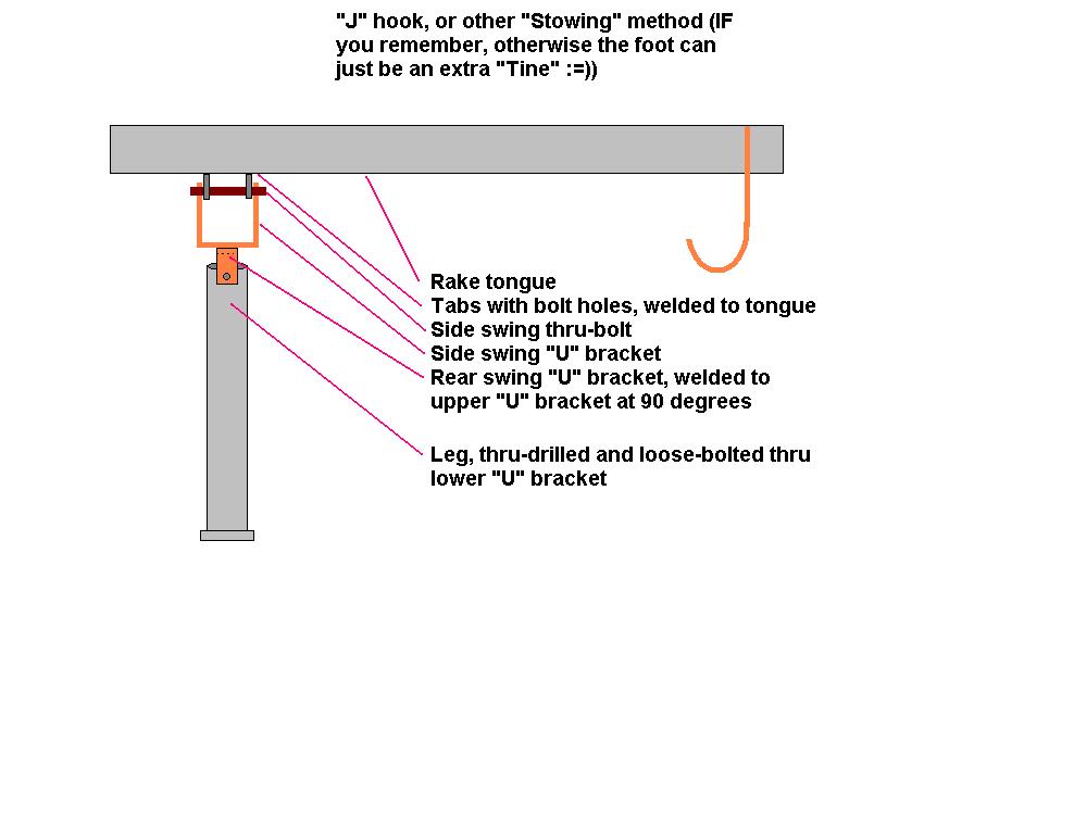

Maybe something like this? ...Steve

BTW, knowing myself I'd probably build ALL those parts out of 1/2"x2" flat bar and use 5/8" bolts for the pivots :laughing:
