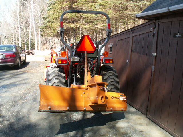

New to posting here but have been a lurker for over a year. You guys and gals have a nice site. I just bought a Deutz 3006 from a friend of mine that needed to sell it and I borrowed it all the time. I have cabin that is up on a hill and I need a scraper blade that will tilt and angle. My ditches are there but I will need to clean them out and keep them open. Can you guys give me any info on what I can get that a 30 hp tractor will handle. Thanks Rick

/ Need blade that will tilt and angle #3
Works great dirt to snow.

/ Need blade that will tilt and angle #7
This set up does everything that I want it to do.
