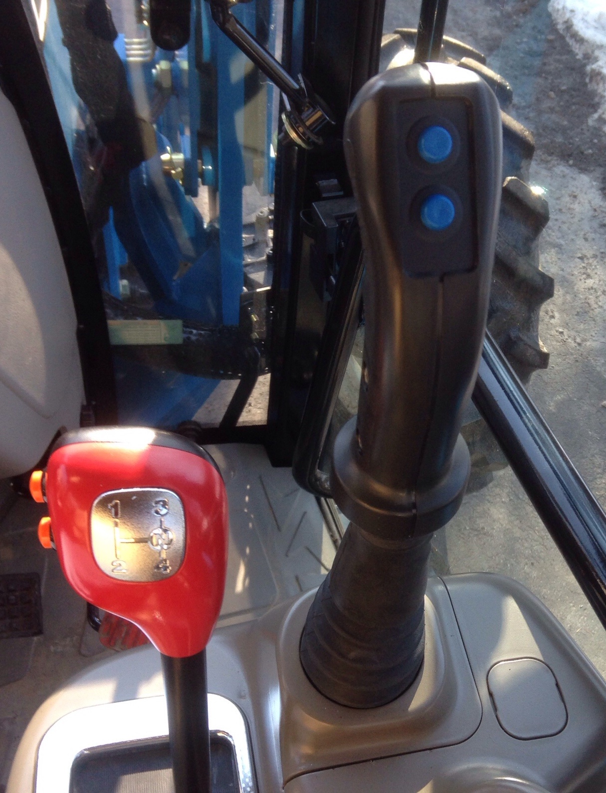

On my tractor and on some of the larger Deere's, they have an electronic hi-lo on the shifter that allows you to switch up or down a gear without depressing the clutch. I think that would be a great feature for you to have.
If you are mowing and it starts to bog down you can just press the button to get back in the power band, no clutch required. At first glance, a power shuttle would require no modification for directional changes and would seem to have an advantage over cost of conversion vs an HST transmission.
Both types have a manual throttle so that would be good. The advantage that many find with the HST transmission may not be realized for someone that must now accomplish those same tasks with their hands and arms and could be quite tiring.
Welcome to the forum and please let us know what you decide. I have attached a photo to show you the hi-lo buttons on the shifter.

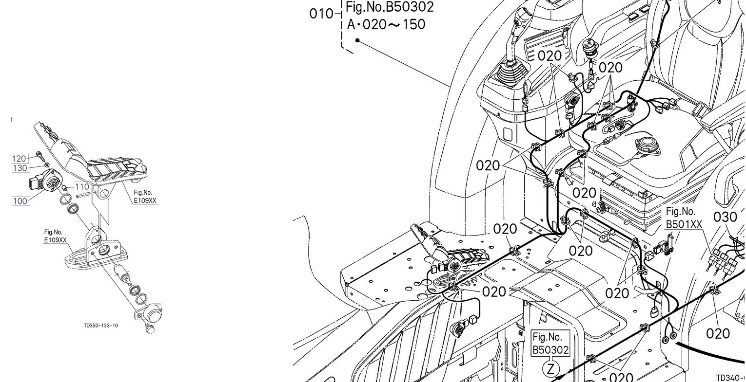

If you are running the engine at pto speeds the shuttle is going to be very abrupt and really rough without the clutch, the engine needs to be running pretty slow to smoothly change direction. The HST pedal on the 60 series is light and easy to work i am sure it could run it with a stick if need be. Unless i am completely reading the parts diagram wrong it looks like the hst pedal just uses a electronic sensor so you may be able to relocate it anywhere you want in the cab as long as you can run wires. There is a plunger the goes through the floor but seems to only connect to the auto throttle advance cam, maybe it would work without this? View attachment 385691. I am only guessing though from quickly looking at the parts, worth taking a look at.
That looks like the Kubota L6060 uses a rotary potentiometer to tell the HST controller user movement request and that would be reasonably easy to relocate.
bmhibinger should share how he would like to work the controls as there are aftermarket joystick handles that can use a variable potentiometer that could control HST movement straight from the joystick lever leaving the lefthand free to steer.
