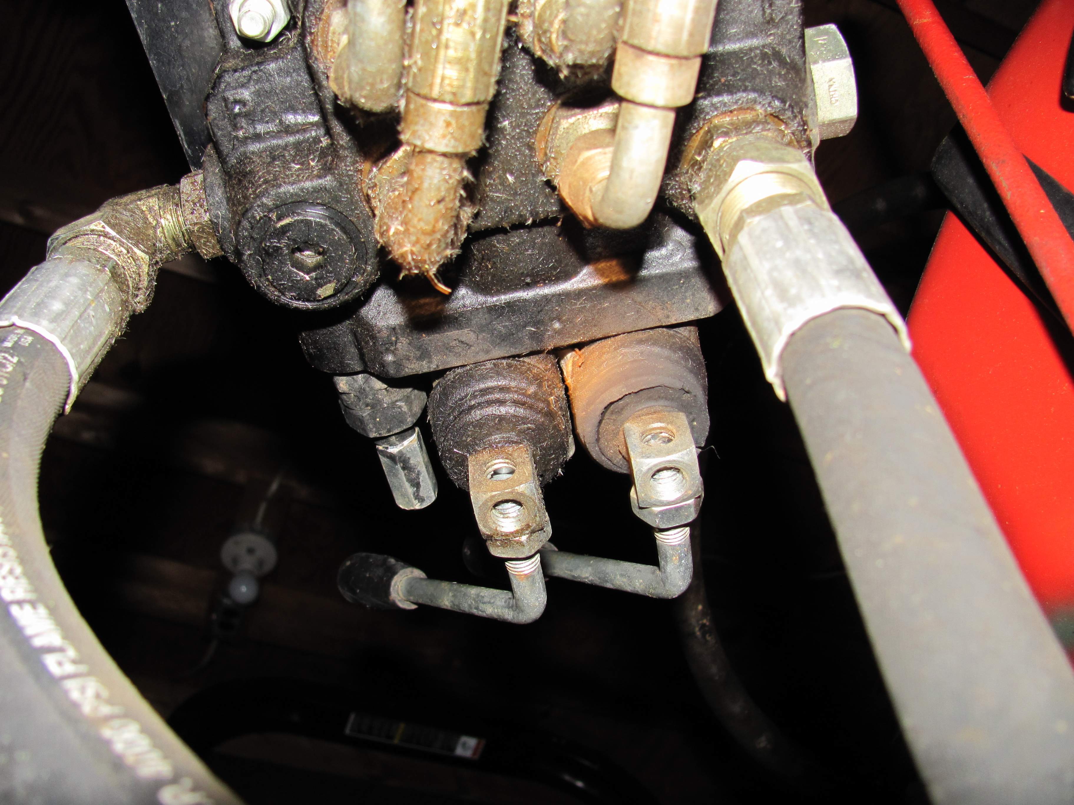

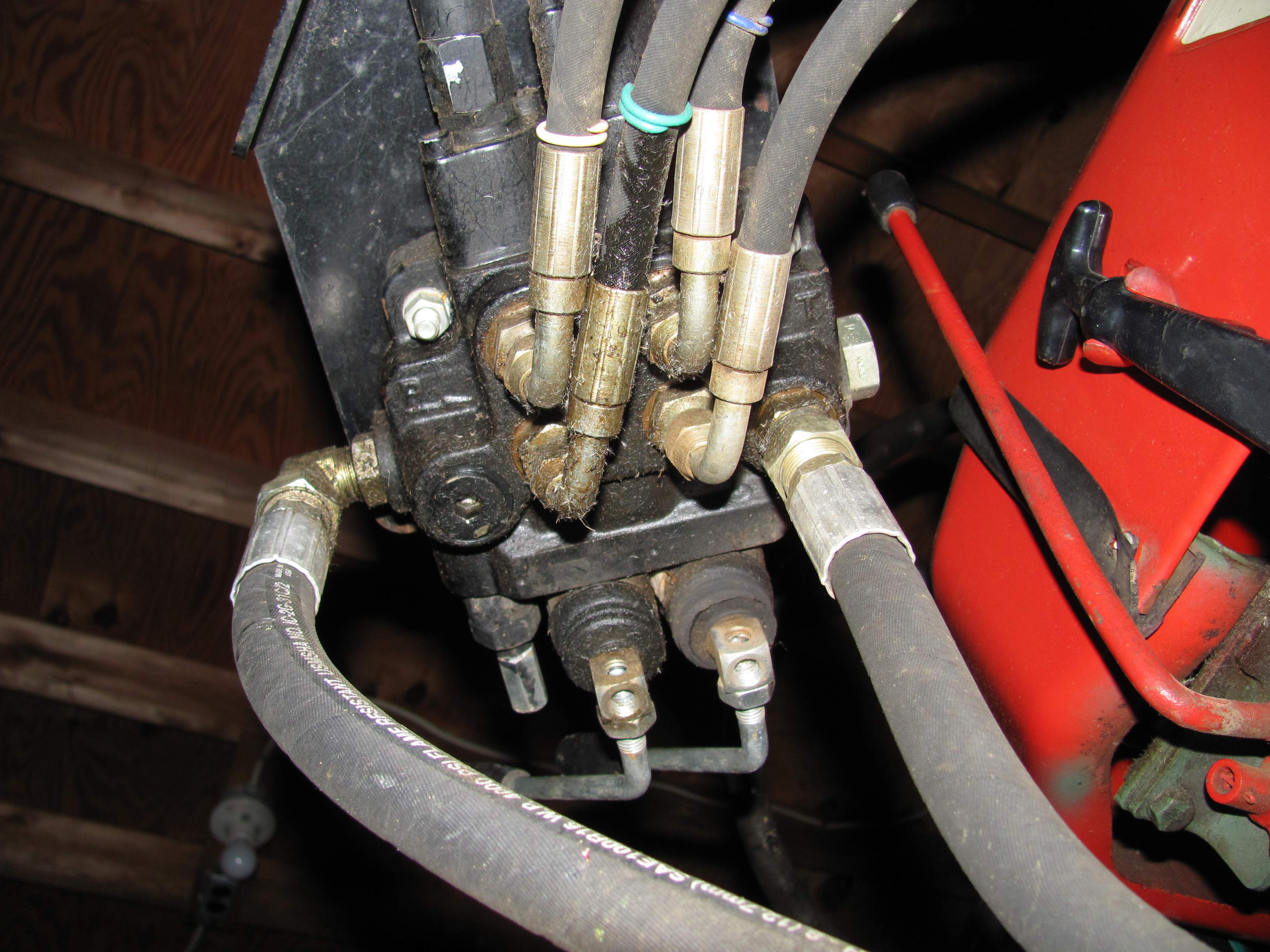

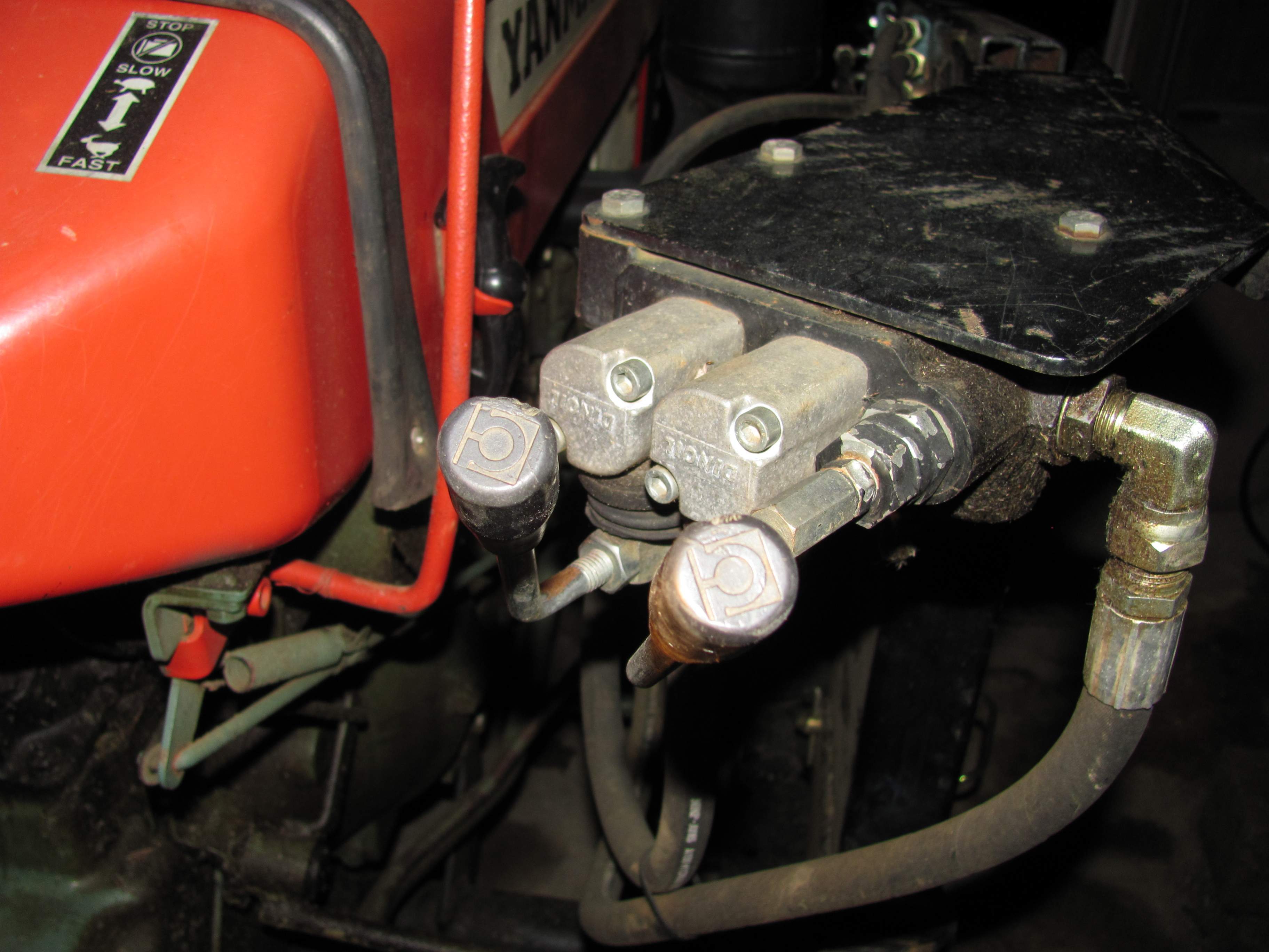

I ordered a grapple for the Koyker 120 on my Yanmar 2210D. I'm a very new tractor owner & have zero hydraulics experience; want to get it right the first time. I am including two pics of the loader valve to see if it's able to have a power beyond fitting added. I want to include quick connect fittings, so I can unplug the grapple and run another implement (I'm thinking log splitter). I believe the grapple has 3/8" fittings.
I need to know what type of valve to buy to operate the grapple, how (and where) to tap into the loader valve, and whatever else I need to buy in the way of hoses, fittings, etc.
Thanks in advance for your help. You will have a great feeling after helping the (hydraulically) retarded. Me.

It seems you have an open center with power beyond (or able to convert to it). Look on page 25 of the manual... top of page, "out (tank)" I did not see a third line (low pressure return) from your valve... is there one? (didn't see in your photo - or missed it...)
http://www.koykermfg.com/images/koyker-manuals/120.pdf
It this is the case, it might not be too different from the one I just did... (I did 3 valves but it's the same if you only wanted one).
Confirm that this is your loader model, too...
My write up: http://www.tractorbynet.com/forums/...7948-instructions-add-extra-spools-l2800.html

Yep, 120 is the model. I don't know if the fact that mine is two lever, and not joystick style, makes any difference?
So, the port that the power beyond sleeve goes into is covered by the valve mounting plate? Is that how you see it? I have no idea about the low pressure return hose........:eek:
I just read your write up........it helped me some, but I'm still considerably confused. Essentially though, won't the grapple cylinder be fed through the power beyond (and it's valve/spool) and then need to return to the hydraulics reservoir/tank? If that's right, then I'm on the way to better understanding this.
Now just need to narrow down the parts/accessories I'll need.

stormpetrel,
The PB port is on the right with the large hex plug. When you get the PB sleeve, remove the plug and screw the PB sleeve in.

stormpetrel,
Thanks, very helpful.
So: from PB sleeve, to grapple valve to grapple, back to tank? Am I even close? :confused:

The fluid from the grapple out port should go back to the 3pt. The tank port on the FEL valve should go to tank, as this is now expended fluid from the cylinders.
Scroll down to page two for illustrations.
