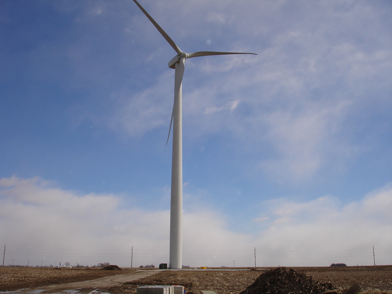

I think there is a lot of disinformation on wind power here, at least at the commercial scale, relative to new technology. I used to work in the industry, just on the west side of the altamont pass.
Those "turbines" are mostly over 20 years old. Only a few are even around 10 years old. Many of the companies that built them are out of business.
However times, energy costs, and technology have changed massively since then. New turbines can produce energy, for a decade or 2, at a cost that is getting competitive with commercially produced electricity without subsidies.
While I do not think windpower is the solution to our energy woes, I do think it is an important PIECE of that overall solution. When done properly, and in the right location, it is an excellent way to generate electricity with minimal environmental impact.
I recently purchased a property/home in a location on the top of a hill, at one of the top 5 or so highest points in my county. We get amazing, and steady winds up here, especially in the winter. I have considered doing a year long wind survey to see what the payoff might be for a small wind turbine installation. Even in my conditions, I doubt that I will see a payoff in a reasonable amount of time. If I could break even, at today's electricity prices, in 10-15, I would probably do it.
One error many people make is that to make them really work properly, you have to get them up REALLY REALLY high.

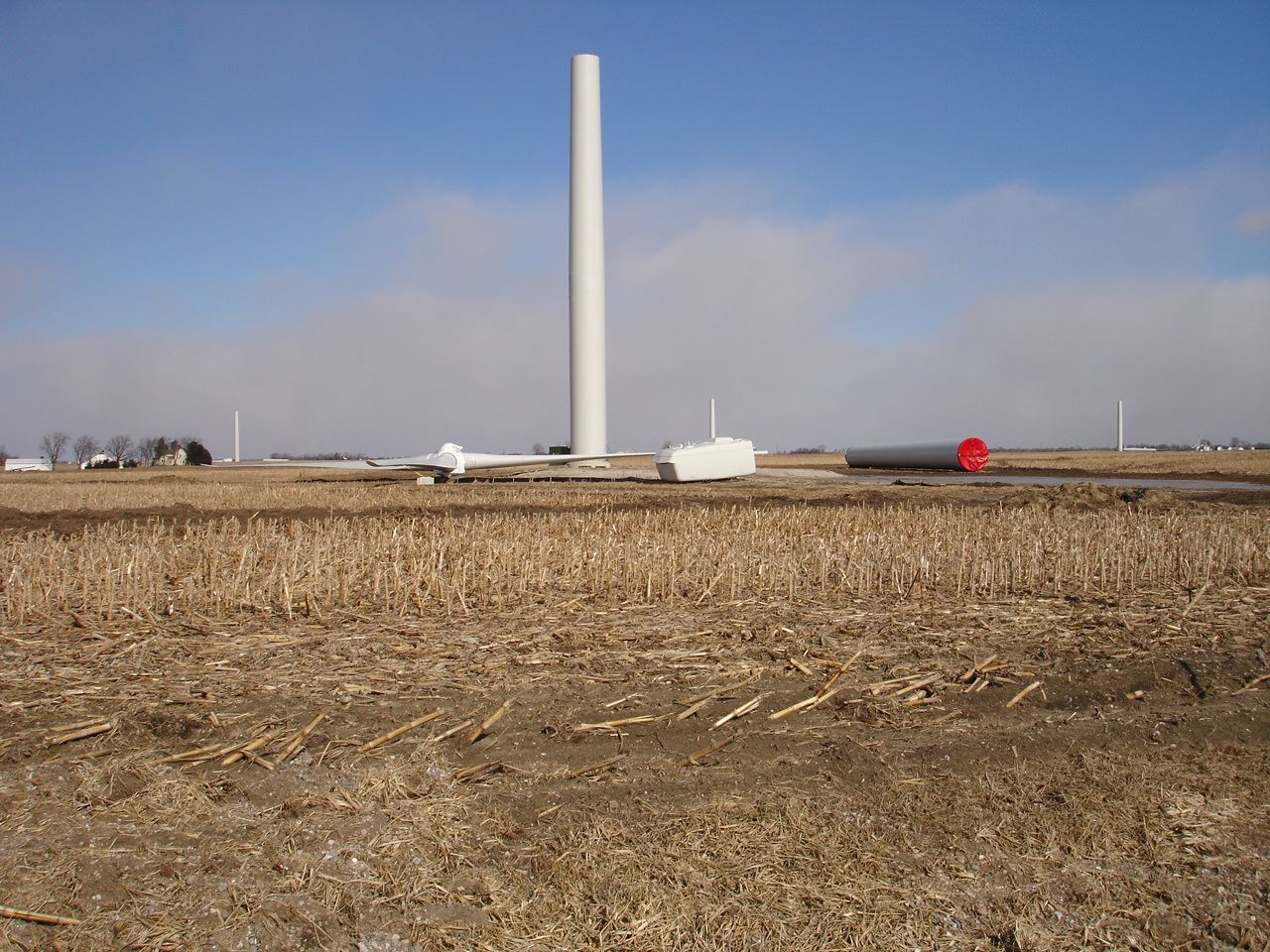

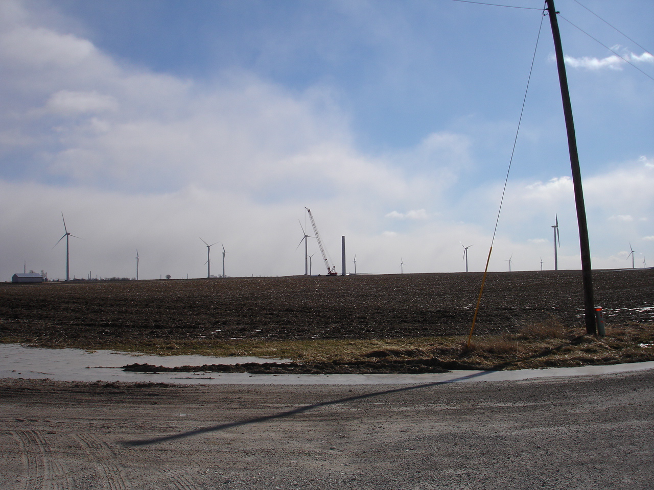

I do agree you that some of the information provided may be disinformation regarding wind energy. I was only pointing out when I wrote earlier that homeowner wind energy is expensive and requires a bunch of prior planning to make sure you are prepared for the cost and the work associated with owning and operating a wind energy source.
Now on the commercial side of the wind energy controversy and believe me it is just that, one has to understand just what is happening in the rural north country and plains of our country. Knowing first hand what is taking place in rural upstate New York with wind energy I can certainly comment that not everyone is happy with the wind energy companies.
The immediate benefits have been to the local farmers, many of them aging and not able to produce enough income to hold onto the home farmlands, are being provided signing bonus money to permit the installation of wind turbines on their property. These are large checks that make the farm tax payments, buy new trucks and tractors plus put some money into their pockets.
Also small towns are getting large payments. The school board of Chateaugay, NY received a payment of over $330,000 this year alone and is using the money to lower taxes and upgrade the schools computer systems. I should mention here that this money was given to the town in lieu of taxes. Not sure just what that means, but it sounds as if they are willing to pay out money and not have to be taxed on the actual value of the wind turbines. Keep in mind they are planning on an installation of over 300 turbines in the area.
Future benefits to the local farmers will be the cash given to them depending upon how much energy is produced by the wind farm. Numbers being thrown around are anywhere from $4,000 to $10,000 per Turbine.
Physically the wind turbine towers are hard to miss, most are nearly 400 feet tall! Placement has been along the boarder lines of large hay fields (stone wall areas) and they have actually taken the stone walls and crushed all of the rocks to make access roads. It is a major operation and interesting to watch.
The company operating the installation has been extremely good about managing the roadways and any damage has been instantly repaired even if it required repaving the roadway.
