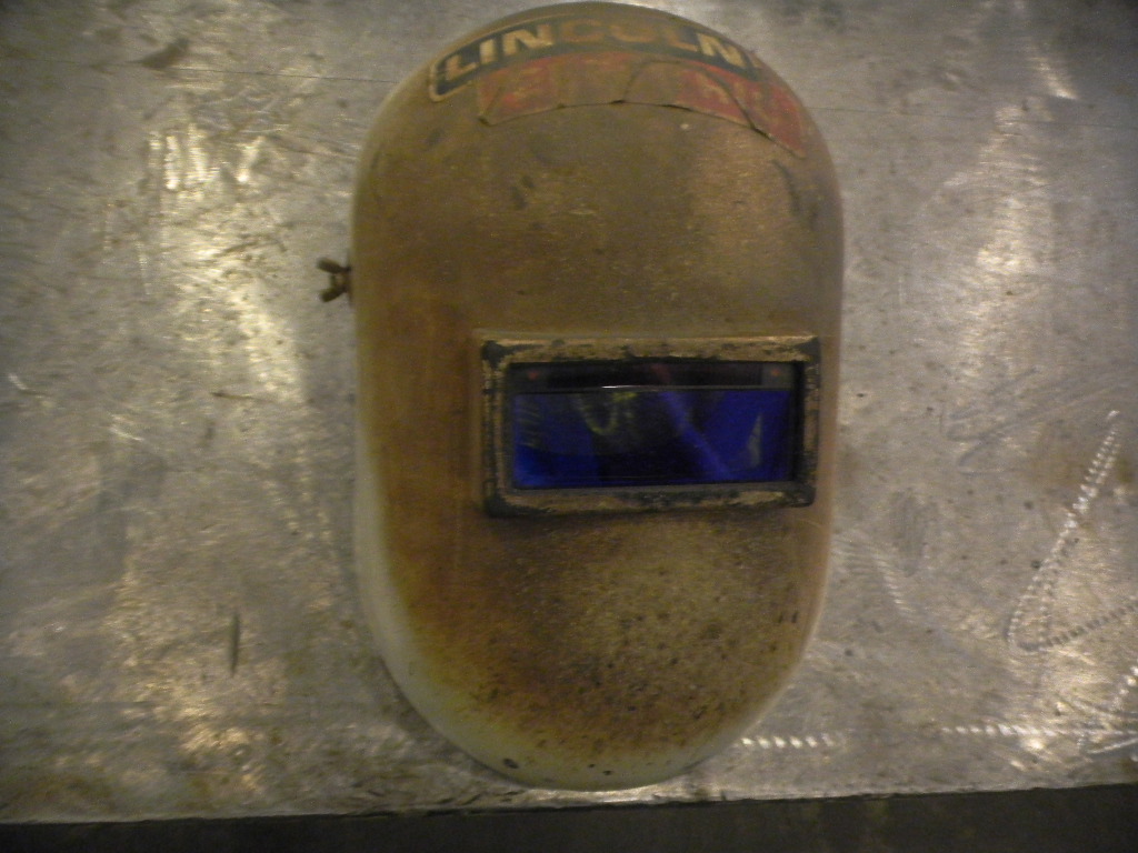

I have used the fibre-metal's pipeline style for years. I upgraded to an auto dark lens three years ago. I love the older slim style with firm headgear that does not flop when your in tight spots in very uncomfortable positions. I have two set up the same way. The auto glass is an arc one singles shade 11 solar powered no batteries. Simple tuff and it works. I would not really want another style but once I like it I rarely change unless it fails me. The auto lens ran about $120 two years ago. Hope it helps. Keep the hood down and keep lights burning!
You know, you're beginning to scare me. We think too much alike!:thumbsup:
I just switched to the ArcOne little over a year ago, love it.:cool2:
