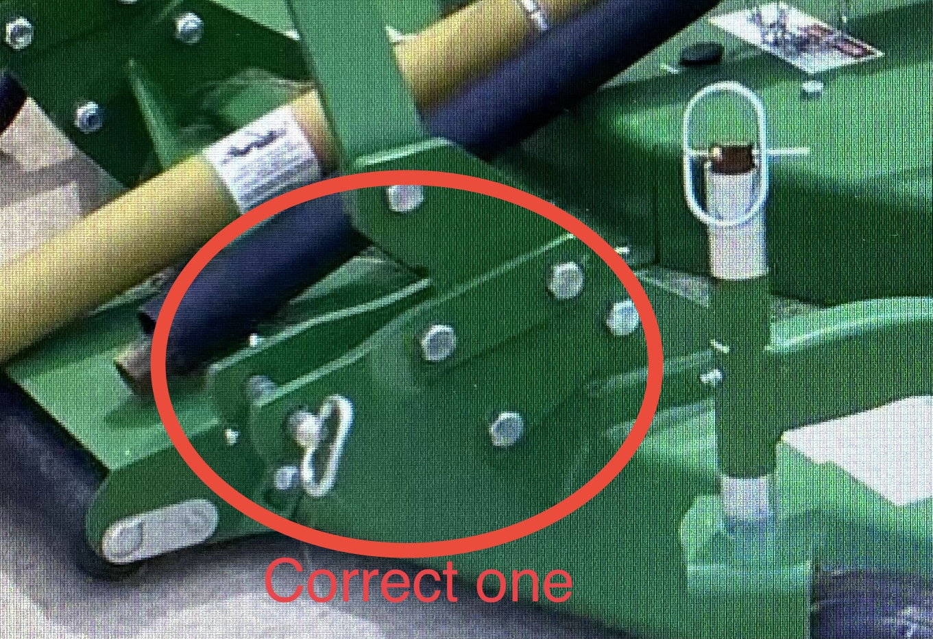

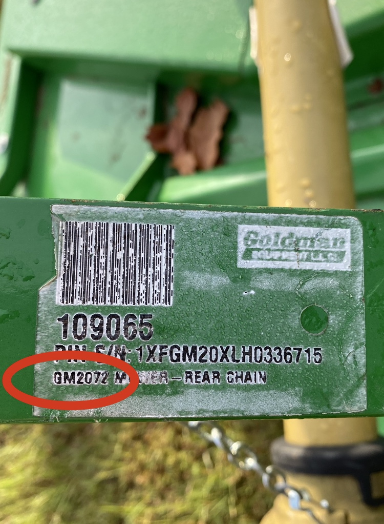

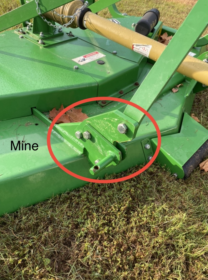

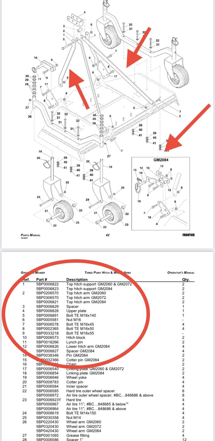

Okay, I may be on to something. Sorry for the back and forth. I purchased a Frontier GM2084R. After checking it out more, I found a sticker from the dealer on my top hitch support which states GM2072 which you’ll see in my photos. It’s also #1 in pdf photo. The top hitch arms (#2 in pdf) are also longer on the GM2084 than on the GM2072. Then I observed the lower hitch arms. I have the GM2072 hitch arms as opposed to the GM2084 that I should have which is also denoted in the photos. I called the service department and was told the top hitch support for the GM2084 is taller than the GM2072 and costs more. So……I think I purchased a new 7 ft mower with a 6 ft mower front end. Could this be my problem? Maybe my mower is too close because of shorter lower hitch arms and too low because of shorter top hitch support?

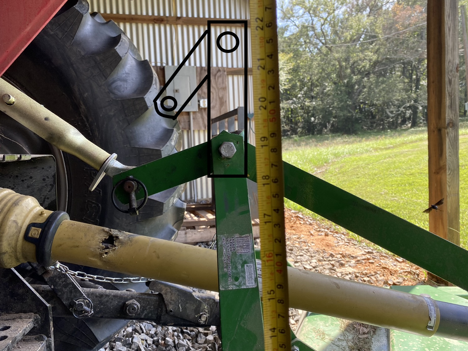

Have some bar stock that you could use to raise that mounting point?
Don't know how old this mower is, but.. I'm back to my original suggestion of extending that flex hinge's mounting point to be about 3" higher.
ie: That point at 19" in your 2nd pic, move it up about 3" using bar stock. Bolt and weld the new bar stock to the uprights using a pipe as a spacer to maintain the separation. Then shorten the flex hitch by about and inch ('cause it really is too long) and mount it using the raised point.

I do but it pushed the floating link down more into the driveshaft.
I have a very similar setup. JD 870, Frontier 6 ft finish mower. If i remember correctly, The manual say that the top link should be lined up with the pins on lift arms. If that]s the case, your top link needs to be much shorter. The top link on my setup is almost parallel to the ground. Has worked great for the past 4 years.

If true that could be a big part of the problem.

Well that is NEW light on things. If this is a new machine and you got the wrong mounting hardware on it (which it sure looks like you did) then DO NOT modify or dick with anything ! Insist that the dealer set it up right. Even if he wants a few bucks more to do that, you are way better off than modifying a brand new attachment !

That makes sense. We all knew that something was funky with that setup, and it looks like you found out why. Agreed with making the *dealer* make this right. He shouldn't charge you for it either (unless you made the mistake, of course). Insist on a correction.
