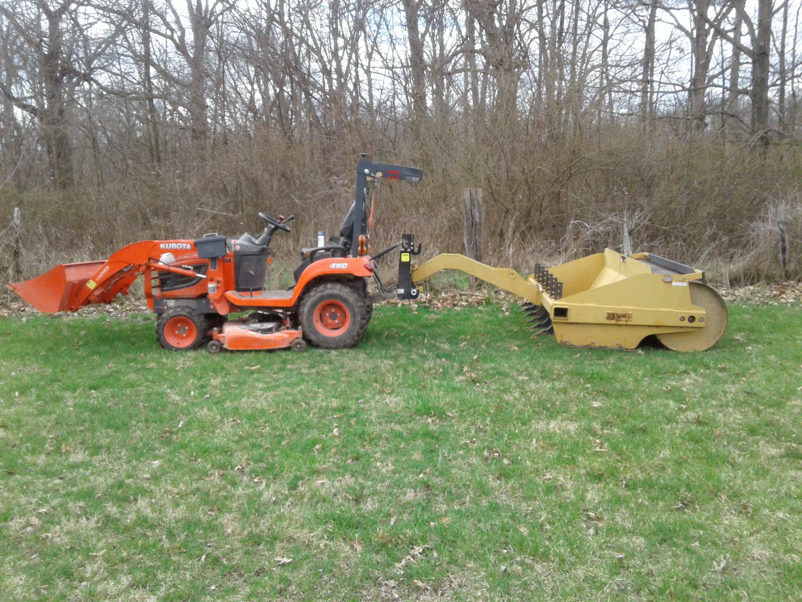

If your land leveling needs are heavy duty here are some interesting tools.
Hoelscher Commercial Products - GR Grader
Hoelscher Commercial Products - RB Scraper
Good for shearing off mole hills and flattening runs. Have larger tractor when I really want to "make it work"

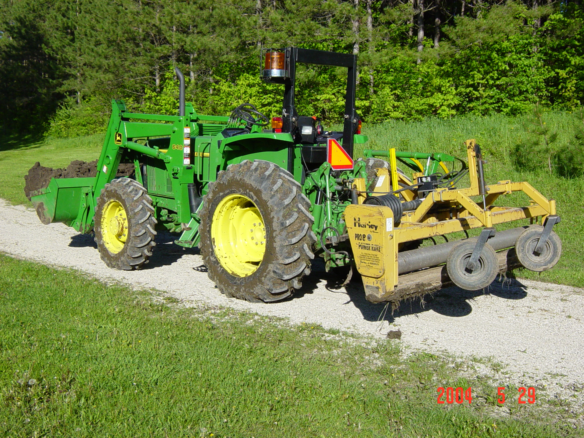

I have this harley rake and have fields as the op describes that I would like smoothed out. It would not be my tool of choice. It would be an unholly mess of sod, rocks and clods. I would run a disk over it a few times before using the Harley, IF that was my plan anyways.
You can only realistically windrow material so much and then you need to collect the debris. Even with equipment, it's an insane amount of work. I did this for removal on one job.

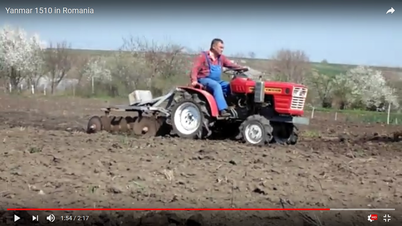

Disc Harrow, front gang notched, back gang round. Add weight to your liking to get the high spots loose to fill in the low spots. Next, with a WIDE straight blade, travel forward with the blade in reverse. This will SMOOTH the high spots and fill in the low spots along with grading it all nicely. See my cheesy image ... The C is the blade in reverse.
|O--O\---C
These are the tools used after an area has been logged and the stumps ripped out leaving these gaping holes like a semi-truck tire in size.
Disc harrow will not compact the soil, instead it will open it up and allow nutrients over the winter to be added. It's a great tool for food plotting for animals as well.
Been doing this since the land was logged and cleared. Works really well. Have not needed to use and dragged tools either.
