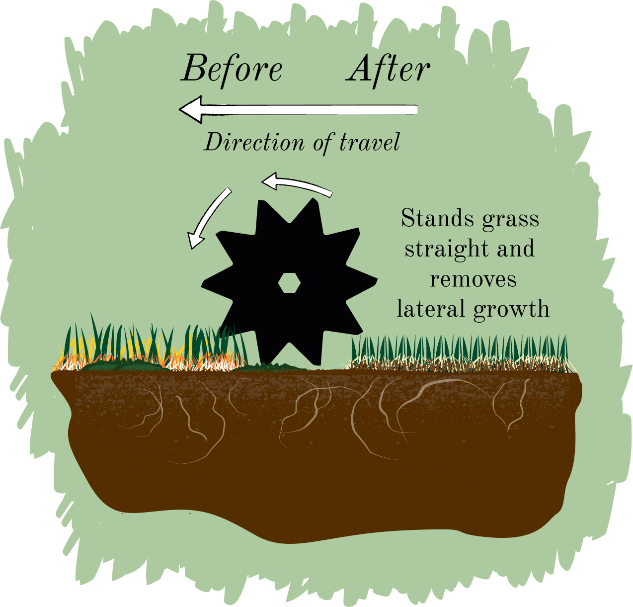

If you want golf-course fairway smooth then use what a golf course uses, a verticutter. This is like a flail mower that has vertical knives that go down into the thatch/dirt pulling up material. High spots will be dug deeper than low spots leaving the sod intact. It depends on the verticutter used but with some you can leave the evenly distributed tailings in place, others will clump up the tailings requiring you to collect them up with a lawn sweeper or mower with vac and a short cut. There are also verticutter mowers that have built in collection bins. These are also called scarifiers which I understand is a deeper cutting version of a verticutter.
