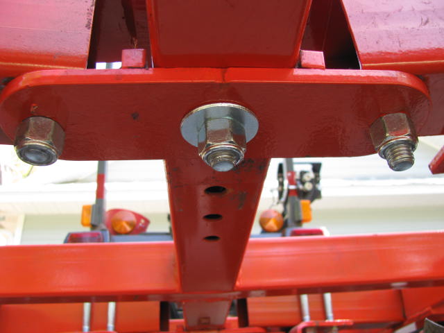

You need at least 40 pounds bearing on each pan in order to cut well. Notched pans cut better than smooth pans, which will ride over some vegetation notched pans will cut.
I believe the 16/20" from Howse weights 878 pounds (55 pounds per pan) and the 20/20" from Howse weighs 1097 pounds (55 pounds per pan) and both 16/20 AND 20/20 come with notched pans, so both should cut vegetation well. Most people only cut over food plot ground once, then seed and cover, so enough weight bearing on each pan is KEY.
The layout of 3-Pt mounted Disc Harrows is pretty much the same: width, pan diameter, notched or smooth, pan spacing (7" or 9") and adjustability. Most have "clamp plate" adjustment of the gang angles. I have a Howse 16/18" and the build quality is very good. The only extra cost feature to consider is lever or screw easy-adjustment of gang angles (ETA, Brown, Monroe Tufline) which is probably not important to you in food plots.
For food plots you want the Disc Harrow a bit narrower than rear tire width. You will be maneuvering between trees with a large tractor and you want the Disc Harrow to follow obediently and not hang up in tree gaps because it exceeds the width of your tires, especially on sloped plot land.
A drag harrow conforms to the shape of the land and is "adjustable" depending on which side is down and which end it is pulled from. I recommend a drag/chain harrow for food plots. A spike harrow is more for field use, but will certainly cover seed in a food plot too. It is a little too easy to rip off spikes working a spike harrow in food plots.
A Culipacker is better at rolling in seed but is more money.

I own a Howse 6' like jeff9366 showed. I use a pin and lynch clip in the center to make changing the angle easier. Just lift it up and slide with a spud/crescent wrench I keep in the toolbox. I have 4 solid 1" rods 12" long welded on each corner of the frame for old steel barbell weights to stack on for up to 400# of extra weight when needed. It works great on the small fields and is easy to transport.
