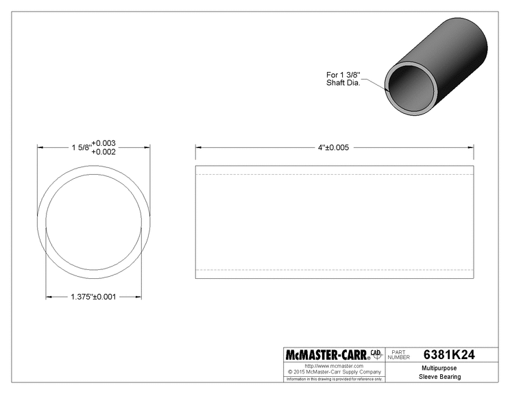

Now that the tractor is home with me, I've been thinking about this a little more. I can take the dipperstick off and line it up on my vertical mill...or I guess I could use my lathe, but I think the mill is more accurate and easier to control precise movements. They make cutting bits in just about any orientation/size that I might need.
New pins are 1.375" in diameter, and I have somewhere between 0.125-0.225" of slop in the bottom bore with no serviceable/replaceable bushing. If I could bore it out to about 1.625", a bushing similar to below might work. I could even put a grease groove and grease holes in very easily. It still boggles my mind that JD didn't put a replaceable bushing here and some other spots on the tractor...WTF.
Something similar to this below could potentially work. With the dipperstick off, it would be very easy to press into the bore.

I have had good luck using a shaft coupling (they are forged steel) the same size as the pin and welding a short piece of in a drilled out or O/A burned hole. An expandable reamer (like HF has) will ream out to the clearance for grease.

I had the same problem on my 110. I simply made a bushing running the whole length of the dipper stick drilled a hole in for grease to pass through. Good as new.

What material did you make the bushing out of? Was it hardened?
How has it held up?
I'm also curious what tolerance you used between pin -> ID and OD -> bore.
   / Need Advice on JD110 Backhoe Arm #20
My holes were wore pretty good. Where yours just from looking at the pictures look to be in better shape. (need to put mics on it to see for sure).
My pin was also froze into the dipper stick and i had to make a new pin as the old one was destroyed trying to get it out.
The material was just a c1018 cold rolled steel. I did not harden it afterwards. The pin however was 4340 Q&T. I'd rather make bushings then a new pin!
I can not remember exact OD/ID as it has been awhile but i want to say less than 0.01
So far it is holding up well. At least i know grease is going where it should and not ruining my dipperstick.
