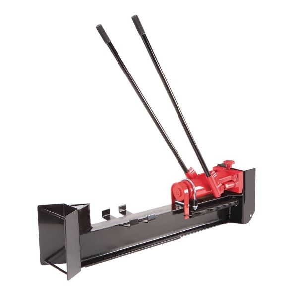

As far as splitting goes -
I bought one of those 10 Ton Hydraulic Log Splitters from HF, my fireplace of use was in the walkout basement.View attachment 728229
Used it sort of like a Nordic Track to exercise my arms while watching TV.
I have one of those. It works really well. It's not necessarily faster than splitting with a maul, but it sure is easy!
   / Need advice on a larger chainsaw for an older guy. #244
For me it was a LOT faster. I was splitting inside our "rec room" in the basement. Kept hitting the basement ceiling with the maul :)

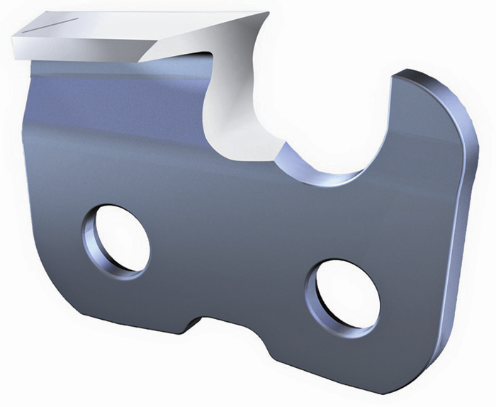

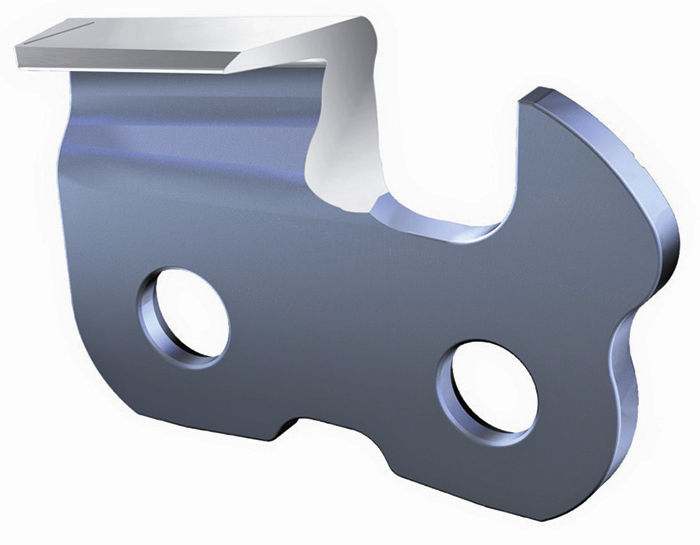

Square ground (or filed) looks like this:
Round filed/ground looks like:
Chisel/semi chisel is the shape of the corner of the tooth where it bends from vertical to horizontal. Chisel has a sharp crease so the filed edge of the tooth is a point. Semi is rounded over. The corner of the tooth is what cuts. Both pics above are chisel.

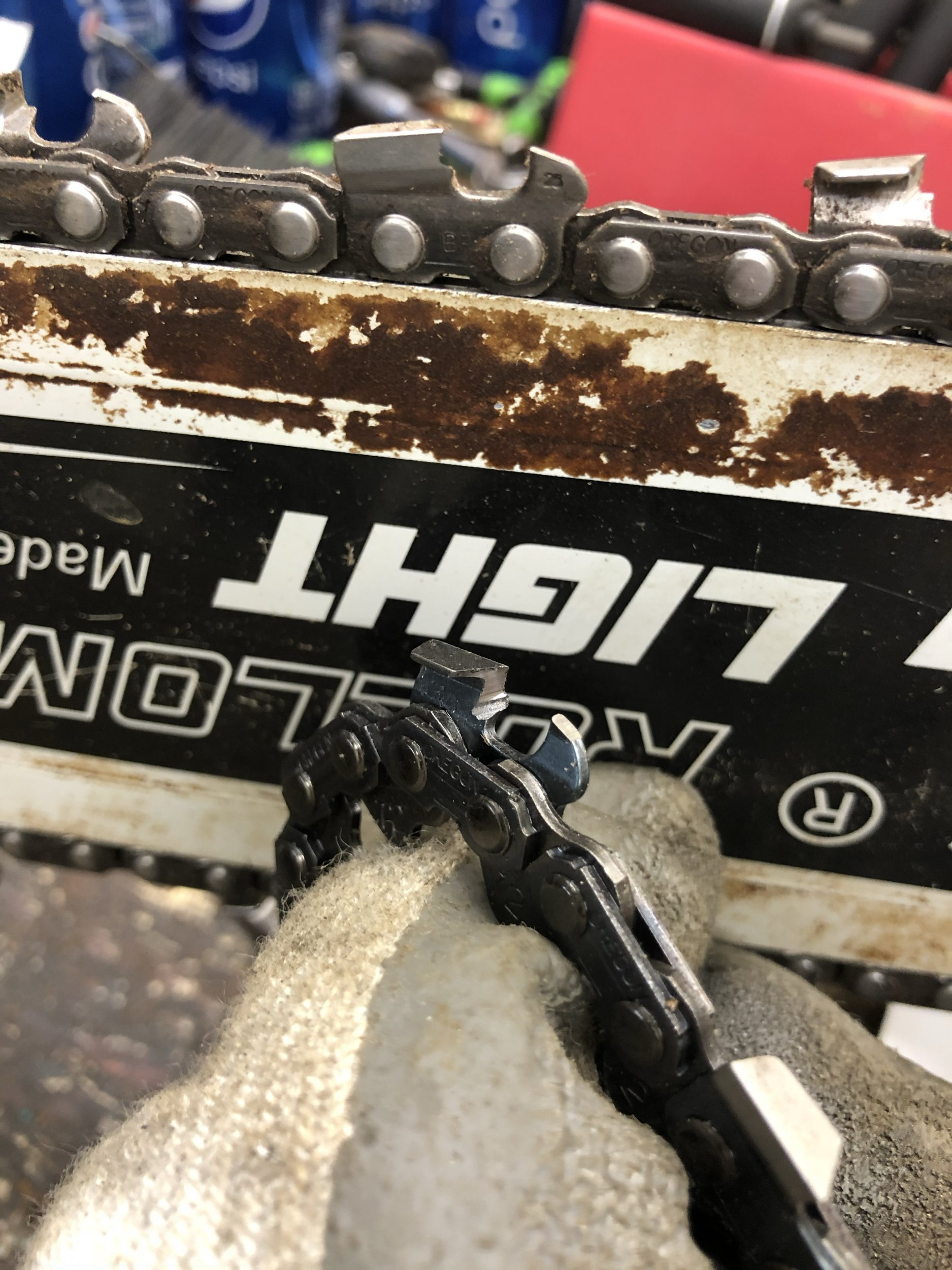

This one is round ground semi chisel.
Theoretically you could square grind semi chisel chain. Square ground cuts even faster than full chisel round ground but wears faster too. Square ground semi chisel would kind of be a waste but it's possible. This article shows how to square file chain and shows the file that's used: How To File Square Chisel Chain
