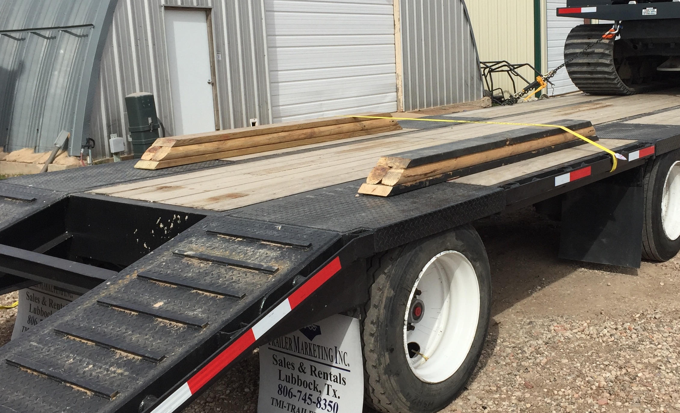

If 4x4s or will work, I would use lag bolts or carriage bolts to fasten 2-3 together and make a "block pack" that you set on your trailer. You could even pre-drill a 3/4" hole down 3/4 of the way and put a couple of deck screws through the holes.

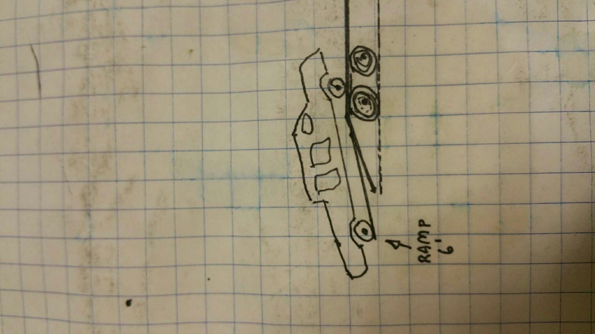

While that will work in theory it isn't practical with a 65' long truck and the fact I have spread axles 10' apart. It would also be hard to pull the 70k gross weight out of the ditch once loaded.
Basically I just need to make the places the pickup tires contact when loading a few inches higher than the rest of the trailer.

If it's only a few inches lay down some 2x8 on the trailer deck where the tire's track.

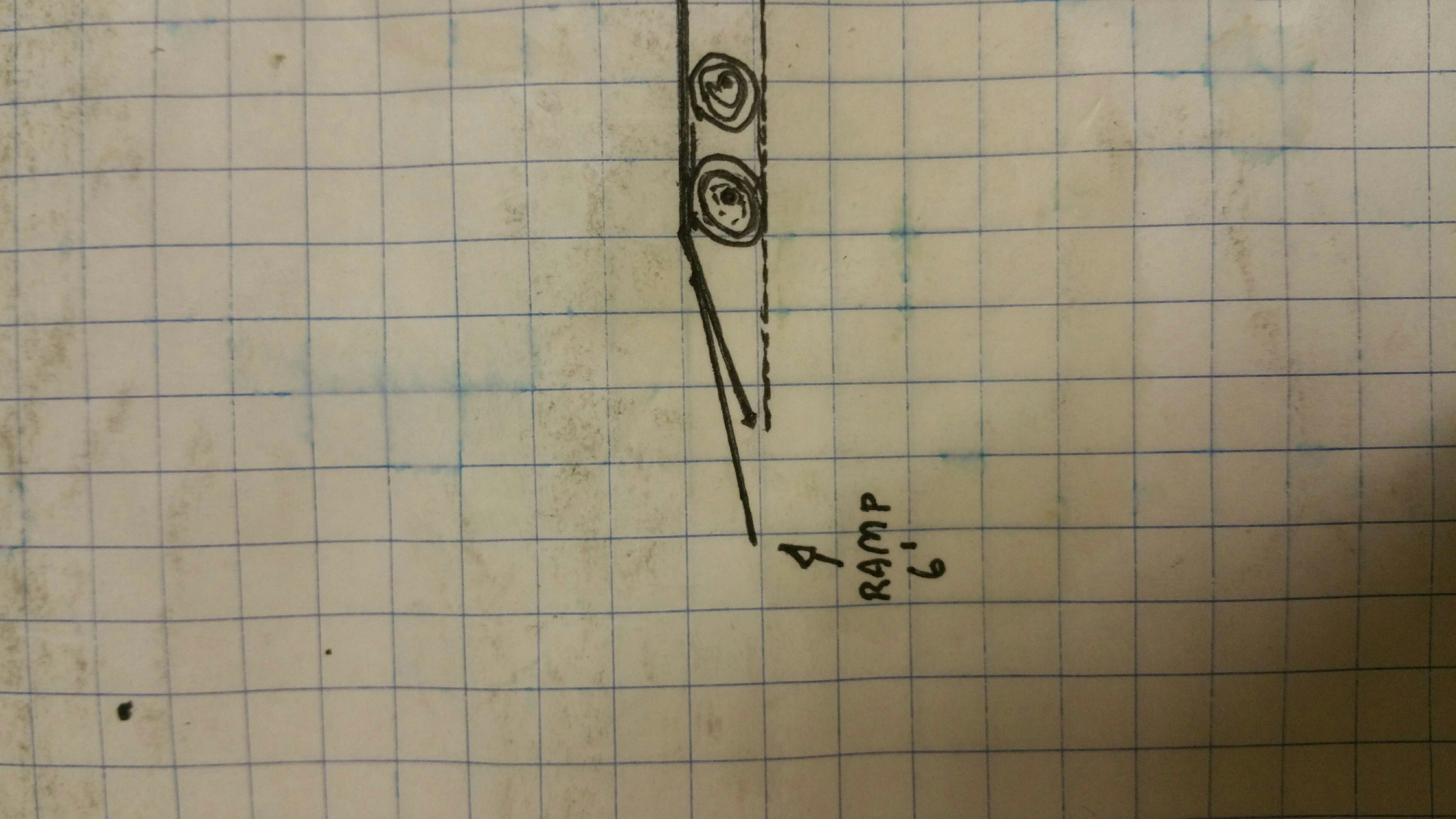

Use a set of ramps 6ft long to load the truck. It will lift the rear wheel when the fronts are on the trailer and give you the space.
Some ramps are already bent with an arch. I had to get some for my side by side for the same problem.
You only need some that handle half the weight of the truck if you only use on axle at a time.
Easy peezy!
My drawings are crude but the lengths are to scale. Assuming a 12ft wheelbase and the 5ft dovetail and 6ft ramp.
