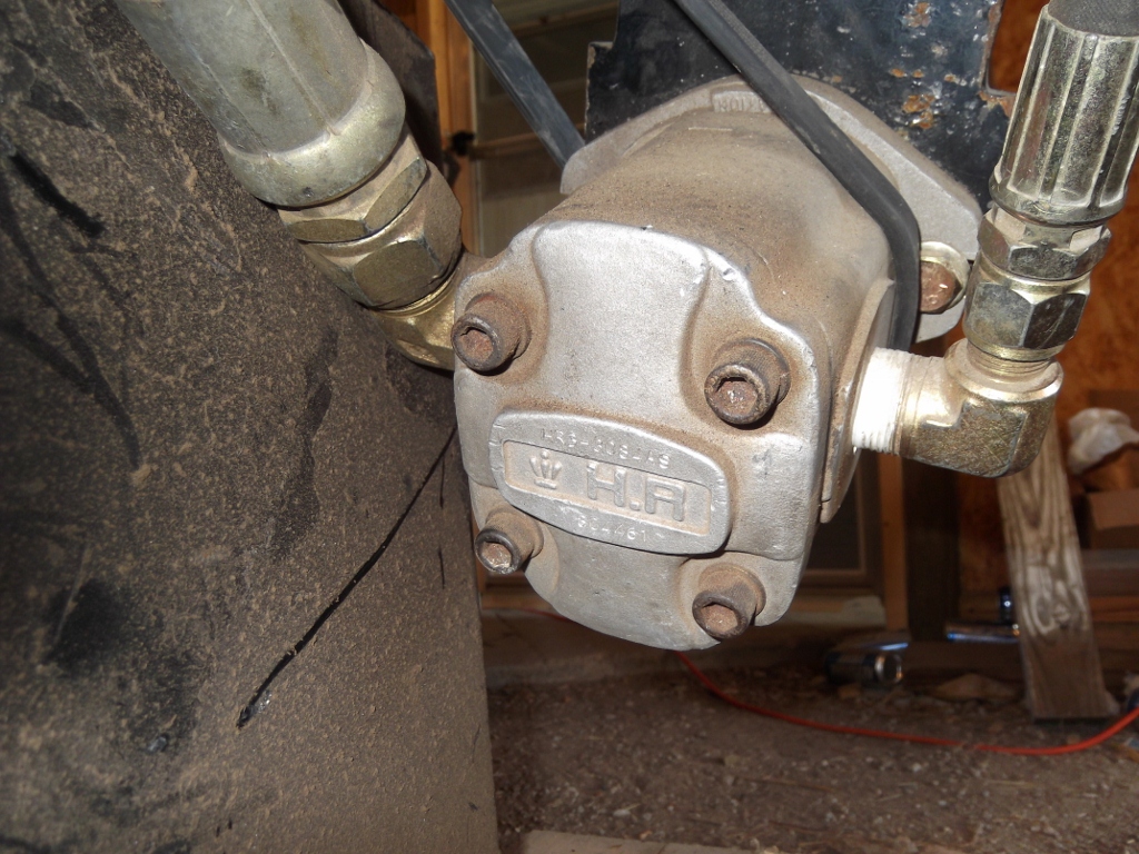

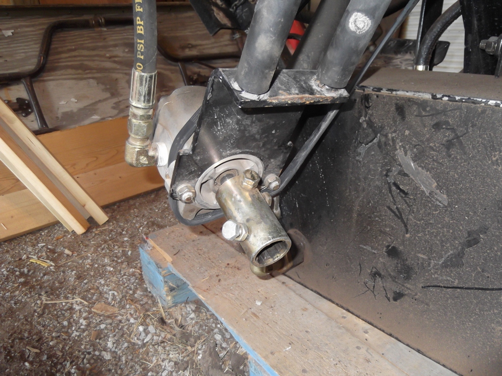

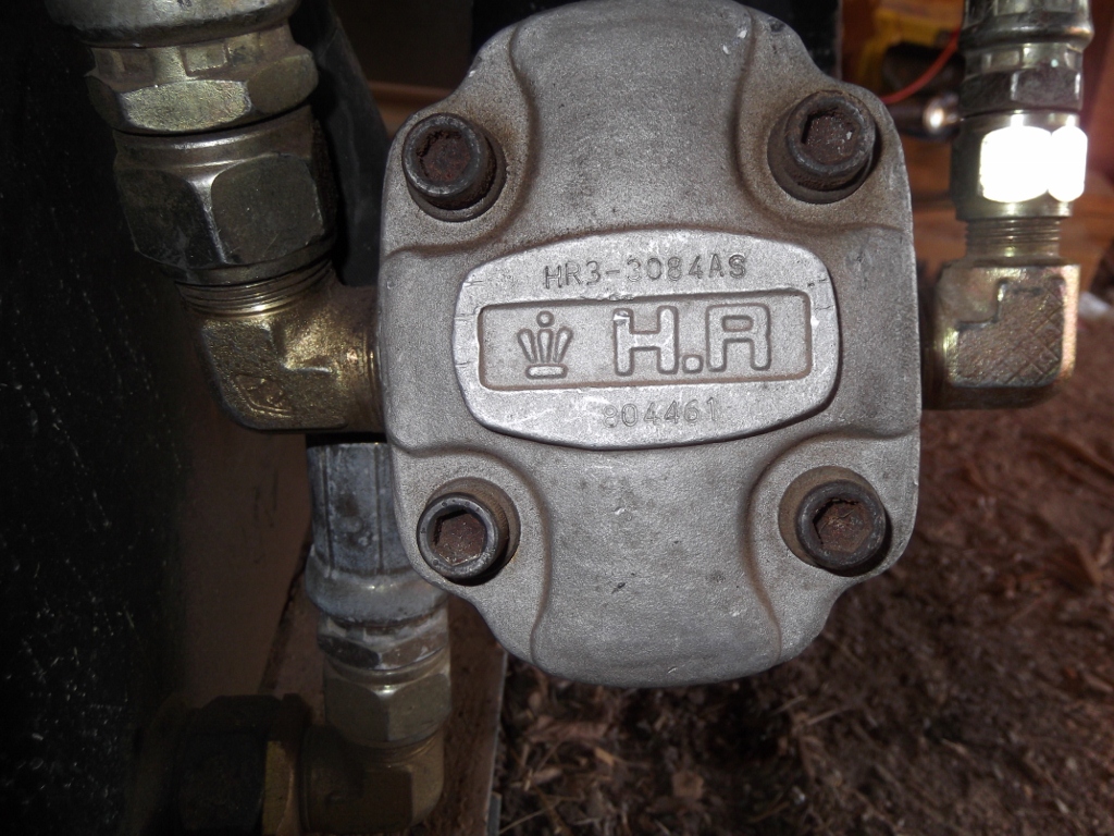

Thanks JJ and N8ghz thats what I am wondering about I haven't had the time to go over the calculators LD1 provided I will here directly but those figures and opinions are some of what I am curious about.
I wish I could find the specs on the BH pump just for my info it is a mystery who built it I cant find a single thing on it???
After looking at tanks yesterday I wasn't able to better what I have already and looking at the reasons I am doing this anyway makes me think cutting the axle and taking the tongue off will be the best option.
I will have a good Briggs 5hp IC engine and a nice 2 stage pump left over and a couple wheels and tires I can use somewhere else. Having the tank left over would have been a waste so thats not too bad carnage if a guys got to hack a perfectly good tool up to make improvements to it imho so I think the pump is my only real variable at this point.
I believe I will attempt to use my BH pump since its already setup with the 1 3/8 6 spline if that isn't quite right I will build a splitter pump bracket with gear reduction which I believe I can do it so simple it will surprise anybody that sees it time will tell.
Either way the bracket I build for the BH pump will definitely be a plus for the BH. fwtw

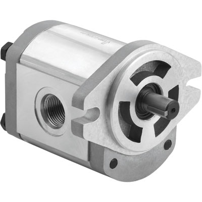

Does your pump look anything like this?
Surplus Center - 5.7 CU IN PRINCE HC-PTO-3A PTO PUMP 1000 RPM

No the BH pump is similar to this one if the pic works.
In fact JJ I will go and get a pic of it so I have one on my pc to look at anyway I will be back here in a few minutes or so...

The emblem on the pump is a Prince emblem, but can't find a ref to an HR pump.
Could also be a Crown emblem.
