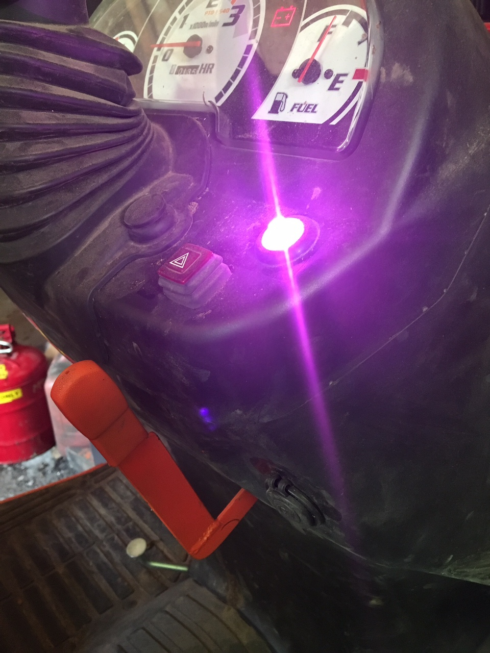

The parking brake handle on the B26 wasn’t very ergonomically designed and no warning light. The operation was also opposite of my other tractor. Strange how little things matter.
Extended the parking brake level and added a brake “on” light.
