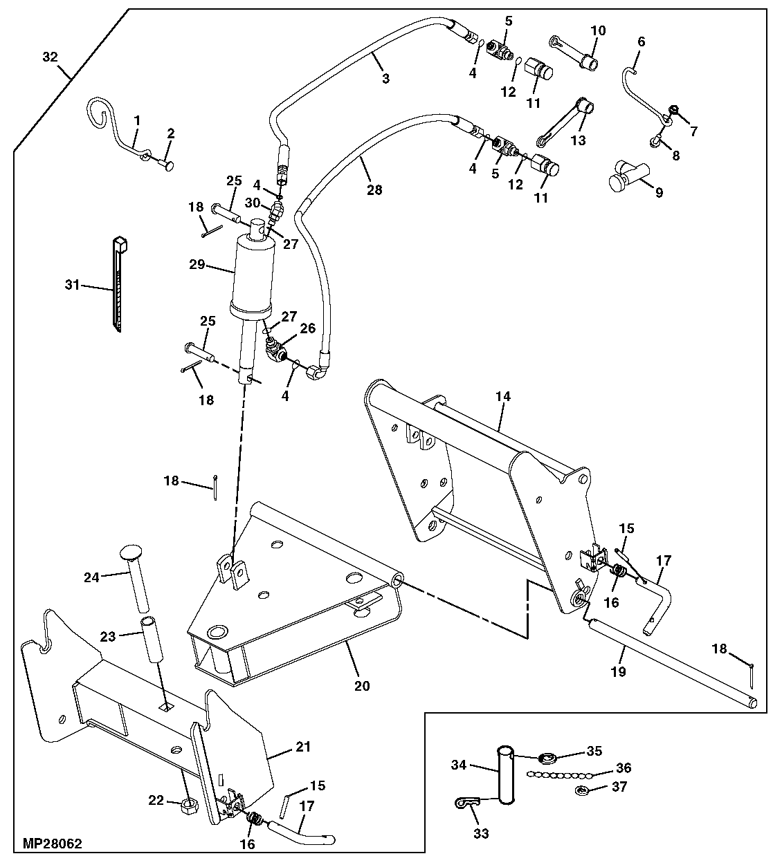

What Part Number is the Quick Hitch for a 2016 X-758 .
Going to use it on a 54 inch Blade .

Thanks the part number is what I am looking for .
Yes a front blade I bought a used blade and looking at a used Quick hitch .

Are you looking for a front hitch ? You said "front blade" The quick hitch you linked to is usually for a rear hitch. If it's for a front hitch, I'm surprised to learn about it.
/ Need a Part Number Please
#9
John Deere is saying I need a QUICK HITCH to use the front blade or snow blower ?
/ Need a Part Number Please #10
Front quick hitch is p/n BM26236 ... it is the current sub for BM19782
This kit includes a hydraulic cylinder to lift the blade/blower.
